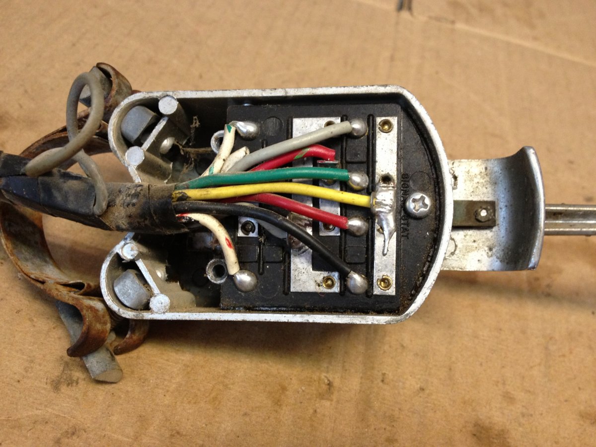

    I have a vintage SignalStat 900 turn signal I salvaged from a 1950 log truck. The first couple days after I finished soldering all the connections and sorting our the wiring I inherited with my 1951 almost original 6 volt truck (has an aftermaket wiring harness) signals worked, sorta. Had a fast blink that wasn't improved by grounding, I did have 4 way hazard flashers.
    My SignalStat has 11 wires, every online reference I've found mentions 7 wires. The image below shows 10 but an extra white wire is hiding in the bundle.
    When I finished wiring up the signals I had 4 unused white wires and a red.
    Also, I don't have a blue wire to act as a pilot and the indicator lights don't work on the flasher. The original wiring had a gray wire acting as pilot so that's what I used.
    Currently, the right side lights have quit flashing, they do come on front and rear when the signal is put in right flash position.....just no flash. Left side is flashing really fast, but is usable. Again, I've added temporary grounds from the battery to the light fixtures with no change.
    Looking forward to any and all comments.
    Ron

    Well, I may have a partial solution. The unconnected front park lights had already been changed out to twin pigtail lights and still have 1157 12v bulbs. When I hooked them up I was surprised at how bright they were, so hadn't bothered to change them out.
    I now think they could be the reason for the "fast blink" I've got. Ordered a couple 1154's from NAPA, we'll see.

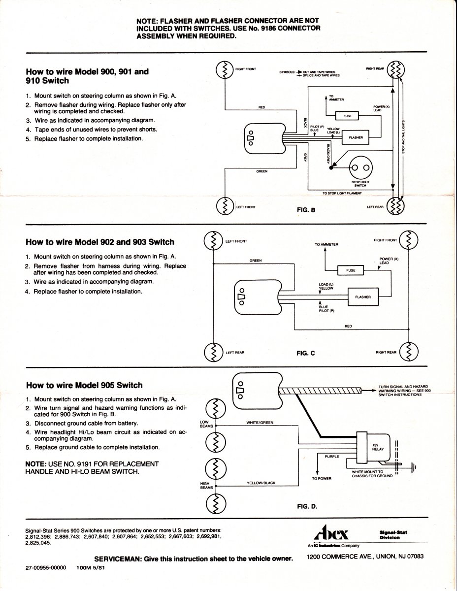

    OKAY. I can't tell from the picture but some switches in truck applications had the headlight dimmer switch built into the turn signal switch. Does the lever move up and down as well as L &R? That might be the extra wires. Also, some OE's used slightly different color codes. On the 7 wire models there are 3 inputs to the switch: + from the flasher, Pilot from flasher and + from the brake light switch.
  5. Hotrodmyk
    Joined: Jan 7, 2011
    Posts: 2,307
    Hotrodmyk
    1. Northwest HAMBers
    It took a while to dig it out but here is a wiring diagram from an older Sig-Stat switch. Hope it helps.

    Thanks Hotrodmyk for the diagrams! I'm almost ready to declare victory. I decided to tackle the pilot lite (signal indicator) not working issue today. When I took the front off the switch and removed the stalk with the lite bulb the 18ga. gray wire (blue wire in most applications) was broke from the base of the small light fixture.
    I disassembled the fixture and found a small brass button at the base of the light crimped to the broken stub of gray wire. Simple matter to open the crimp up with a small sharp awl and crimp it onto a 2" long section of gray wire, then reassemble the lever to the switch and attach the new wire to the old.
    Still no work. My slow brain recognized "it's gotta have ground", so out came the file and I knocked off a bit of original (good) paint from the steering column and WoooPheeee, got both a working indicator light for left and right and turn signals on both sides of truck. Still flashing fast but hoping the new 6 volt 1154 bulbs fix that tomorrow.

  14. Hotrodmyk
    Joined: Jan 7, 2011
    Posts: 2,307
    Hotrodmyk
    Your picture shows 7 wires which is correct for the 900. Are you sure some are not just cut short?
    See post 5 above, first diagram.
