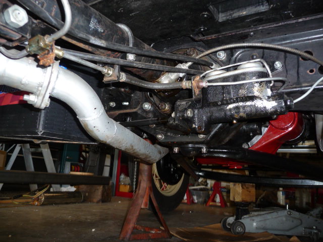

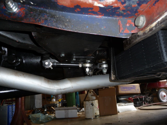

  26. Andy
    Joined: Nov 17, 2002
    Posts: 5,121
    Andy
    I made a cross mounted brake cylinder for my 32. I wanted to keep the battery where Henry put it but it was in the way of the cylinder. The bracket mounts using existing holes. Some are from the mechanical brake cross shaft and a couple are from the pedal mount.
    Richard Lacy has a better design but this was done long ago. I had the heim ends so it cost me nothing.
