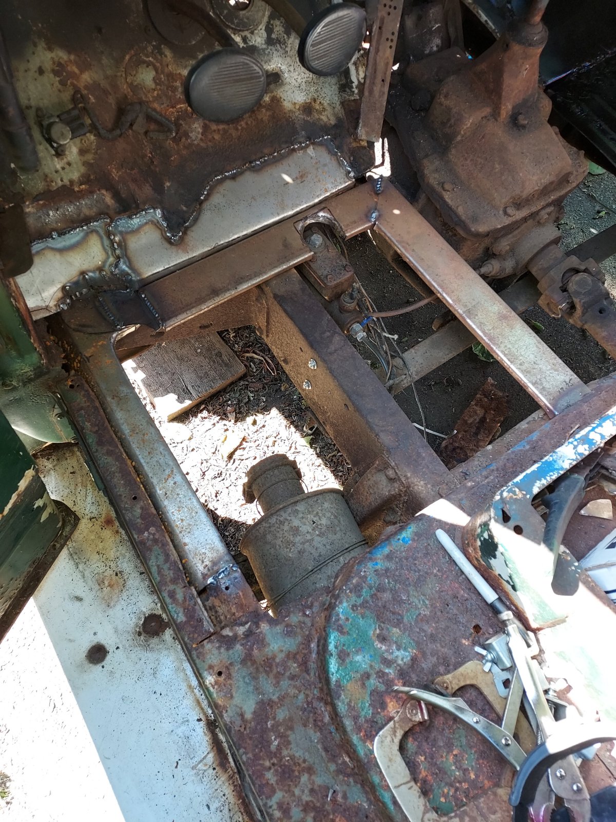

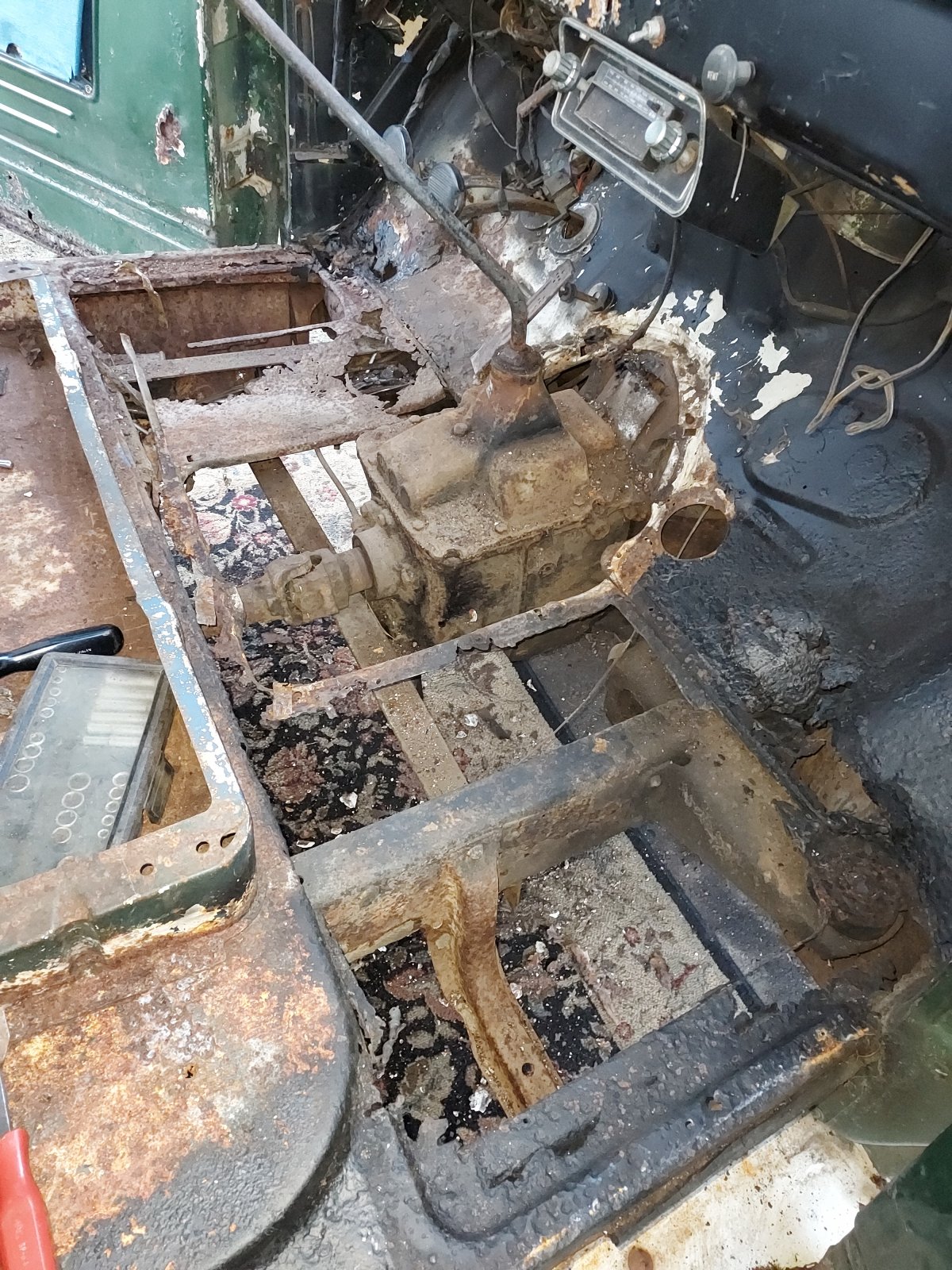

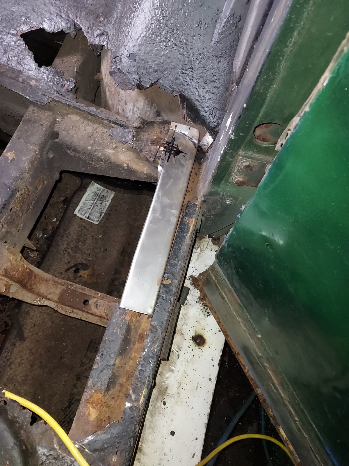

    I knew this was coming. . . . It needs floor supports and pans 20211217_155056.jpg 20211217_155122.jpg 20211217_164123.jpg 20211217_164134.jpg 20211217_164204.jpg 20211217_164827.jpg
    Oh yeah, toe boards too!
  7. wheeldog57
    Joined: Dec 6, 2013
    Posts: 3,182
    wheeldog57

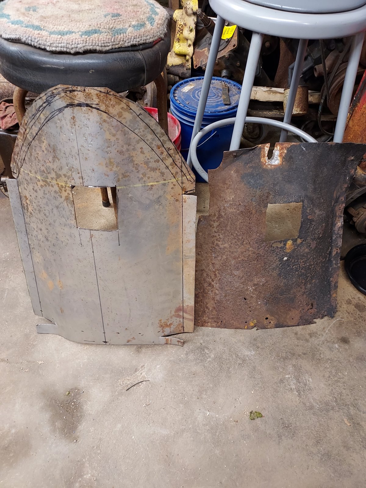

    I think I'll try to make a transmission tunnel, pretty sure I can do better than this one^^^

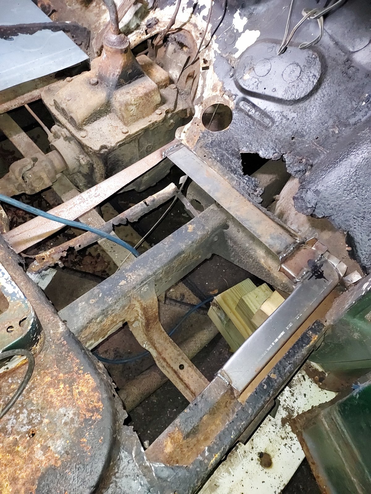

    Fabbed up the first of many sub floor pieces.
    Hoping to zip this side together tomorrow, I need to jack up the body a little because it has settled

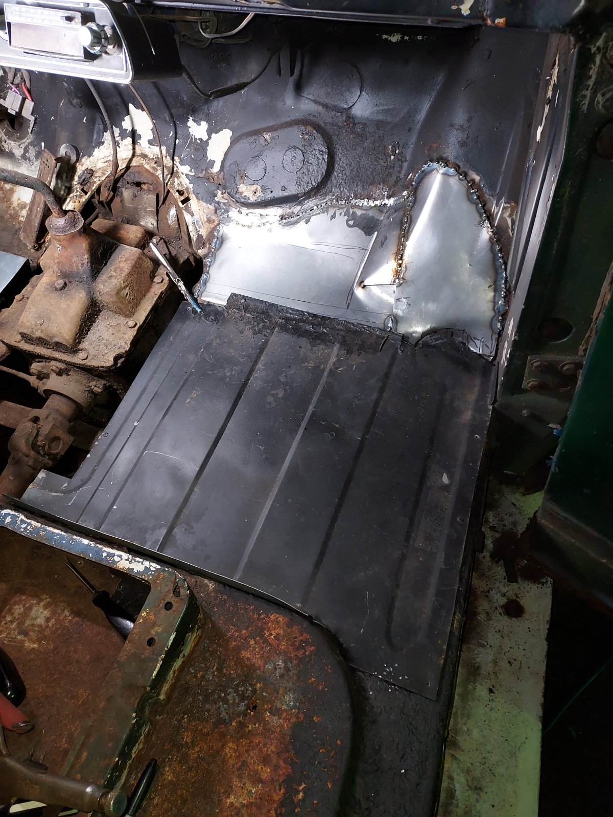

    Fabbed up a piece for the toe board, bent it to meet the floor support. I had to jack up the body about an inch to get it back to normal. Tomorrow hopefully I can weld this up and get the floor jack out.

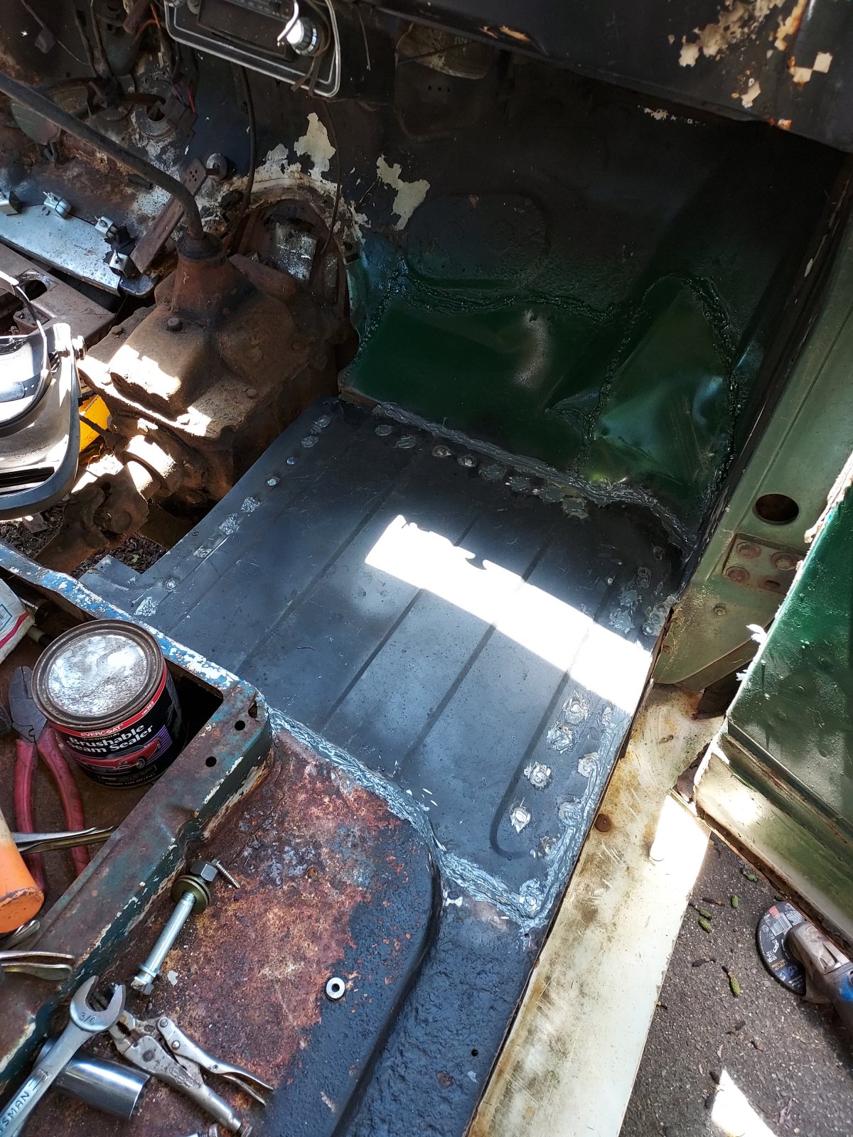

    Hard part done on this side. Toe board had a lot of shape to it. I need to finish the welding and grinding but I can live with this. 20211221_181934.jpg 20211221_182404.jpg

    Finally got some hours to slam the floor supports and pan in, lots of mig wire and seam sealer 20220625_141055.jpg 20220625_141100.jpg

    Finally got driver's side floor supports and pan in. Last week I got welders flash and that messed me up for Sunday and part of Monday. New welding hood delivered on Wednesday, I must say the new welding helmets with instant on technology and HUGE window are a game changer!!!
    Instantly I am a better welder!! Just don't tell the prima Donna real welders, they'll still shit on me!! 20220703_122536.jpg 20220703_122608.jpg 20220703_122948.jpg

    Not bad. As long as you get good penetration especially the structural parts you are good. Plug welds look ok. Slap some seam sealer down and call it good

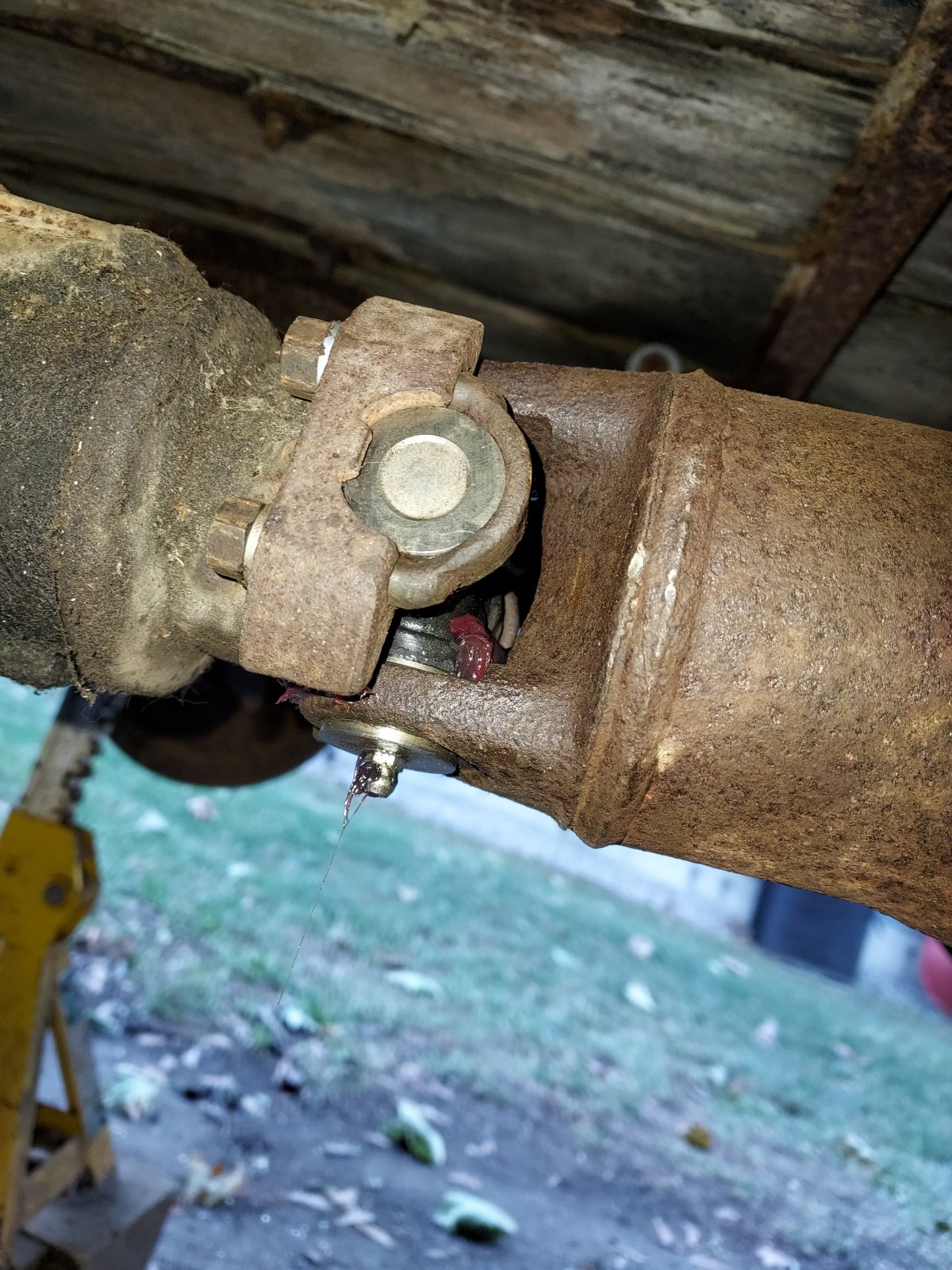

    I then needed to address the u-joint situation 20221120_112125.jpg 20221120_123524.jpg 20221120_123543.jpg
    3 of 4 sides of u-joint were mint. The 4th wouldn't budge, even with the air chisel, so the whole deal went for a ride to a pal's shop for a new set up.
