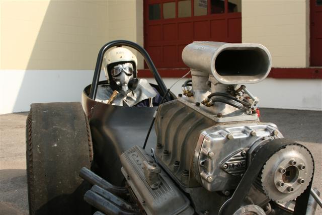

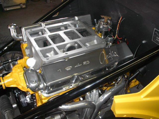

I dont have a close up shot of just the breather. But You can see it in the photo. I milled off part of the word Corvette just where the breather would mount.

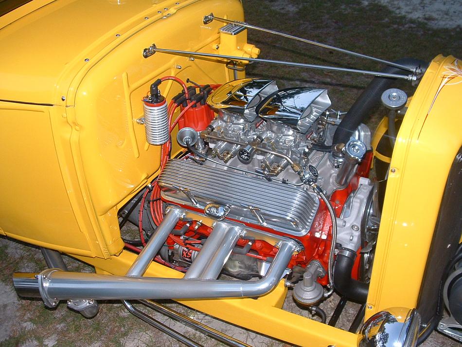

Had the same problem, (didn't want to cut covers).installed pcv in valley cover and ran a line from top of oil pan to a homemade can I mounted by radiator with a breather type cap. works for oil fill and air inlet to engine.

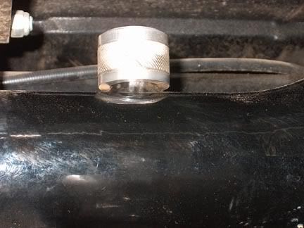

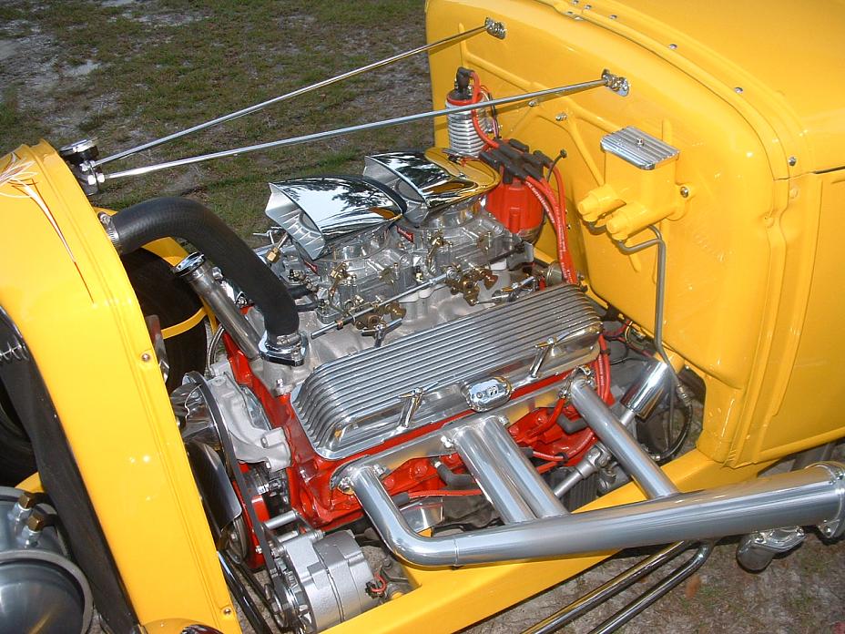

Here is mine. I took a Empi Breather for a Bug, and welded the holes on the sides shut. And drilled new ones on the front, so they were evenly spaced with the one that was already there. Then I milled the top of the bottom part flush, and I made a gasket to make it seal on the lid. Then I milled the Empi Logo off, drilled a couple of holes and mounted a small breather on top off that. I milled a couple of fins off the Vette Valvecovers ( a square of about 1.5" X 1.5" ) drilled holes and mounted the fittings that came with the Empi Breather ( all those fittings are not sealed with the O-rings that came with the Empi Breater, but with fiber washers that look a lot older...) And I welded a small piece of tubing to the filler tube. All hooked up with the Hoses out of the Empi Kit. Most people dont realise they are looking at a Aftermarket Volkswagen Part...

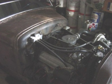

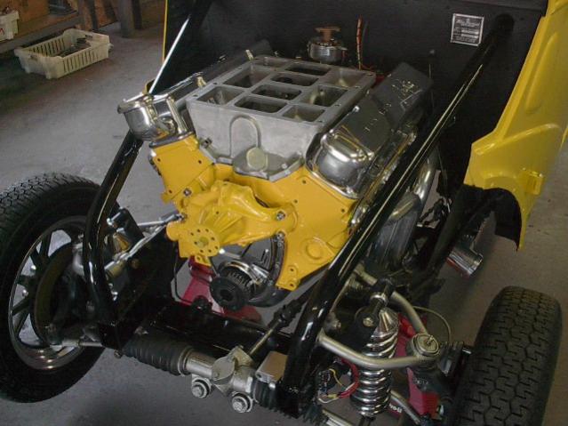

second from the left. offy breathers mounted on the inside. unfortunately a bolt hole cracked, and i havent swapped the breathers over to my cal customs covers.

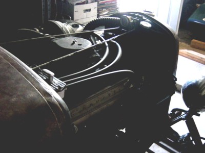

My stock 265 power pack in the 32 5W has the original draft tube instead of sucking fumes back in. No provision for oil fill due to the early staggered valve covers so I remove oil pressure pipe at rear of engine and fill slooowly.

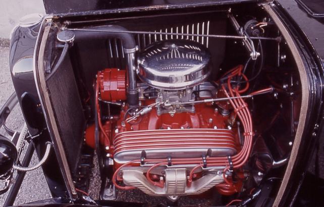

My buddy put moon breathers on the outside center of the vette covers. He then drilled a hole in the back center of the intake manifold, installed a valve cover grommet and put a pcv valve in the intake. It has a short hose from the pcv to the back of the carburetor. Looks pretty cool, and you don't even notice the pcv valve with the air filter on.
