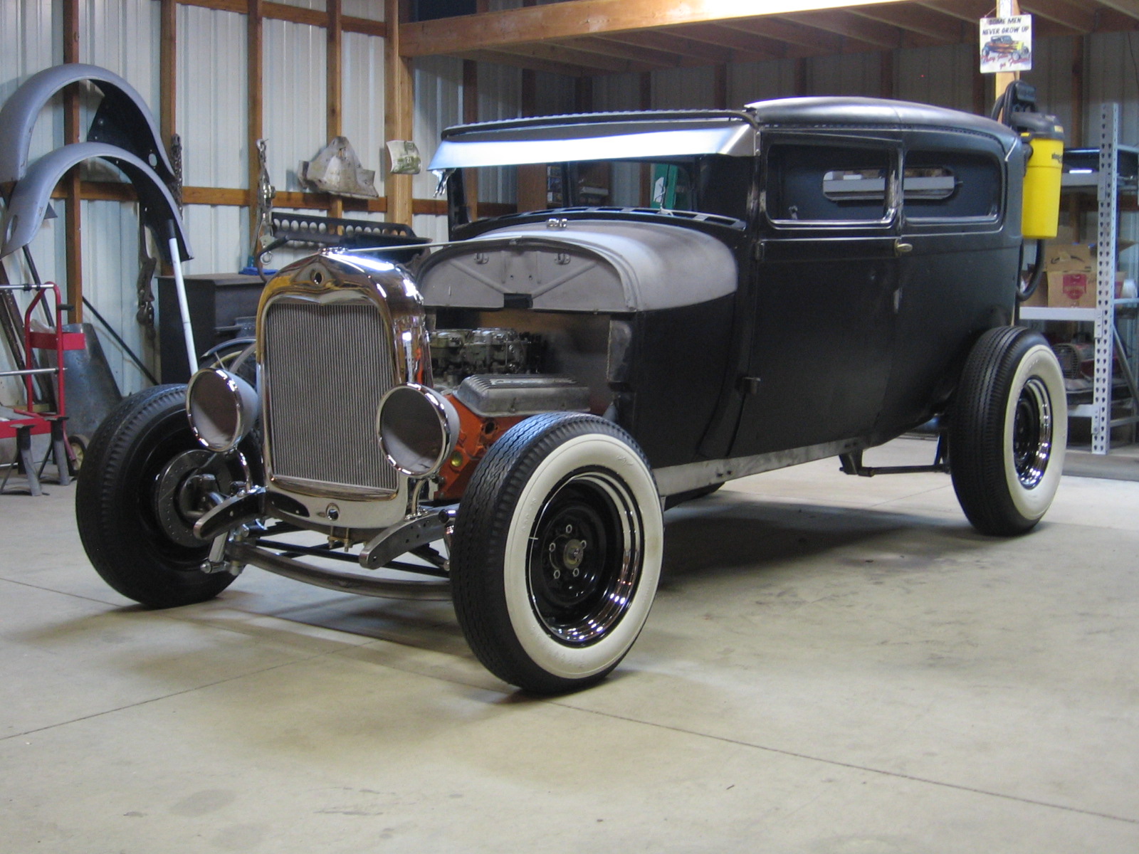

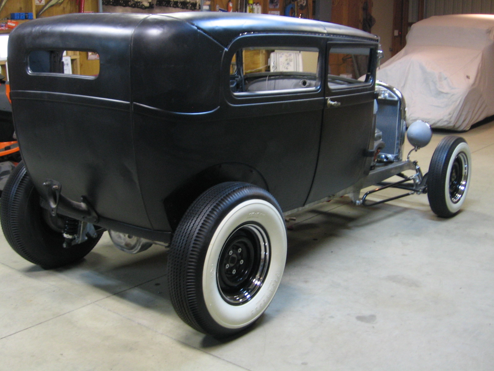

  17. modelamotorhead
    Joined: Dec 24, 2011
    Posts: 487
    modelamotorhead
    Here's what 6" out of the lid looks like on my '28. You have your work "cut" out for you, I'm subscribing. 094 (3).JPG 095 (2).JPG

  18. ShovelJockey
    Joined: Sep 23, 2011
    Posts: 46
    ShovelJockey
    That is exactly the chop I am after. That is a beautiful rod!!!
