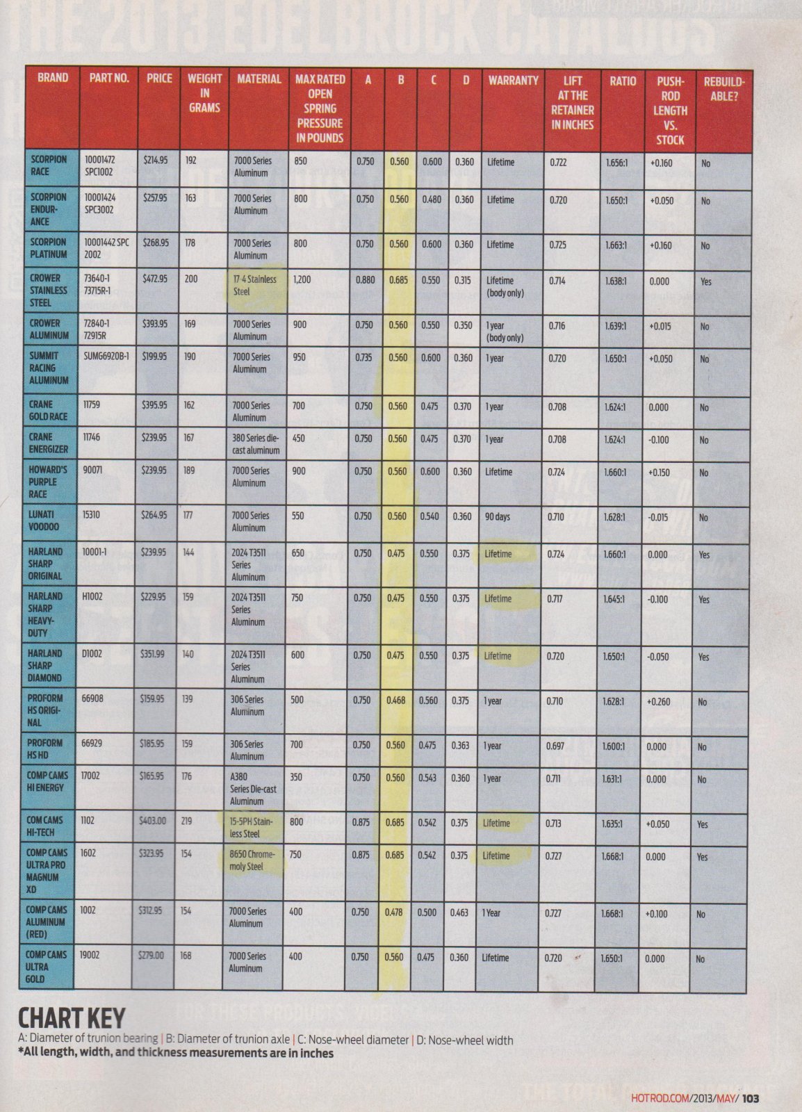

    Since there is surface rust on them, my concern would be the roller bearings inside. I'd soake them in diesel fuel for about a week then blow them off and disassemble them to check for pits on the rollers. If the rollers are not pitted, I would give them a try...........if you are replacing stamped rockers that are 1.5 as well.
    OR if they are not pitted, I would reassemble them and sell em on facebook.........then put that money toward some better ones.........1.6 if they will work with your springs.
    I've posted this before, but it won't hurt to do it again......
    Cat wasn't even tested, but you might compare them yourself.

    When adding aftermarket components to any engine there is an element of risk. People run cheap cast pistons a lot. From the charts I posted above you can see there is a wide variation in what material manufacturers use, and in the sizes of the components. GMs aluminum replacement for the venerable smallblock has roller rockers from the factory. They sell millions of these engines and they hold up well, but the rockers do fail when pushed too far. So now an industry has developed that sells upgrade kits for the stock rocker arms because the bearings could work their way free. I feel reasonably confident that when some of these failed, catastropic damage resulted in a few of them, but the vast majority just bought upgrade kits or aftermarket rocker arms to replace them.
    Since they are made with stainless steel rather than the cheepest grade aluminum, I have to suspect that they are not the lowest quality available and probably will work fine in a moderate engine. On the other hand, if I was building a new engine from scratch, then I would want 1.6/1.7 rockers instead of 1.5, and I'd sell them and buy new ones.
