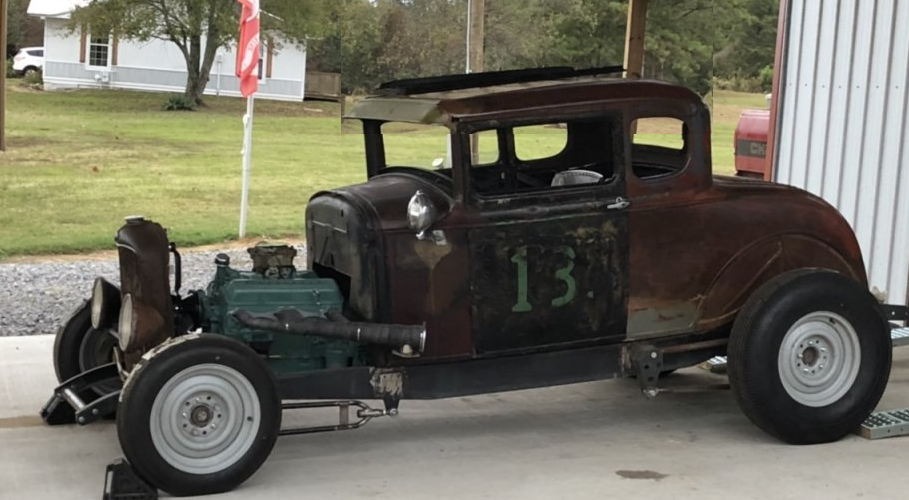

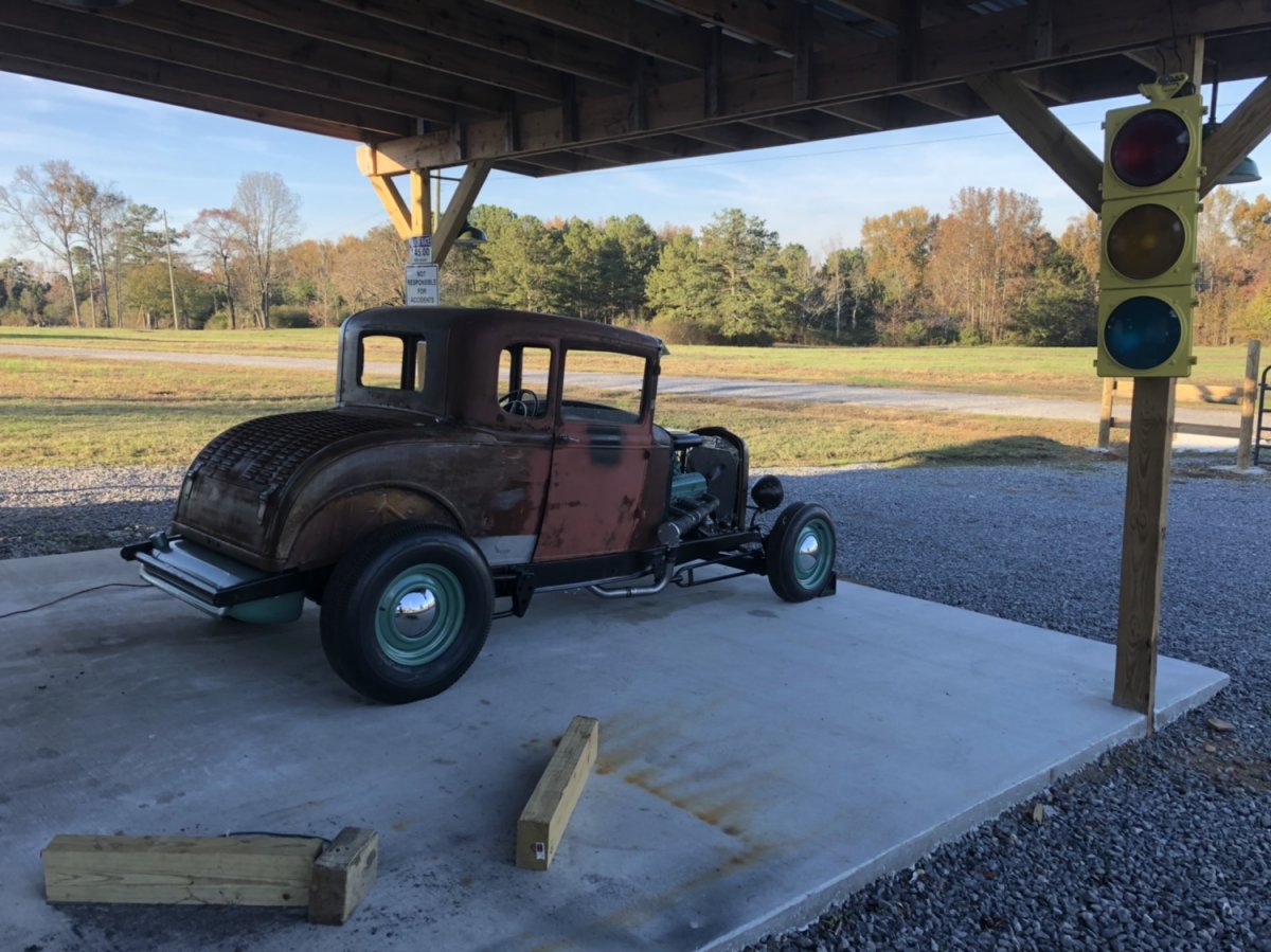

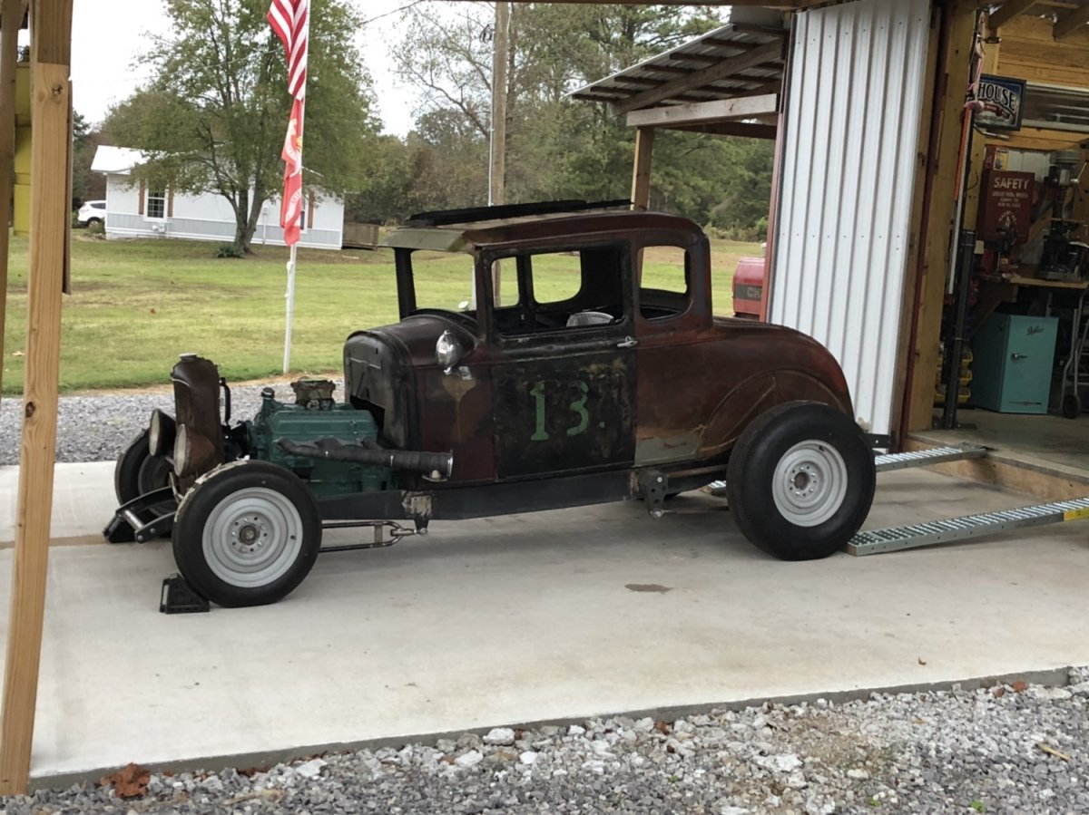

    I have been working on a 1930 Model A coupe. It started life as a sport coupe. The question is chop it or leave it be. IMG_1168.JPG IMG_1323.JPG IMG_1415.JPG IMG_1462.JPG IMG_1463.JPG IMG_1467.JPG IMG_1474.JPG IMG_1439.JPG IMG_1431.JPG IMG_1433.JPG IMG_1447.JPG IMG_1450.JPG IMG_1482.JPG IMG_1475.JPG IMG_1481.JPG IMG_1469.JPG IMG_1468.JPG

    Joined: Nov 13, 2005
    Posts: 3,837
    nochop
    from norcal
    Chop

    2-1/2 to 3" chop......

    I have been driving my avatar for more than 20 yrs and its small inside. Its hard to see traffic lights. My head has hit the roof on bad bumps. In other words,dont chop. If you do, a 2" chop would look good and wouldnt make it much smaller.

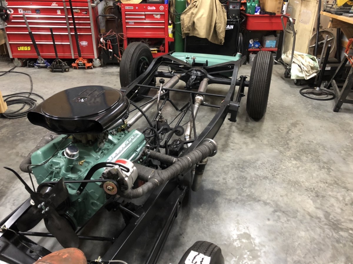

    Your car, your call. Not original now. Also could I suggest some lonnger boxing plates to spread the load where you K-member is attached to frame rails. That flat bar is the weakest link in the chain as the torsional load needs to be spread over a larger area. I can see those tabs cracking and eventually tearing away from the top and bottom frame rails.

    Only you know if you have room to sit in it comfortably with a chop. That said, I like the looks of it as is, or with a haircut.
    I'm 5'8"...2 inches would be fine for me. You might be 6'2", I don't know.

    Stare at this pic awhile. IMG_1415.JPG It just screams hot rod and in the traditional sense. Build it , drive it and enjoy. You can always alter later.:cool:

    Thank you for the input, I have already corrected week ago before the body went back on the frame.

    I thinks it screams HOT ROD they way it is... NICE build you got going the way it sits now.
    But if you want to look like almost ALL the other coupes, Chop it

    To really see how it would look chopped you must put the hood on. Otherwise, you eyes
    focus mainly on only the top giving a false impression.

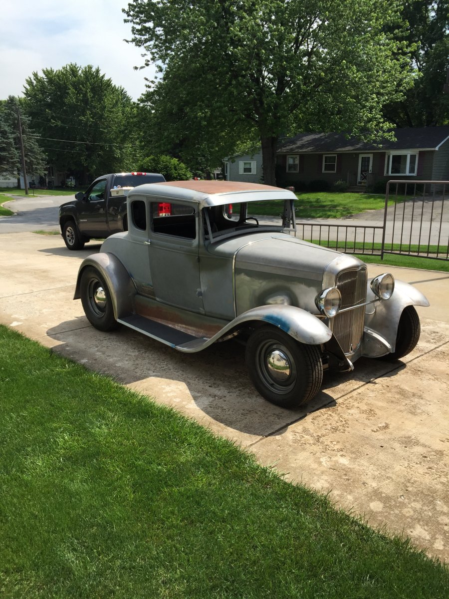

    Here’s my 2” chop
