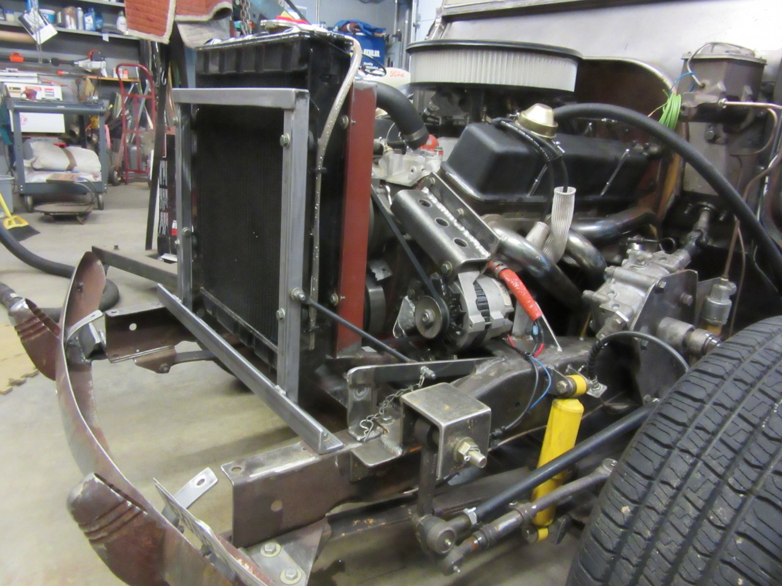

  18. Sam Stephens
    Joined: Apr 29, 2017
    Posts: 1
    Sam Stephens
    IMG_20180130_125404396.jpg Small block Chevy with block hugger headers ,works well.
    pat59 likes this.
