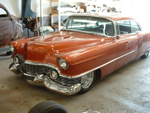

    I fell in love with a new car this week. Customer built this 54 Caddy last year, and decided his skirts were a little too short.... brought it to me for the remedy.
    Owner built car, bought it in Temecula (spelling ?) California. Really is a nice ride, and I have simply fell in love with it while its been here, gotta get me one.... put it on the list.
    Any way here are the pics....

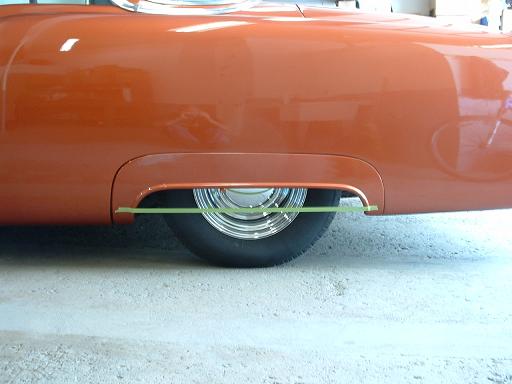

    Tape line represents where I wanna be...

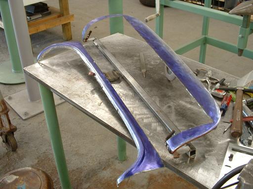

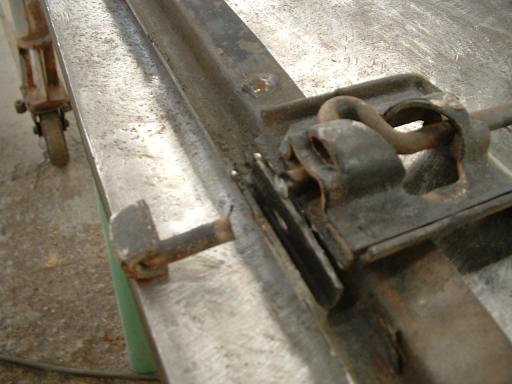

    Stripped paint and undercoating off... what a chore. Blued, braced and laid out, ready to cut.

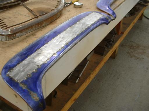

    vendettaautofab
    Added 3 1/2"....wrapping bead around took some time and massagging, should have taken more pics..also will have to cut lock assembly, move up, and length handles rod.

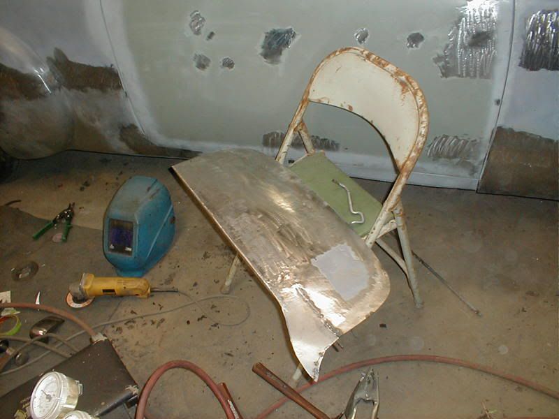

    Here they are tacked up, welded and roughed in.

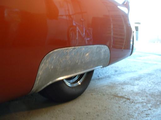

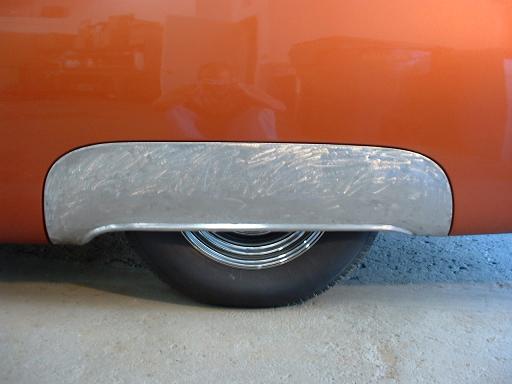

    Finished product, turned out decent, and accomplished what we were going for.
    I love this car, wish it was mine!
  10. vendettaautofab
    Joined: Jan 9, 2006
    Posts: 1,602
    vendettaautofab
    here you go... a side by side

    Gotta ask a question though... what did you use the bluing for?

    Easier to see scribed lines... markers are too fat. Better lines, better fit, better results I have found.
