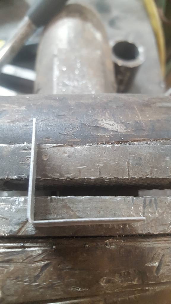

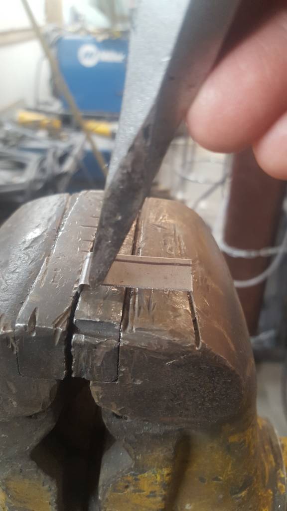

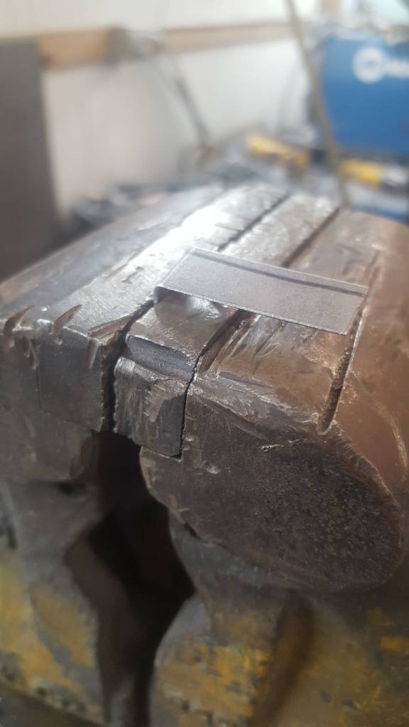

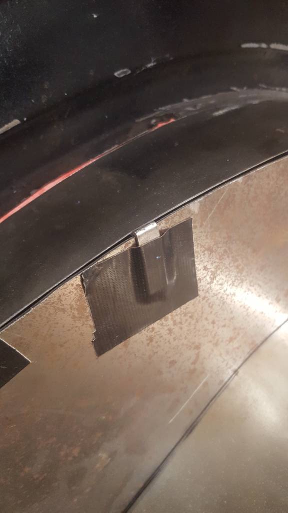

    Needed to hold a 90 degree butt joint in place and came up with this easy to make support. Worked for me, thought I would share it.
