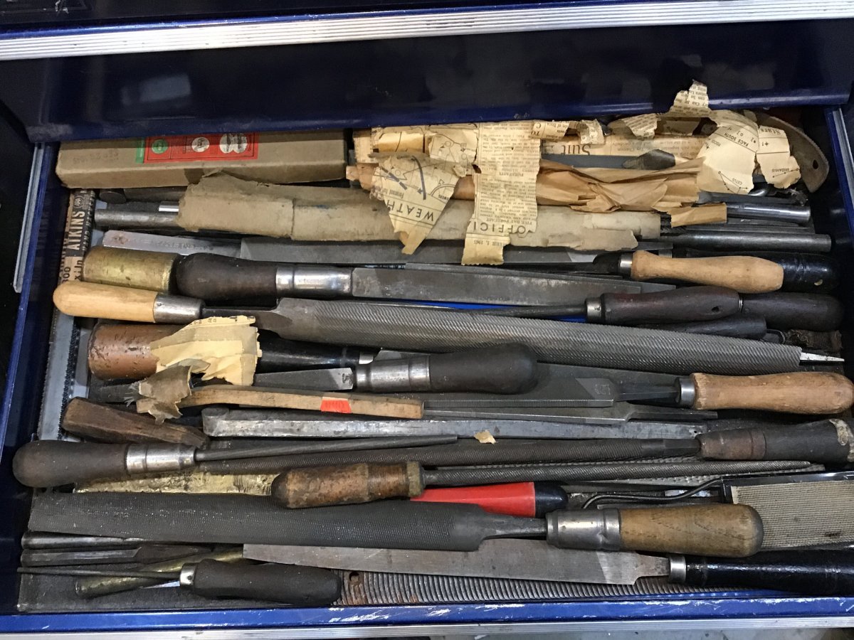

    Most all of the files in my shop are wild (no handles on them), and they all get thrown into one box on top of the workbench. Thanks a lot guys, now I'm gonna be self conscious about my inadequate files. At least I do have a file card to clean them with.

    John, just curious about how the files were protected from each other in the box?

    The files are individually wrapped in paper in the box as it comes from the factory.

    image.jpg The files are wrapped in heavy paper and had some wrapped in news paper as well
