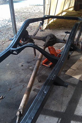

    Just wanted to hear from the people who have done it... Is it worth a damn, or should I not waste my time and cough up the loot for the fatman/jamco stuff. I am on a tight budget and wanted to get my front bagged while the frame is out from under the body. I searched all the other threads and know it's been beat to death, but you read some people say it works well like the tech article said, or other saying it sucks. So I wanted to see if anyone has it currently and how they like it? Thanks guys!

    Steering is heavier, but the fabricated spindles are exactly the same geometry, so they dont help that. the steering arms that are available are the key to getting reasonable steering effort. when you heat and bend the original arms you lose about 3/4" length, and this means you lose leverage ,hence the harder steering when parking. (its fine once you are rolling BTW). If you are reasonably confident you should attempt it. buying the fatman spindles would be money down the drain in my opinion.would you prefer a forged ford spindle, or a fabricated (welded) mild steel one?

    I am going to try it out and see what happens. Hell I like free alot better than almost $600.00. I don't mind the little bit of heavier steering as long as the handeling is still good. Thanks man!

    Yea I have them pulled out now, just took the pics before. I am going to take pics of the process from start to finish since no one else ever really has. The only thing I am going to do a little differently then the tech article said is I will use jamco upper a arm mounts kit (http://www.jamcosuspension.com/products/sfID1/73/sfID2/39/sfID3/77/productID/698) instead of enlarging the hole on top. Seems for $45.00 this will make it a little easier to align.
