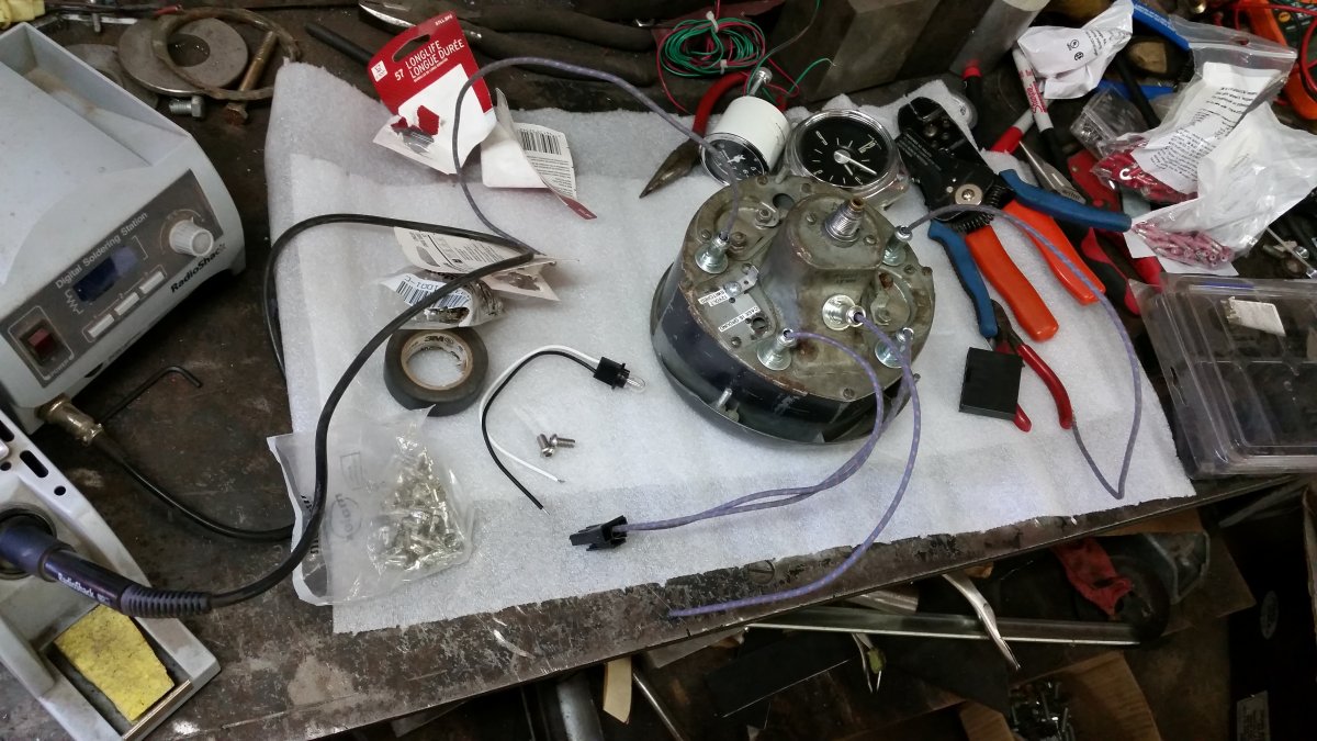

    I used one in an off topic car's dash that i built, but the cluster is all centered off of the speedo and the other gauges just piggy back off of its housing so thre isnt much chance to just remove the speedo. Theres 3studs that actually secure the housing and bezel into the dash, 2 on the side that are actually on the bezel and 1 stud at the top on the cluster housing.
    I thought i would have had some better pictures but you can sort of see the location of the studs 20150901_143208.jpg
