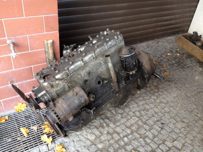

    As I started this project (about 3 years ago) I had a problem with fiding flathead drivetrain for it(its not easy to but such engine in Poland :)), so I bought another '49 ;) It was stored by the tree for almost 40 years but it had two gearboxes and 226 Ford flathead 007_010.jpg 007_014.jpg IMG_3212.JPG

    By the way- we tryed to start the Wolga motor. That Russian sh*t started!

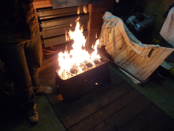

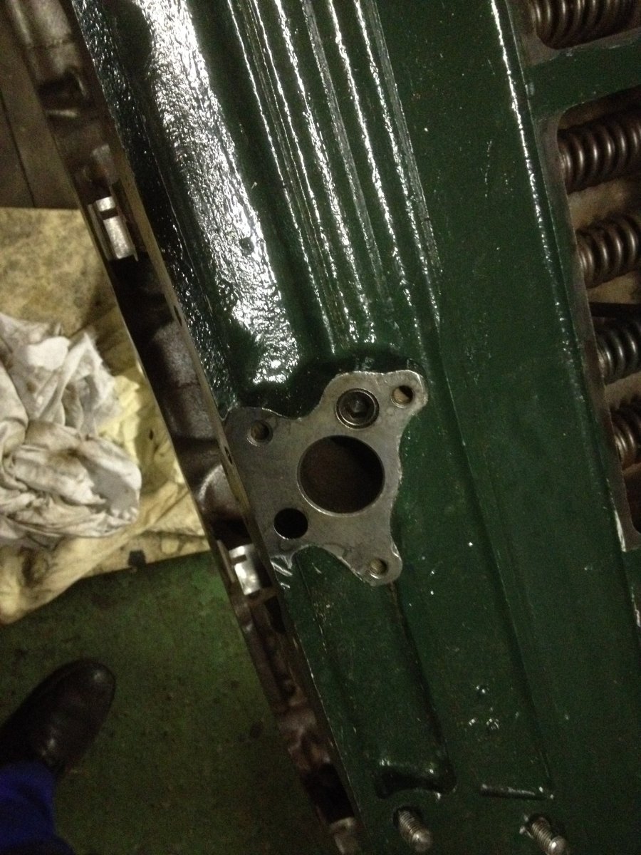

    Some time went by and I started to rebuild that Flathead engine. 001_001.jpg
    Engine was in such good condition that we managde to fire it up!
    But then I started to some serious bussines. I've cleaned it up, ordered some custom made rod and main bearings and started with some mods- full flow: IMG_4857.JPG
    and..
    ...porting-I learn on internet ;) and I've painted it (+5hp)

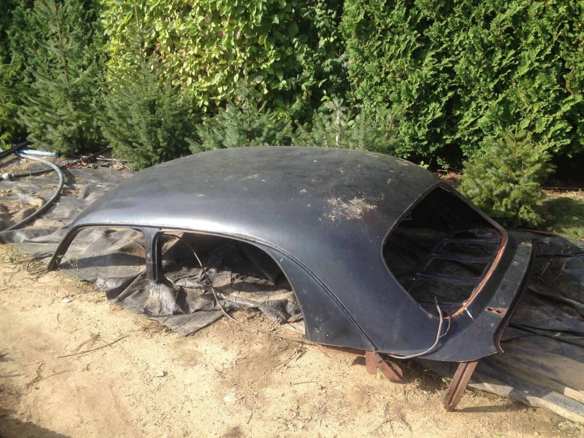

    Yup! The black one was hidden in barn for 30+ years and that rust one was like that for 40 years: 007_001.jpg
    two day earyler it had a roof of barn in which it was hidden. The barn collapsed ;)

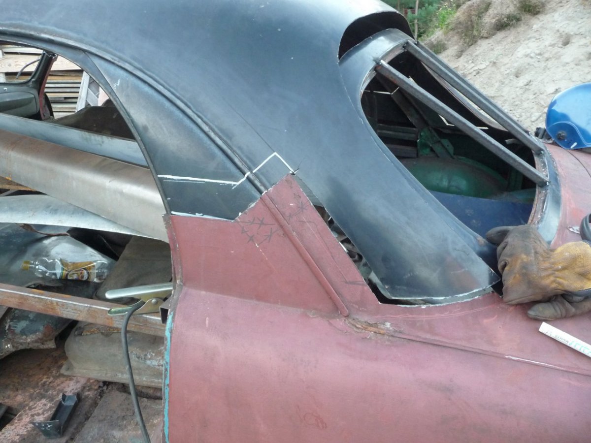

    Ok- the current status! I've almost finished the engine IMG_6674[1].JPG and started the top chop (and now you can see why I've called this thread like that): IMG_6755[1].JPG IMG_6754[1].JPG IMG_6764[1].JPG
    I've started with cutting the edge of the rear window (as You can see the rusty one has three pice window, bot don't worry- I have the original one from the black) and marked the way I'll cut the roof

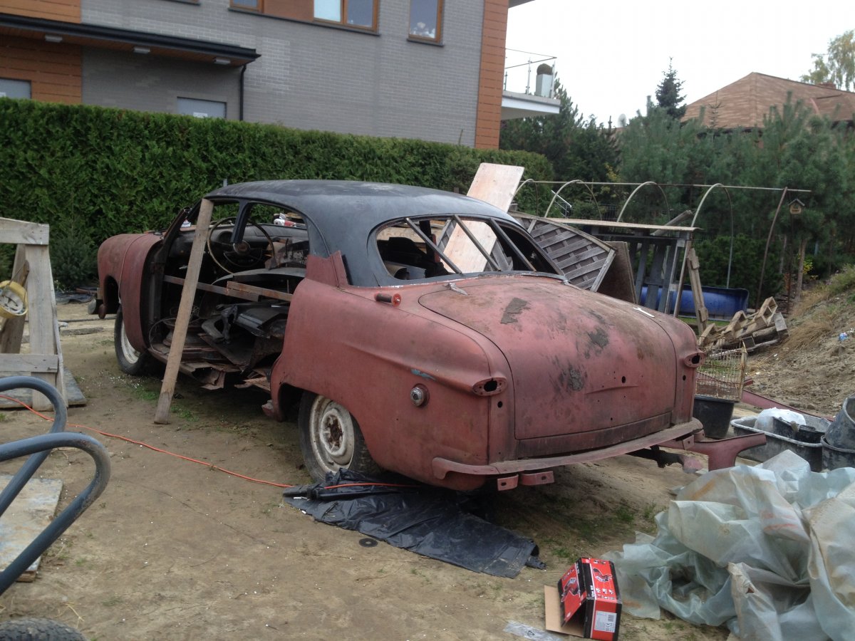

    And I started to cut it up. Rusty had his roof in not good shape (I've written about the barn roof on it earlyer) so it had to go! IMG_6768[2].JPG the black roof was waiting for it's turn IMG_6757[1].JPG when I took out the rear window from mr. brown I realized that it is in bad shape as well P1500076.JPG so I cutted it of and made same frame out of the black roof
    P1500081.JPG P1500092.JPG than I started to moke up the black roof P1500093.JPG P1500094.JPG

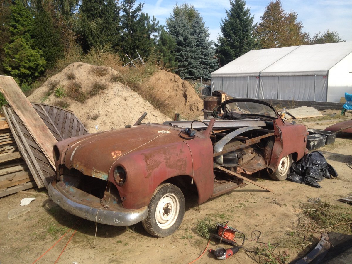

    And there was time to chop it of!! I know You'll like my style of work ;) IMG_6815[1].JPG IMG_6818[1].JPG IMG_6819[1].JPG

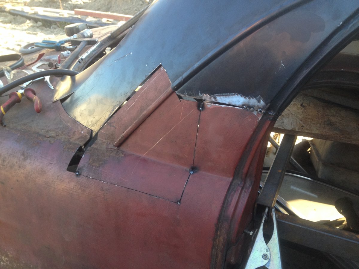

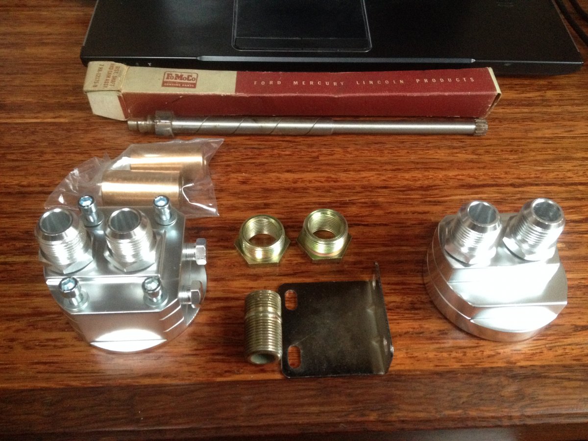

    Last saturday (that is on 10.31.2015) I've started to weld this monster together IMG_6830[1].JPG I had no idea how to put it together in nice way, but one sip of beer and all was clear! IMG_6831[1].JPG IMG_6833[1].JPG and the finishing touch- I know I'm a bad welder :) IMG_6836[2].JPG
