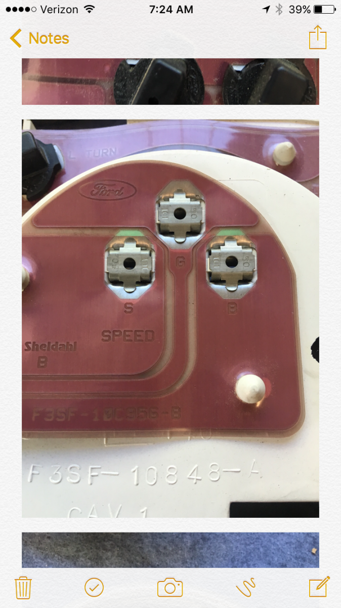

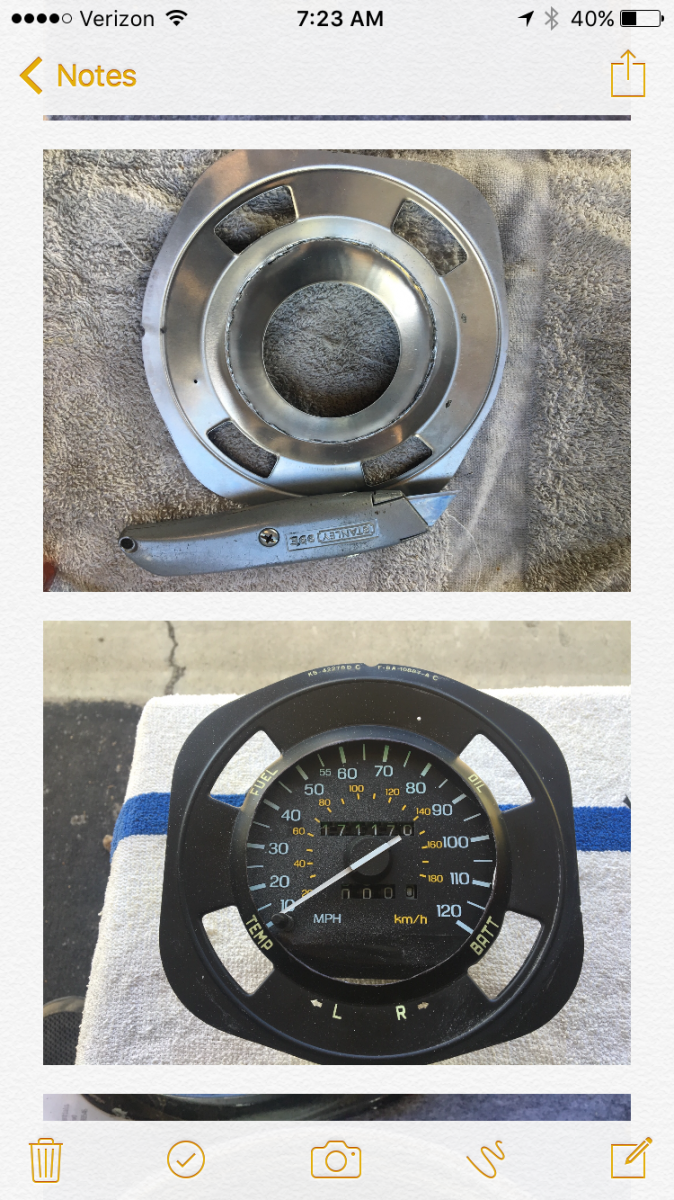

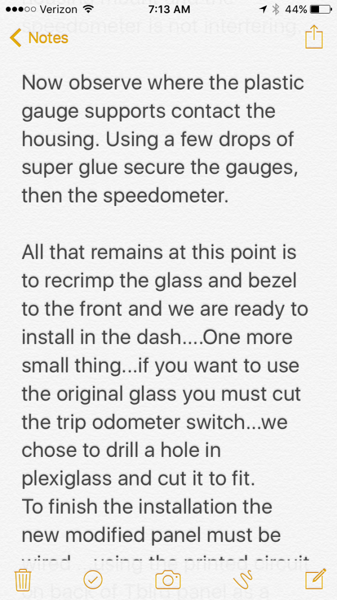

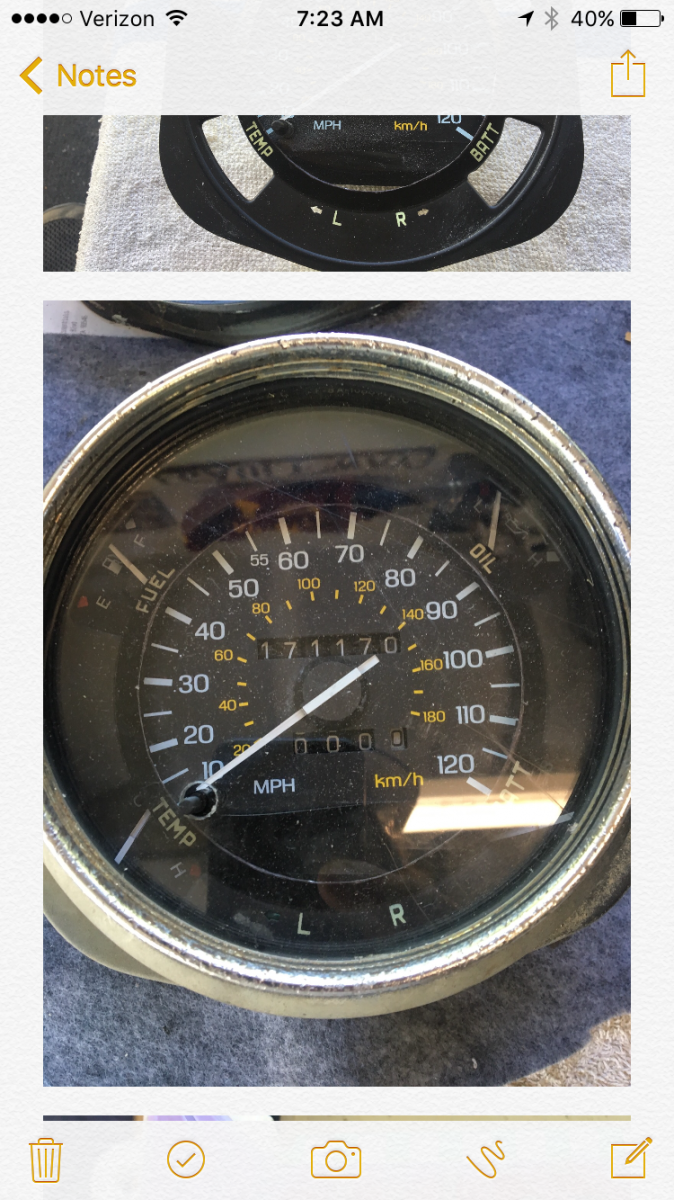

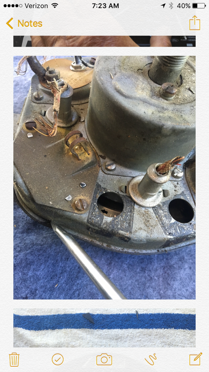

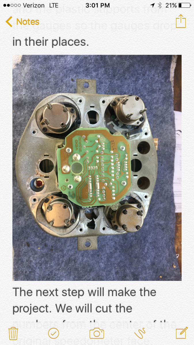

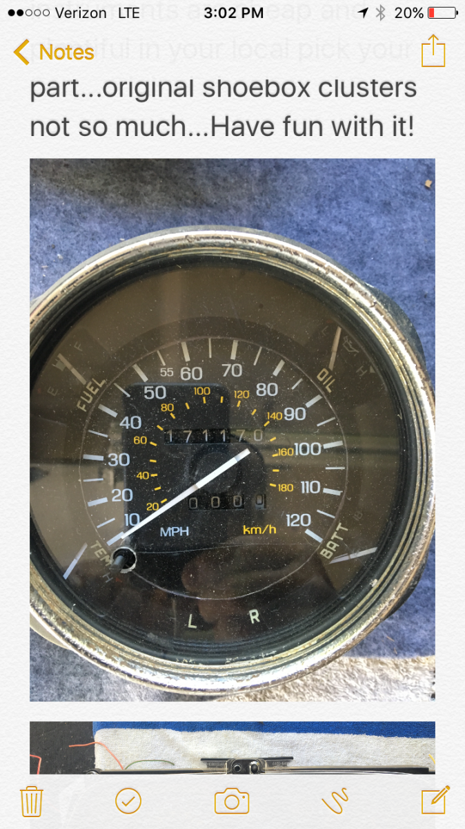

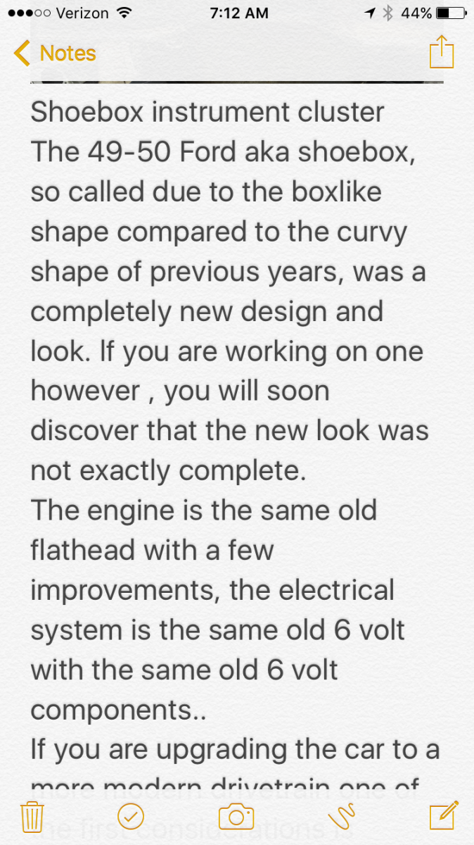

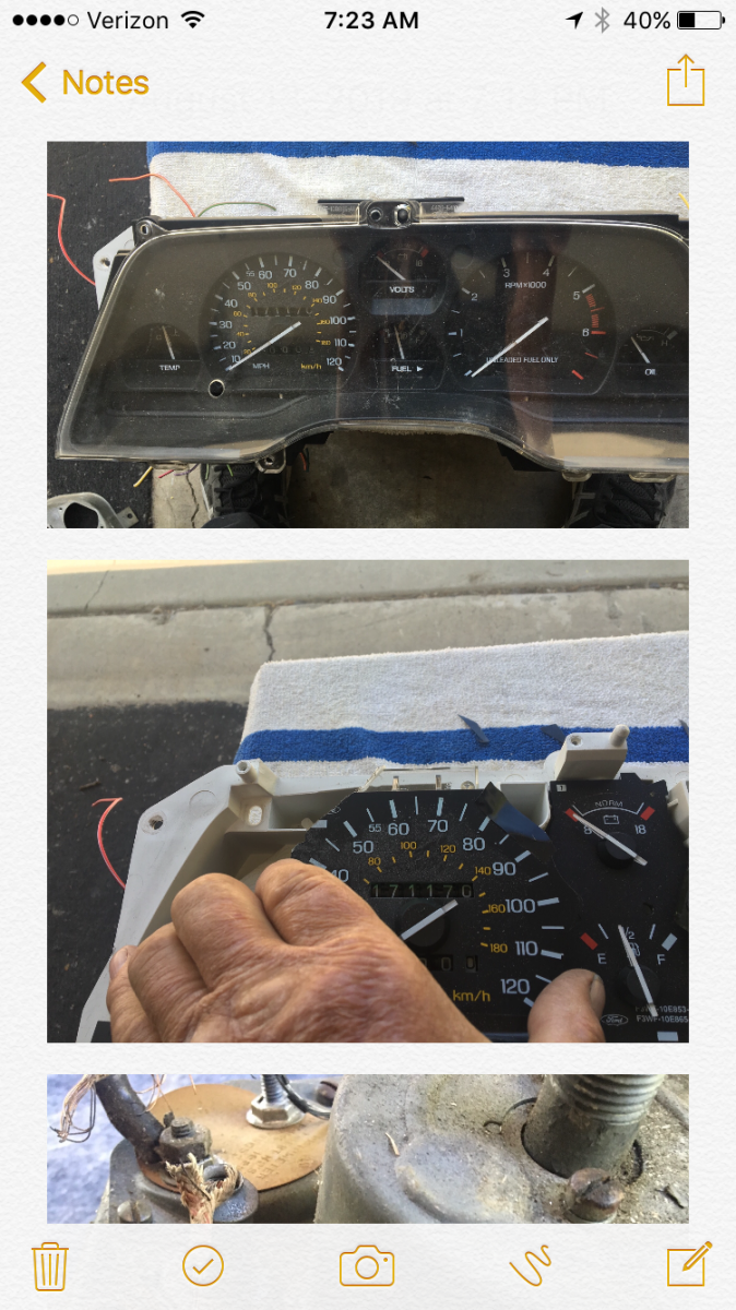

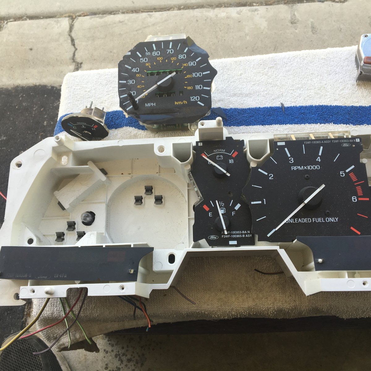

    The build of your vintage project involves many challenges not the least of which is the dashboard treatment... there are many choices ....OEM , aftermarket, etc..
    We decided to take a shot at retrofitting the Tbird instruments into the OEM housing...

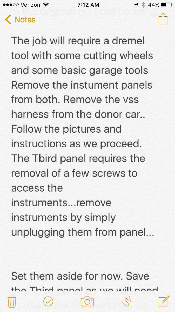

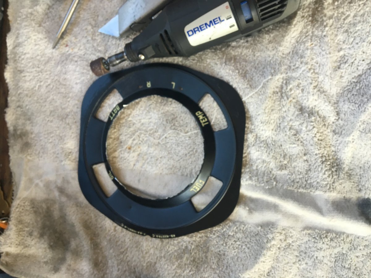

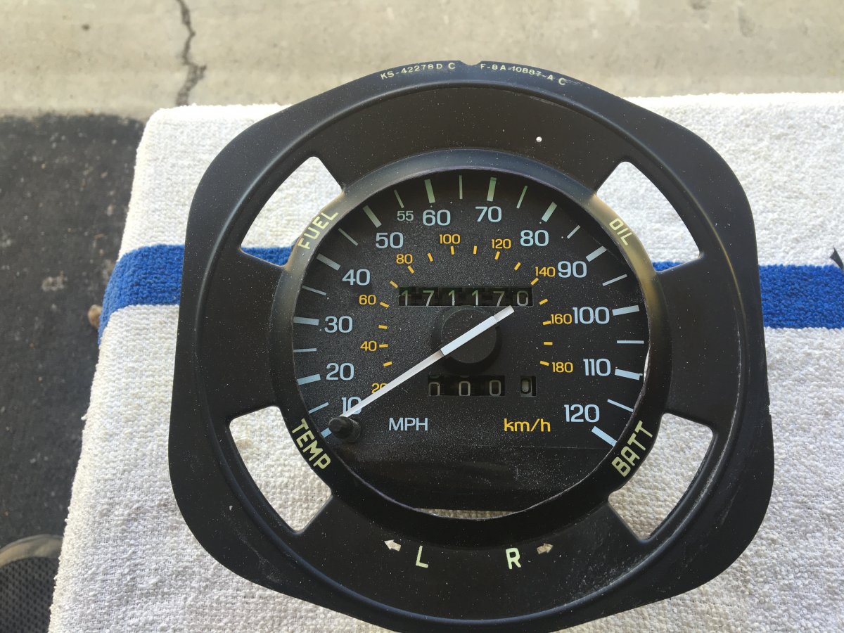

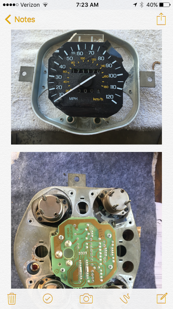

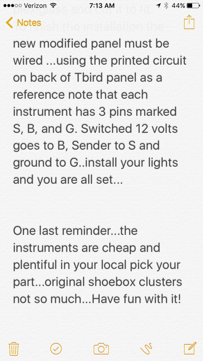

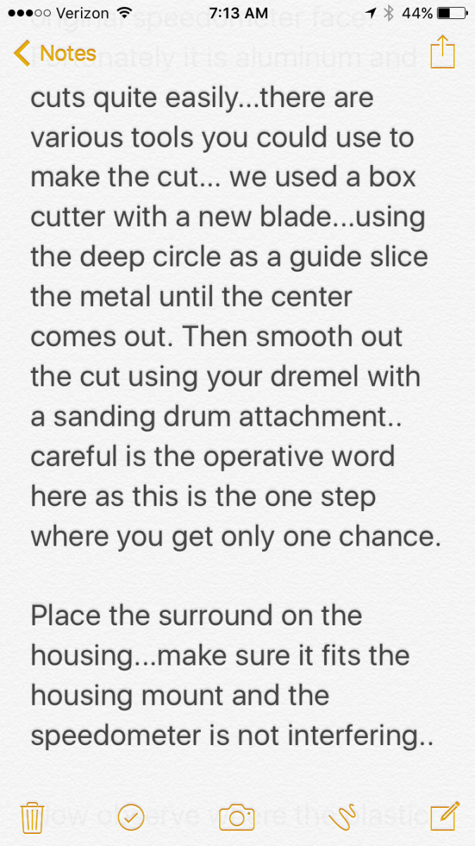

    Not sure how this works...l wrote a more detailed description of how to do this...if you send me your email I can send you it...l don't know how to post the article here...any coaching appreciated....
  7. Coachgault
    Joined: Nov 28, 2015
    Posts: 30
    Coachgault
    Here you go..

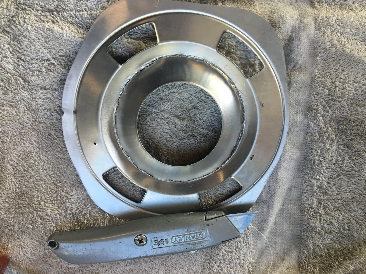

    The gauges are mounted in 1/8 inch sign material in the original housing. the speedo is an 85mm GPS model ( as the T5 trans I have has an electronic sender), the fuel and oil gauges are 2", and the indicator lights were purchased off Ebay.
