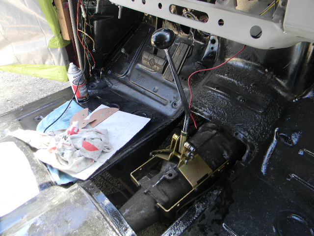

  8. Here is one of when I was putting the carpet in it.
  9. here are a couple during install, Which reminds me that I have been wanting to get a taller stick for it.

    Thanks for the photos! What's the length? Are you happy with it?
  11. Yea It works well, Very pleased with it. I think it was a 16" but I gotta go dig up my receipt and check. And when I do I think I'm gonna order the next size up. And put that in. Right now I gotta bend over a bit and I think if it was a little taller I won't have to.
