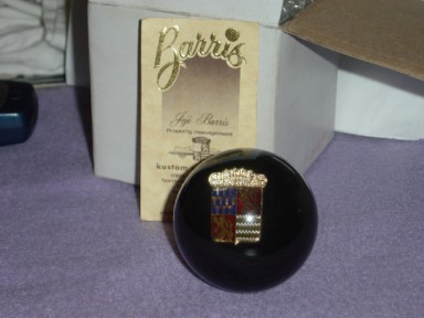

    Here is a shot of a RARE Barris shift knob that i have. It would look killer on a 49-51 Merc. or any Kustom for that matter. I will probably be listing it up for sale soon, if anybody's interested...PM me.
