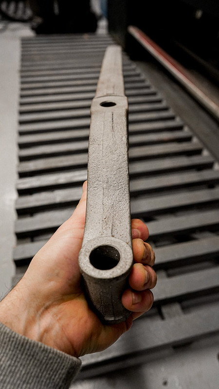

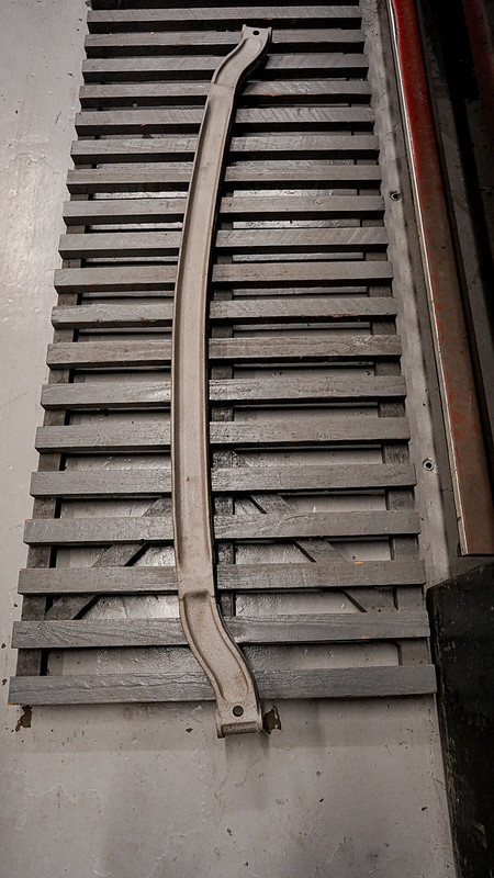

    Heres a selection of before shots of my axle, I had it blasted a while ago ready and already aborted this project. A little dust off, I was feeling pretty happy how much of a good example I had. With the long term vision of this going out front of a 32-A chassis for my coupe, I have no plans of what finish it will be. I just wanted to see if I could make it as nice as Harvs.
    [​IMG]3 by joe curtis, on Flickr
    [​IMG]5 by joe curtis, on Flickr
    [​IMG]6 by joe curtis, on Flickr
    I set out by attacking the main top and bottom faces, looking back I "de-peaked" pretty early in comparison to Harvs guidelines. Its not shown well in my phots but I took a bit of height off the ridge top and bottom to create a shallow peak, which in the end I rolled the top off for a nice low crown. How on Earth he keeps a high pea on there that well I beyond me. I went in with a 36grit sanding disk on a plastic backer on a grinder opposed to the flap wheel Harv suggests. Heres some shots of the bottom side where I had to go in and fill the most.

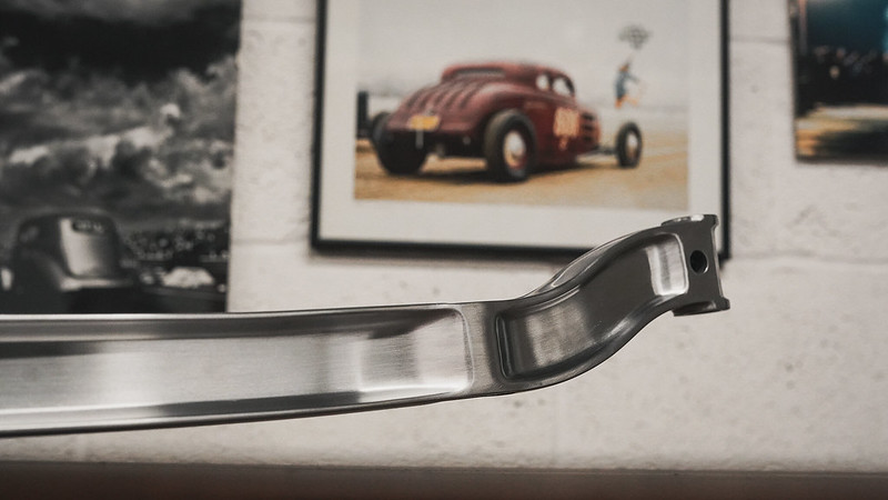

    Leaping forward a few steps onto the end details, the parts you will never really see at all but the bits I feel came out the fastest with less hassle. You may note the shape and finish refined a lot more on the axle in these photos. i thought by this point this was the last hurdle before a final blocking and papering. How ever the main centre section is currently still, kicking my ass.
    the before shot
    [​IMG]18 by joe curtis, on Flickr

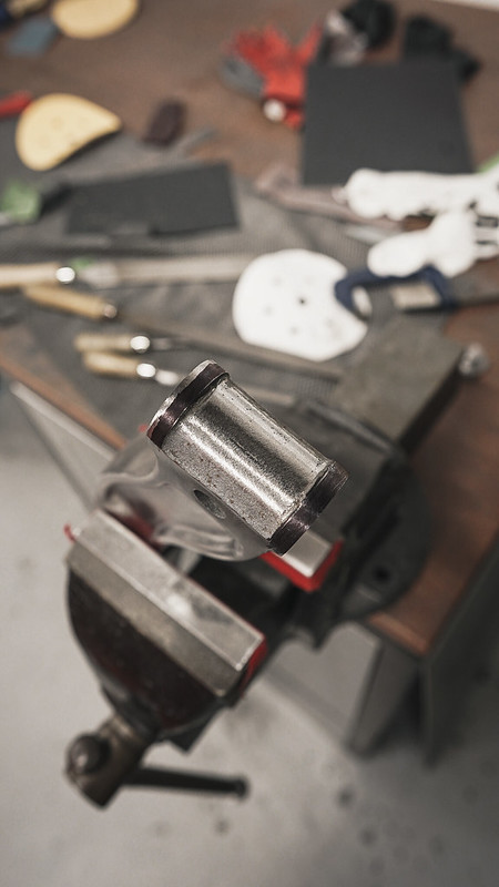

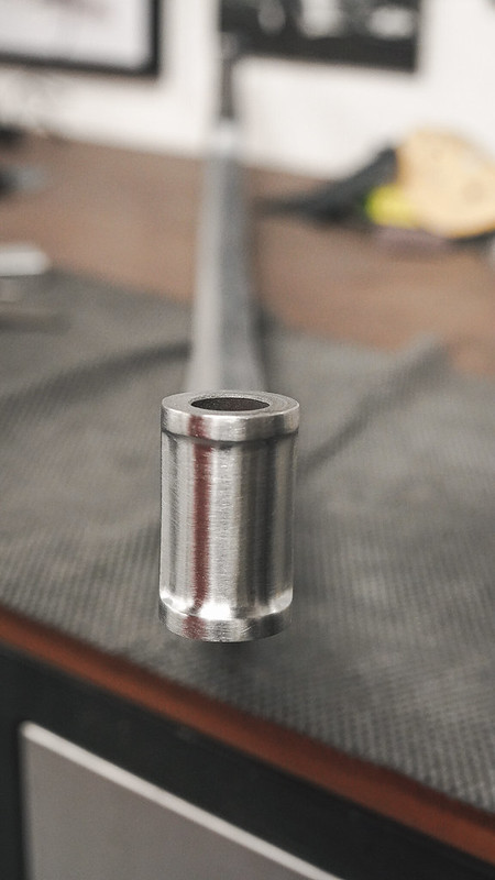

    I turned a simple top had boss to clamp into the axle to get the outside edge as round as I could. You can use these as a guide and file the shape in nice and safely. I didn't go fulll bore and try to make it perfectly round on the inner section due to the shape being "flattened off" on the front and back sections. This just gives the impression to the eye its nice and round, takes a lot of the guessing out of it.
    [​IMG]19 by joe curtis, on Flickr
    That centre rib, simple file that bugger off. With this being a small area I didn't want to hit it with power tools to rough incase I went too deep. Plus I love a good file up, nothing is as good as a file. You can see again colouring and marking scribes to try sharpen up the lines on the return edges.
    [​IMG]21 by joe curtis, on Flickr

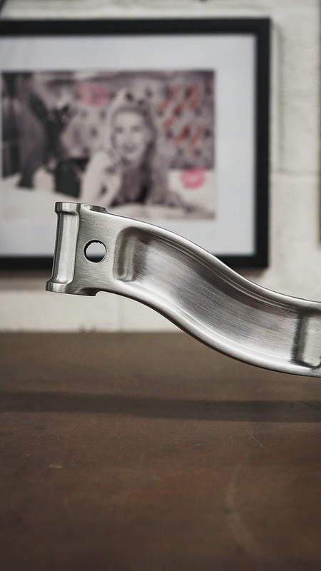

    Back onto the power tools, Bosch 12v battery "Dremel" with some small drum sander jobbies. One of those amazon deals "1000 piece kits" for £7.99 I had this from another job which I didn't use these on. Luckily I found 5 or so spindles so I mounted a load up and went into cutting the new shape into the ends, using the tip of the radius to form a uniform shape all the way around the perimeter of the recess.
    [​IMG]22 by joe curtis, on Flickr
    I flipped the axle onto its side, and ran it essential side to side, levelling the middle out to where I dug into the ends forming the radii. Then worked in half sides round and round on the other axis/motion with a 30x15 flap wheel on the air tool. crossing paths to smooth it back out, again using a worn down flap disc wedging it into the new form rads.
    Little file up to take edges off and get some smoother transitions, 150/240 paper and some red scotch these come up fairly easy.
    [​IMG]25 by joe curtis, on Flickr
    [​IMG]24 by joe curtis, on Flickr
    Now this is where im currently at, endless blocking and finger sanding. As I mentioned above the main centre is kicking my ass, I thought I was ready for the final stages, standing back and feeling chuffed with my achievements but im not quite there. I have a few high and low wobbles, they are fairly minor but I can seem to block them out with the energy levels I had at the end of day 3. I decided to tidy up and walk away before it beating me. Regain some positivity and head back at the tail end of next week once I have some more customers work done. With the currently situation of not having a day job to go to, it seems this is a nice distraction to pick up and crack on with, opposed to be being sick of the sight of.
    Anyway here's where im at on the ends
    [​IMG]23 by joe curtis, on Flickr

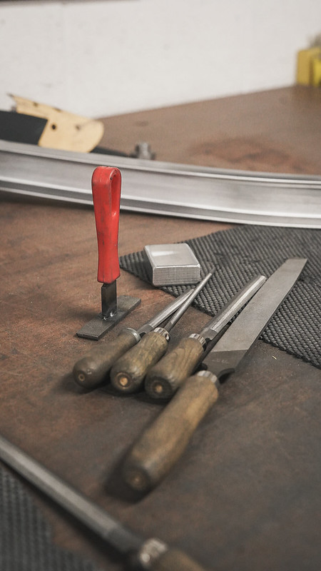

    A quick look over the tools I used, the most handy thing I found was cutting a crappy old file up, and welding the handle on top. Super handy for that joyful centre section blocking. Also gives your hand a rest from using a block and paper, until you slip off the paper and wedge your file into the job.
    [​IMG]26 by joe curtis, on Flickr
    [​IMG]IMG_5717 by joe curtis, on Flickr
    the table is a new version of the chassis workmate, the quick clamps in top come out- very handy for clamping axles in to clean up, how ever it is very low. Great thing to have about for odd jobs, folds up nice and flat too.
    Thats it for this week hopefully I can post some "finished" photos of this next week.

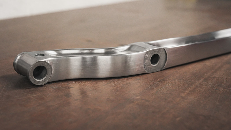

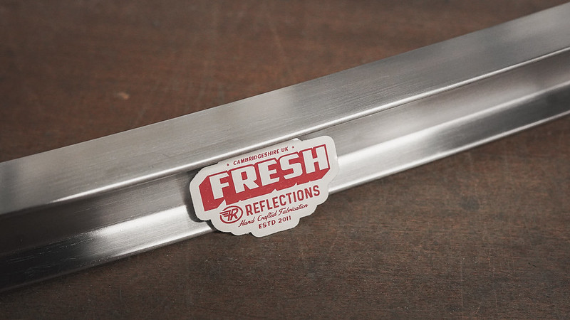

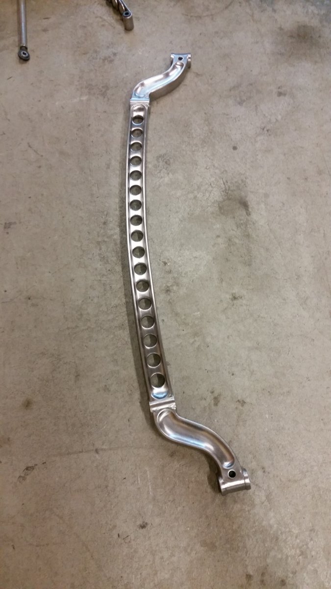

    Heap more photos from yesterday, I had to sacrifice my nice files to get the centre as flat as I could. I think I have wasted a lot of time going about this the way I have. I think I jumped to soon on refining the surface finish with out realising I hadn't got it as flat as I could be. Most of that maybe down to wanting to cut good files up.
    I spent another 7 hours on the one centre section, I still feel it could be better but its going to have to do for now getting me through phase one. The next step will see it getting handled a fair bit and no doubt re-sanded before it can retire up on the wall for a while.

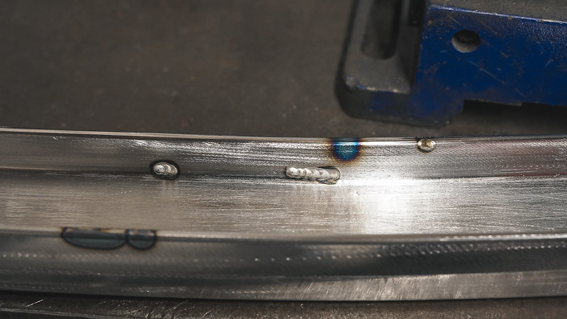

    Here you can see the low spots, I used the file on the side and laying flat
    [​IMG]1 by joe curtis, on Flickr
    [​IMG]16 by joe curtis, on Flickr
    finally fairly flat, I still had a small low at each end where I was only working unto one start/stop with the big battery whizzer, you can only see it when you look right down the centre of the beam. When you get the light right you can pick up the sections which I filled too, once its sanded these are harder to spot thankfully.
