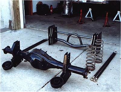

    Parallel
    dubie likes this.

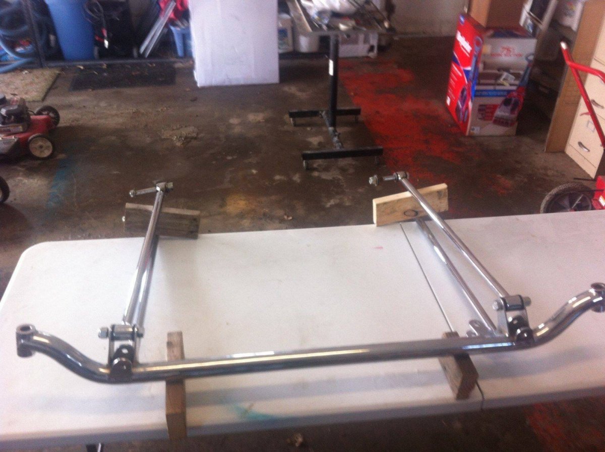

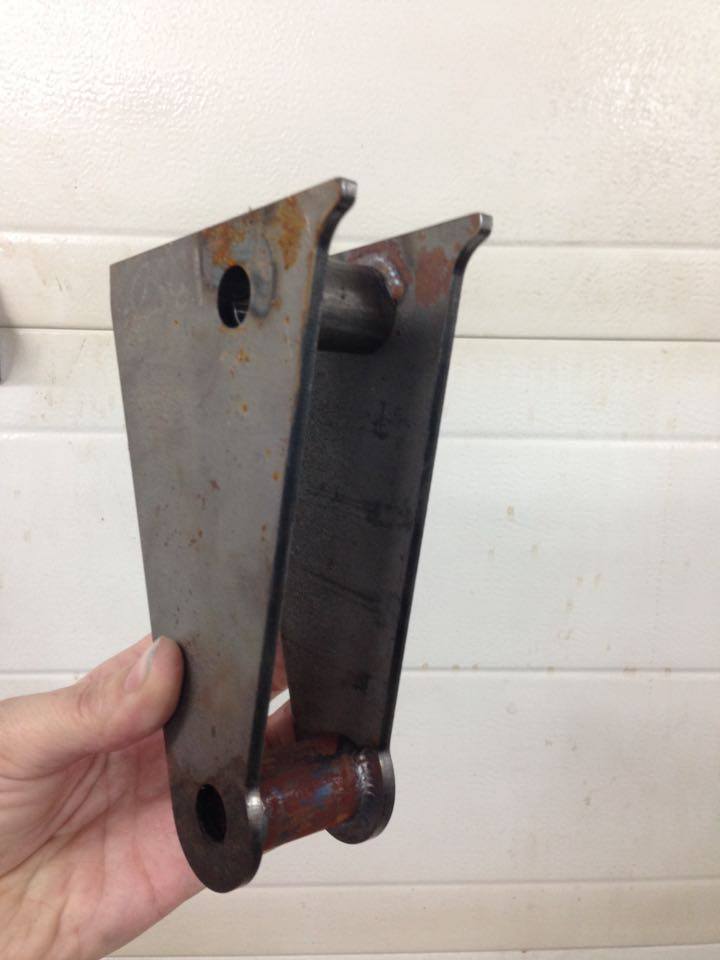

    I have the install instructions for the rear 4 link, it was purchased from Paul Hortons Welder Series. The rear axle is out of a Chevy S 10 pickup
    The front axle is a chrome tubular axle and 4 link that I bought of another car guy that ended up selling his project before installing it. He unfortunately didn't know the brand name. It came with all the bars and fasteners but no frame bracket so we made up bracket that will fit. It's always nice to know a boilermaker.
    We are building this car out of parts we are accumulating or had laying around from previous builds. It a 27 T roadster on a 30 Model A chassis axle1.jpg bracket.jpg axle1.jpg bracket.jpg

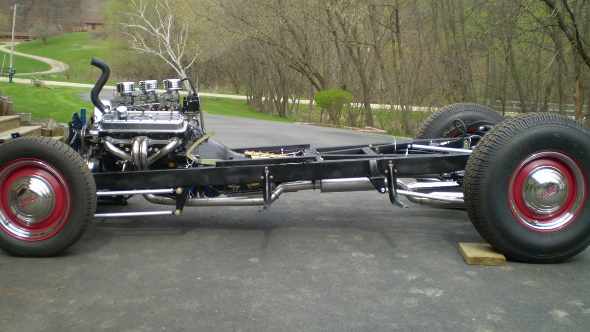

  10. Parallel to each other and as close to parallel to the ground worked very well for me. Try to get it parallel to the ground at ride height with the engine and trans in , it will look better , as you can see there is quite a difference loaded and not. The rear came down to very close to parallel with the body and gas tank on. I would also look into tri-angulated in the rear , it eliminated the need for a panhard in the rear , cleans it up a little back there. 000820.JPG 000530.JPG 001480.jpg 001500.jpg 001460.jpg 000820.JPG

    thanks for the pics man,that helps out a lot. How much clearance do you have out back from the rear axle to the frame rail? and what weight ratio did you use for coil overs? This is a really nice clean set up.
  12. The amount of room you actually need for clearance depends a lot on what type of springs you are using. Unless you are jumping one for example the average cross leaf setup travels 2" max. I have seen coil overs that would travel 3" but that is usually an indication that you are getting close to being too light with your springs. Desert racers want a lot of travel street vehicles not to much.
    Anyway I personally shoot fro 3-4" clearance and have set them as tight as 2" without problems except in extreme situations.
