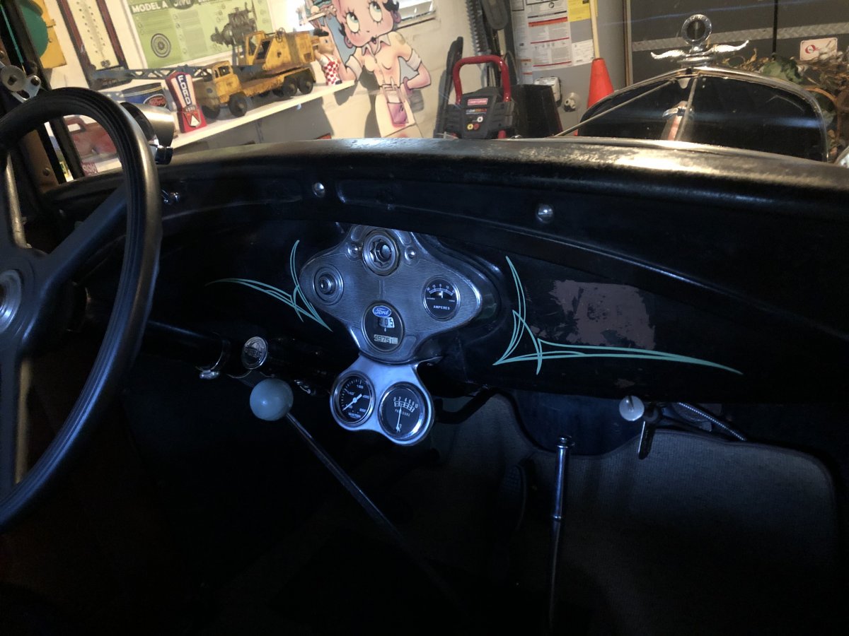

    Got some pinstripe work done by a friend.

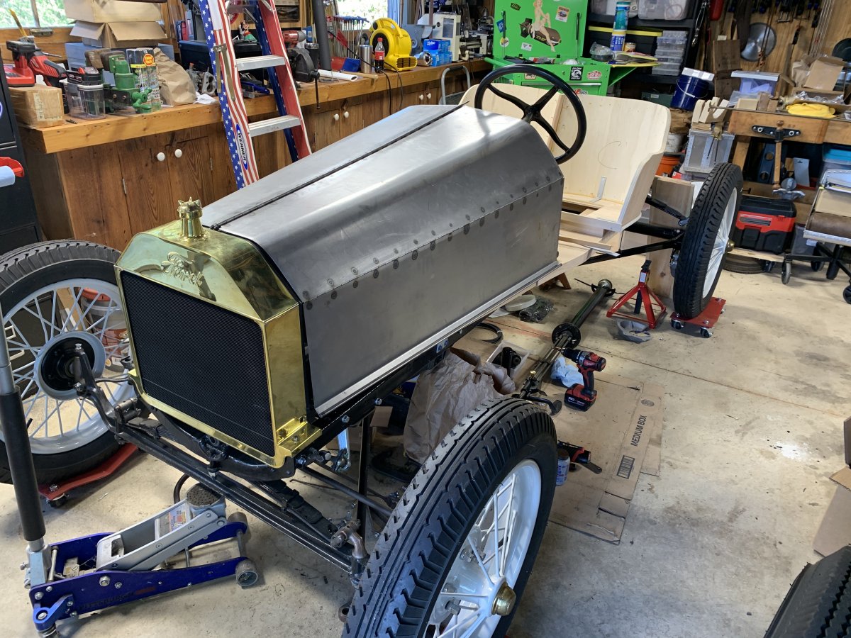

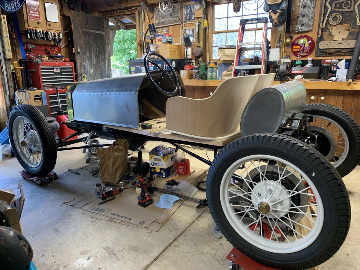

    I made it home with my hood and seat. I had to start mocking it up today
    F9995D1F-AD6F-4432-BE42-FFEF4B640EE8.jpeg 0429DE9E-021E-4394-A091-2A19DB38B8D2.jpeg

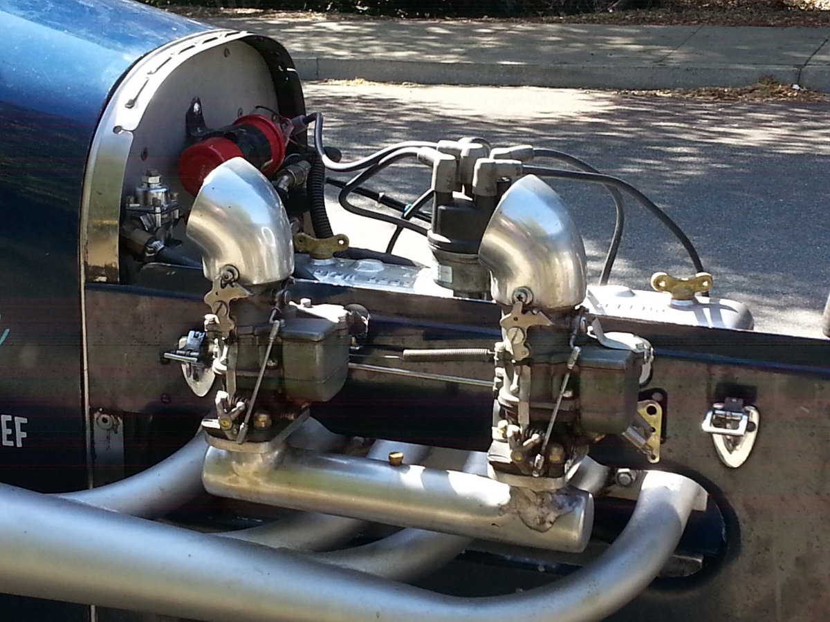

    no VE calcs or numbers, like I mentioned, Jobe's article is spot on for keeping the carby working correctly, which means having the proper vac signal to the ports to feed fuel at correct ratio. What I was doing was taking the restriction of the carb and minimizing it. This means much less signal to the ports to feed the fuel, sort of like making the motor an injected setup, no vac signal required. In short, the carb will not work on another street motor, it has too many extra holes in it.
    The 2up motor had some thin spots in the ports and after all kind of attempts at sealing, I just filled the ports with epoxy and bolted down an overhead assembly and removed the 2up crank. But here is what it looked like...............and you are right, it did not sound like a Model A anymore. J

    He whittles stuff like that in his sleep.
    (But he spends hours getting it ready to go.)

    So if I understand you correctly your pouring fuel at a metered rate,basically stuffing instead of allowing the engine to draw..sounds simple..till you try to make it work,imagine you slept at the flow bench.
