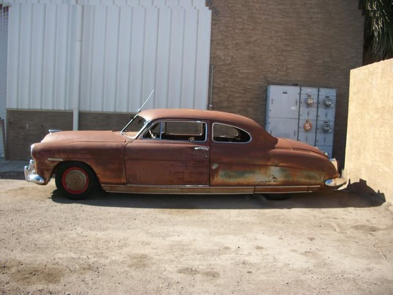

    i will be aquiring a 48 hudson coupe. any info on sectioning one of these.the car is kindof rough, so i figgered i would just dive right in and start cutting. i even thought about splitting down the middle into 2 halves and then painting the fabulous hudson hornet and no. on the sides as yard art. no i wont do that,but i would consider sectioning it, i.d like to see some examples.

  5. I´d maybe try to do a taper section, to get the top of the body to run parallel to that swage line along the side.

  19. It´s not sectioned at all at the front - I just cut it above the swage line and tipped it back until the body matched that line on the side of the car. So although it was below the keyhole, knowing that may not be any help in reality.
    Look at the fuel filler flap and you´ll get an idea how much it is at the back.
    Wish I´d bothered to chop it now, Jynxs PS job looks really good.

    I don't have any peekchures of chopped or sectioned Hudsons, but if I were gonna cut into one, especially a rusty one, i'd plan on goin heavy on the bracing PRIOR to any cut bein made:eek: The "Step-Down" Hudsons built after 1948 were all unitbody construction, unlike your Stude. Without a conventional frame underneith, things can get real wonkie, especially those rusted box sections that act as a frame, if not well braced.
    Always keep an eye out for torsional and compressive forces & areas under tension when planning your cuts;) If things do get outa wack alignment wise, they can usually be moved around with a come-a -long, pogo stick or 4 ton porta-power without much trouble.
    A good plan, and lotsa well layed out bracing make a section job much closer to possible:D

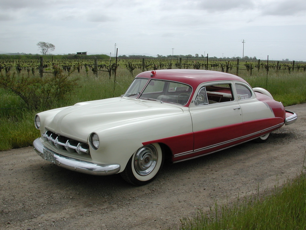

  29. The two cars that Mo posted are the only two I've seen done well, and they were both cut in the same spot, where the body meets the rockers (at the bottom edge of the door).
    Note that the Red and White car is owned by a guy here in WA, and I have been able to smoke it over pretty well. It was section years ago, and is finished quite nicely. Also, check out the hood. The car has the Twin H engine, and the hood has a blister added to clear the air cleaners.
    Night Train was at GNRS a couple of years ago...and totally rules.
    If you do wind up sectioning the car, and decide to chop it too, go easy on the chop, with 2-3 inches of vertical drop at the most.
    Mike from Florida has a beautiful chopped coupe. Check his thread out (search "what I did on thanksgiving" here on the HAMB).
    I had toyed with sectioning my Hudson 2 inches just before I painted it....Sometimes I wish I had.
