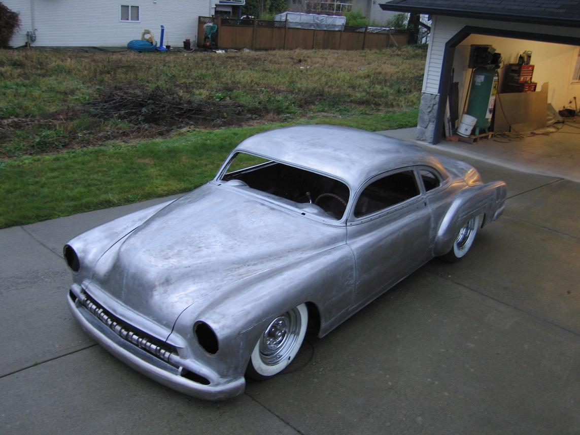

  1. Hey there, new to the hamb. Just rolled my '52 Chevy outside for the first time in bare metal. Snapped a few pics. This car has no lead or filler on it. Sectioned 6". Chopped 5.5" front, 6.25" rear. Shortened 6" behind the doors. Sitting on a '78 Malibu floor plan and chassis. Usually build hotrods. This is my first full on custom. Whatcha think? :cool:

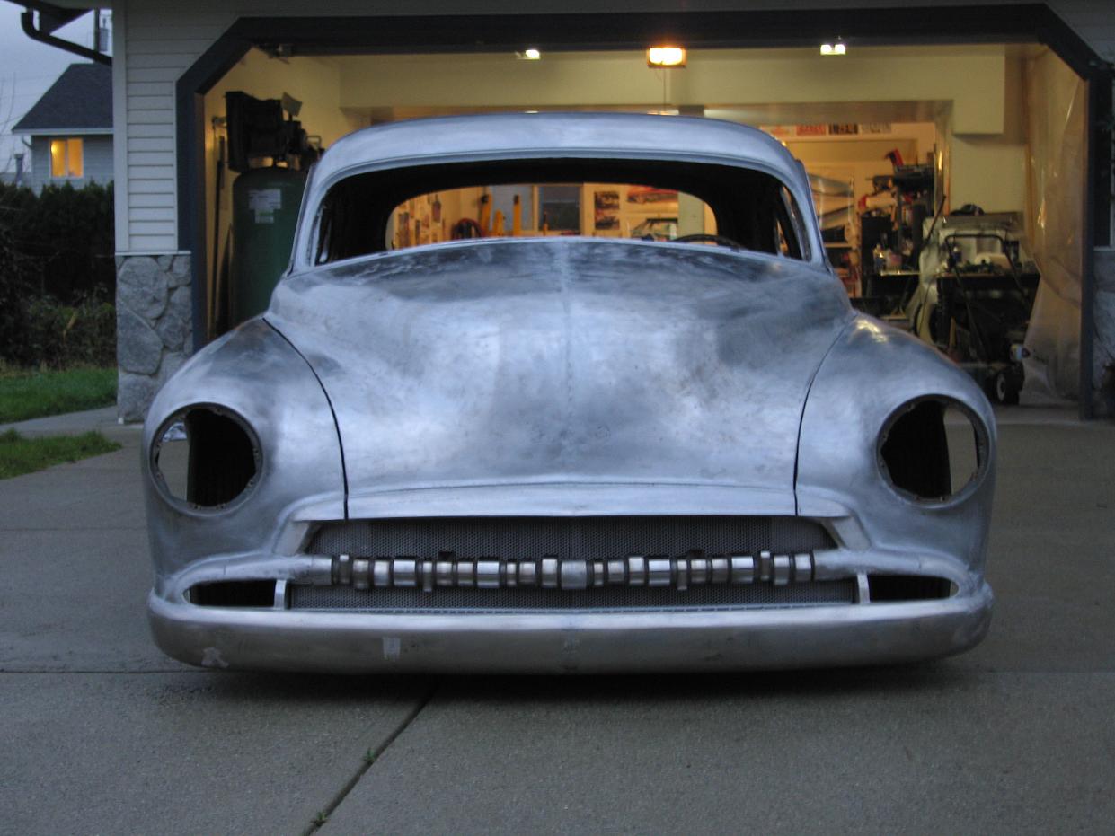

    is that a big rig cam in the grill?

    i never really like sectioned 50s chevs but yours looks good.nice work

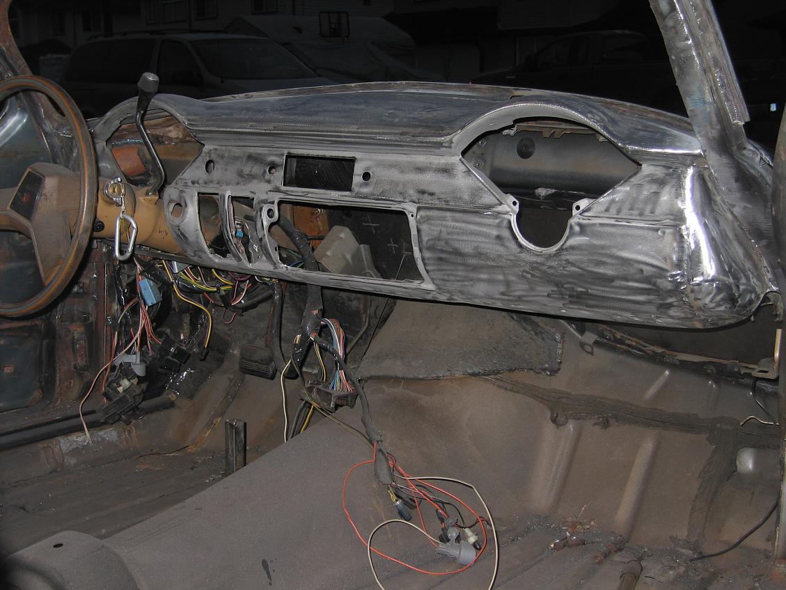

  9. yeah, the grill bar is a 425 cat camshaft out of my buddies highway truck. One lobe slightly damaged. '55 Chevy dash. Full air ride. Slated to have inverted '39 Lincoln tail lights.

  16. Shortened 6 inches? wow. I can't say I've ever seen a car that has been shortened that I liked until now.
    Nice work.
  17. This will be the stance it will have.The back end cant go down any further due to the section . The top of the rear tire is a half inch from the inside of the top of the quarter. The tire has nowhere to go except through the top of the fender. Hmmm,
  18. the car was shortened to match up with the malibu's floorpan and wheelbase also with a 6" chop the roof would've had to have been lengthened 6".So I cut the roof off shorten body 6" welded the roof back on and it was a near perfect match

  20. Wow!
    Very cool, but I reckon the tyres are too tall and aren't quite in proportion with the rest of the car due to the shortening and section.
    Amazing workmanship though. Wow again! :)
  21. Yes G body. This particular donor was a 78 malibu wagon so the rear floor is a bit different.There is no spring perches its coils .The floorpan is stock other than 8" off the rear. I even used the stock rear seat with stock lower mounts.
  22. Coming from the hot rod world Ive got to have my big n littles.I guess this look is what I would call hot rod custom

    That turned out great! with the amount of section, and chop the shortening brings the profile all together.
    I like the rake and the grille
    not a fan of the column and steering wheel though..

    I like it. Good proportions. I'm not too excited about the cam/grille bar.

    Whoa! That thing is badass! Nice work. I really dig the melding of hot rod and custom. The chrome reverse really give it the right attitude to pull that off. That took some vision to be able to take so many huge slices out of the car and still have it work.
    Just my 2¢ but it almost looks like it could use another 6" to 8" of shortening but this time behind the rear wheels. Since the rear needs to sit at the height it's at due to the sectioning, as you've mentioned, it gives it a hot rod rake yet to my eye the length of the rear (emphasized by the sectioning) makes me think tail-dragger kustom. I just did a crude Photoshop shortening of the profile pic to see what it looked like. Like I said, just my 2¢...it's your ride and even if you didn't change a thing it's WAY cool.
    Looking forward to seeing additional photos as it progresses.
  28. That's cool if it's the look you're after. I think in bare metal it emphasises the wheels for some reason. Would love to see it in a dark colour, would change the whole look, but it's too late over here for me to crank up the Photoshop.
