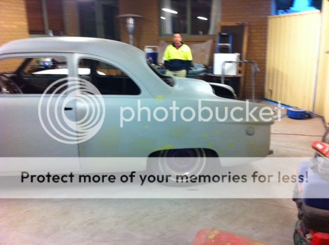

    Then I made the mistake of going to Motorex (Australia's Premier indoor show) with my brother in-law (pinup65) and the Eldorado's. In the group of approx 30 people we had 3 49-50 Chopped Coupes. During the 16 hour drive to Sydney and the remaining 3 days the conversation between myself and brother in-law centrered around my business coupe and what we could do to be different to all the others. The idea of sectioning was tossed around, after arriving home and speaking with Mark at Car Guys Garage, thats when the build took on a totally different direction. The car is now well on the way to a Full Kustom.
    We started with a 2 and 3/4 inch section of the body
    Then we lowered the rear wheel arches 4 and 3/4 inches and reprofiled them at the same time.

  8. I'd sure like to see a shot from farther back for profile.
    Nice looking work!

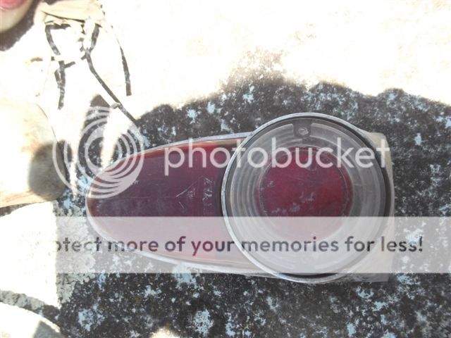

    thanks for all the comments heres another update, decided to change the tailights, found a car with tailights we thought might work and went with them-54 Plymouth.

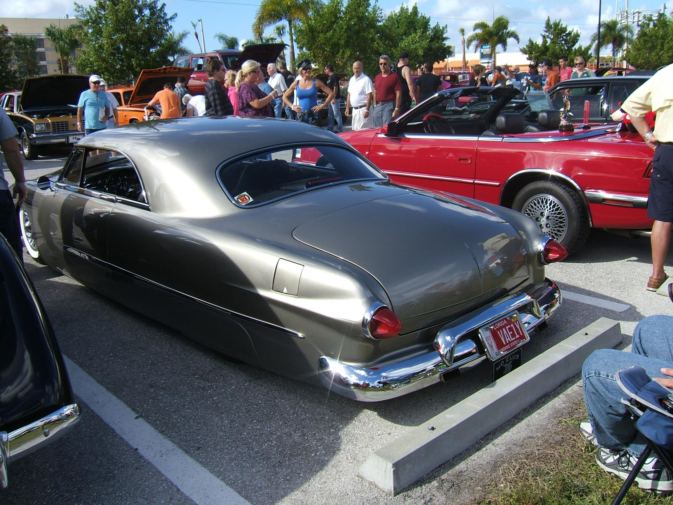

    Looking good,here's one that was in Florida last month.
    TwoChops

    I saw it at Billetproof at last year.Its pretty cool ride!

    That ooks great. To bad the headlights look like that. Throws the flow off.
