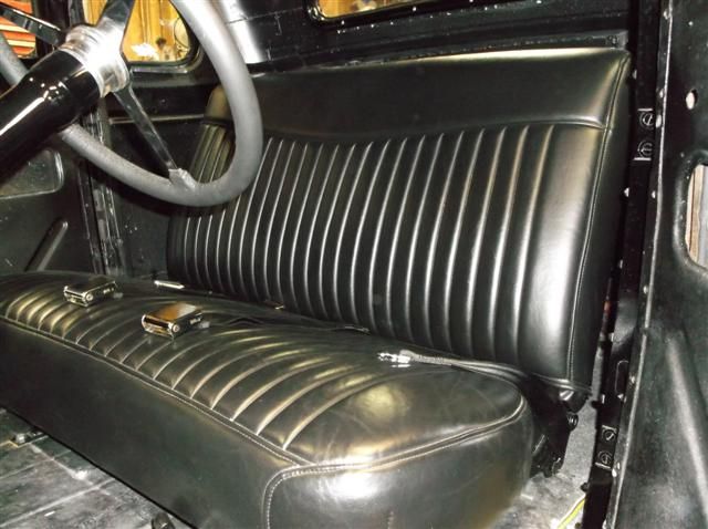

  9. flamedabone
    Joined: Aug 3, 2001
    Posts: 4,505
    flamedabone
    Troy did this one for my '34. It started out looking just like yours.
    -Abone.
