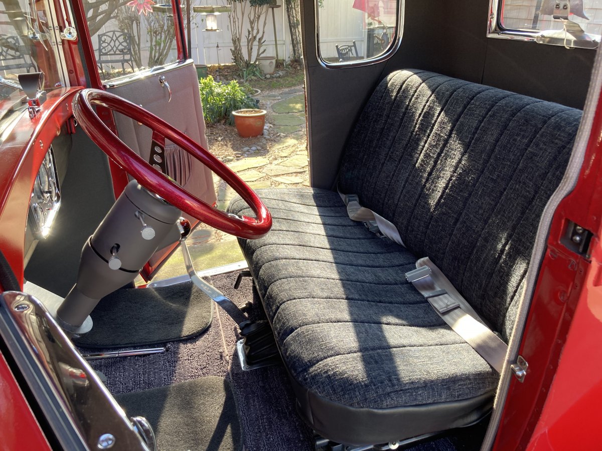

    A59CA6E9-55EE-4693-9EA3-75FDC3CB4E2F.jpeg Put a bench in mine, much better than the buckets.

    Mine is middle seat out of a Caravan which I made adjustable, added 1” foam to both pieces and My Wife did the upholstery.

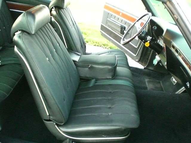

    GM Strato bench with arm and head rests....

    I have a Strato-Bench sitting in my office right now, it's roughly 55 inches wide. No chance that's going to fit in a Model A Ford, even if you completely sectioned the armrest out.

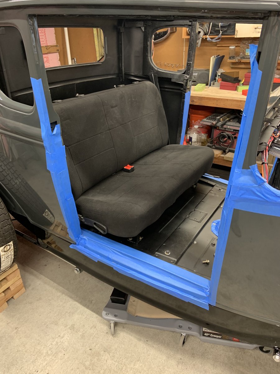

    First one, IMHO. I also used a Caravan middle seat 367598FB-D628-4A3A-B2BA-DF841FA7F40F.jpeg

    Mine is from a 2000. Had to shorten the handle that releases the seat back. I got some universal sliders from Speedway for adjustment for and aft.

    Yes, the seat folds. I used the adjuster from a rear caravan seat, cut down to the max. This method would not work in anything but an unchopped car.
