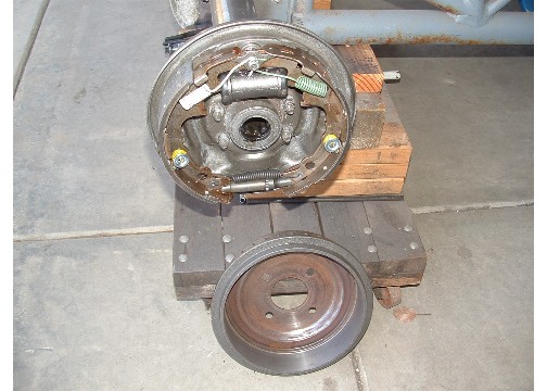

    Well it has been a good weekend of work on the car. I installed a new set of brake shoes, wheel cylinders and had the drums turned. This is a small Ford 8.8 rear end out of a 93 Mustang and only has 9" brake drums. I thought this was a good place to spend some cash to make sure the ride can stop during those all out 15 sec passes. ;) Installed a set of 3.90 gears in the traction lock setup. This rear end is about 50# lighter than the same 9" setup and I think it will hold up fine with the Powerglide. With my big --- in the seat I need all the weight reduction I can get.:)
    Today is the day I have been looking forward to sence I hauled home the frame and 5 pieces in the back of the truck. The car is finaly a complete roller with steering, front end, rear end done and ready for the drive line phase. You have to build one of these to know how it feels to see it sitting on all four tires. :D I am a happy camper!!!!
