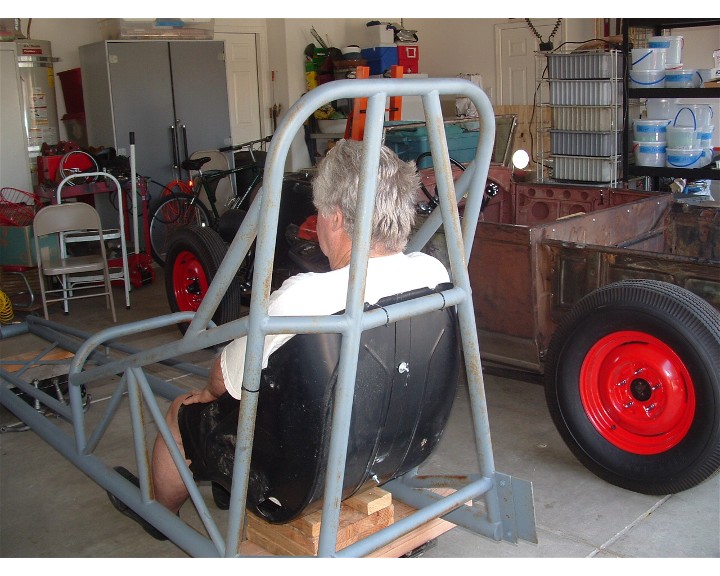

    Well just had to try the seat out and see if this chassis will fit
    "my wide frame" ;) Looks like it will do fine.

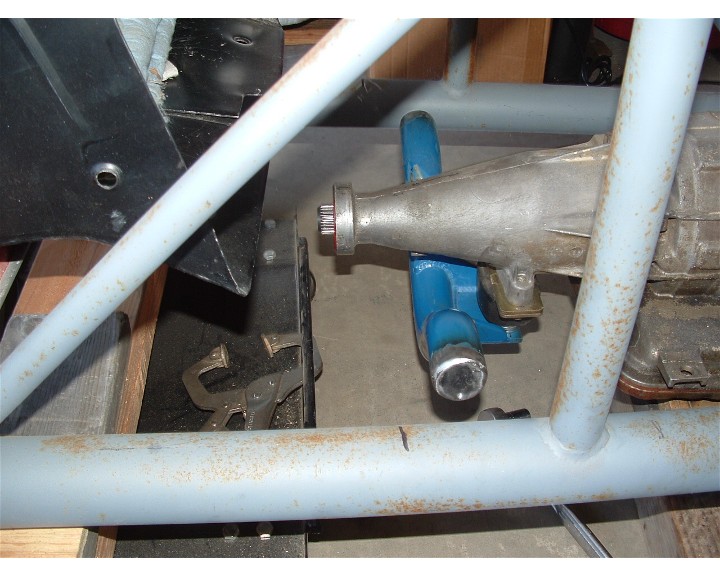

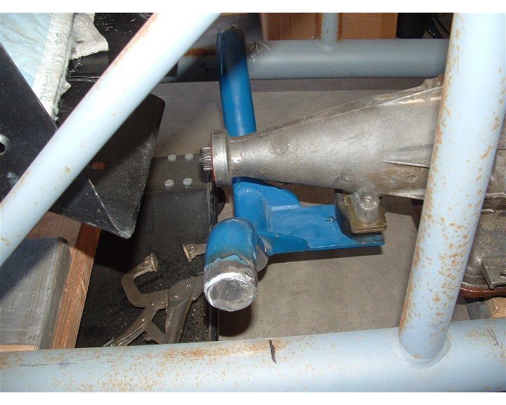

    Well I got some work done on my trans mount. In the use what you got mode I cut out a 6" trans drop from part of a 22 T frame I had and cut it down to a 3" drop. My plan was to bolt it in with tabs from the frame, but it did not look that good so I added tube to the ends and will weld it in. Shortened the mounting plate so it all fit better.
    Started putting my front wheel together today. Need to blast/clean and paint. Some pictures in a few days. Still looking for some MC shop fronts tires. Most shops won't even give or sell used tires (Calif-the # one law-suit state).

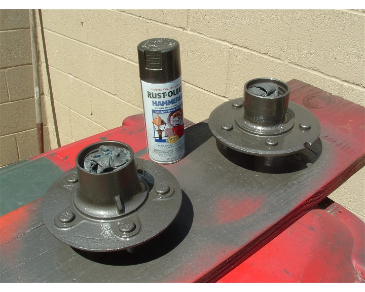

    Just a few more pictures of parts I picked up at swap meet and on the HAMB.
    Got a set of bare front hubs and pressed some new wheel studs in. The hairpins were a find at Long Beach Swap Meet and will look nice with the drilled axle. The front wheels are 1933-34 Ford 17" From the HAMB and I will put some MC tires on them. Found some new ones on the bay for a nice price and they fit the 3 3/4" wide rim real good.
    Hope to get the rear axle mounting plates cut & fitted this next week.

    bobw
    It's coming along quickly. Nice parts you are gathering. I like the trans crossmember.
