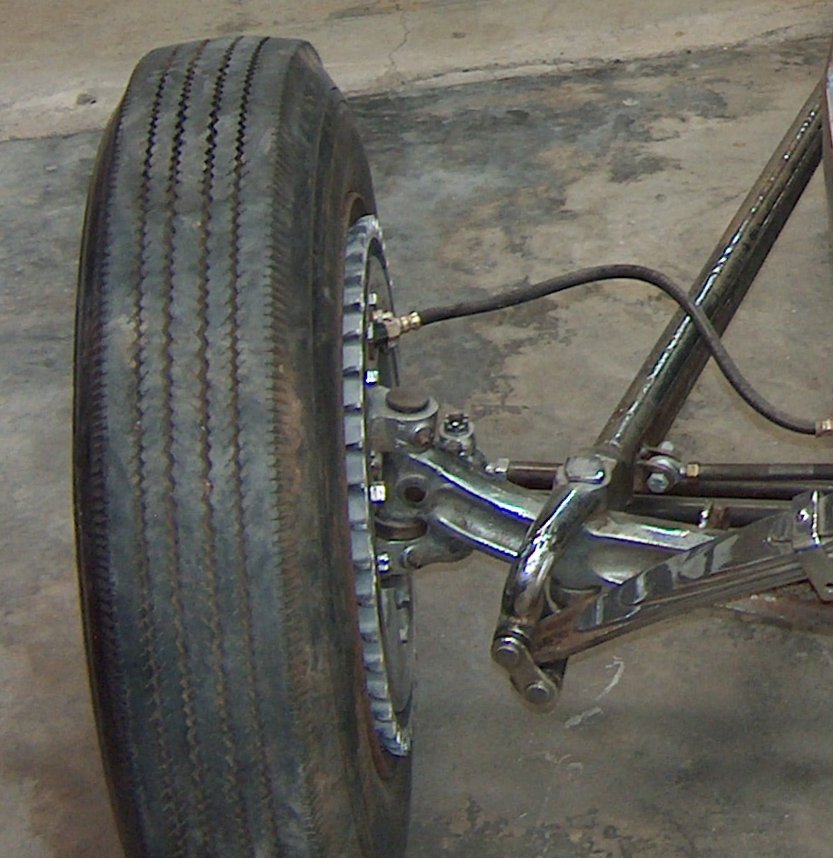

    I see it far worse with finned Buick drums. I have disc brakes on the front end of my A, and the scrub radius is not bad at all.
    Yeah, but let's bash disc brakes.....

  24. Blake 27
    Joined: Apr 10, 2016
    Posts: 1,511
    Blake 27
    Lil'Alb, dana barlow and Hnstray like this.
