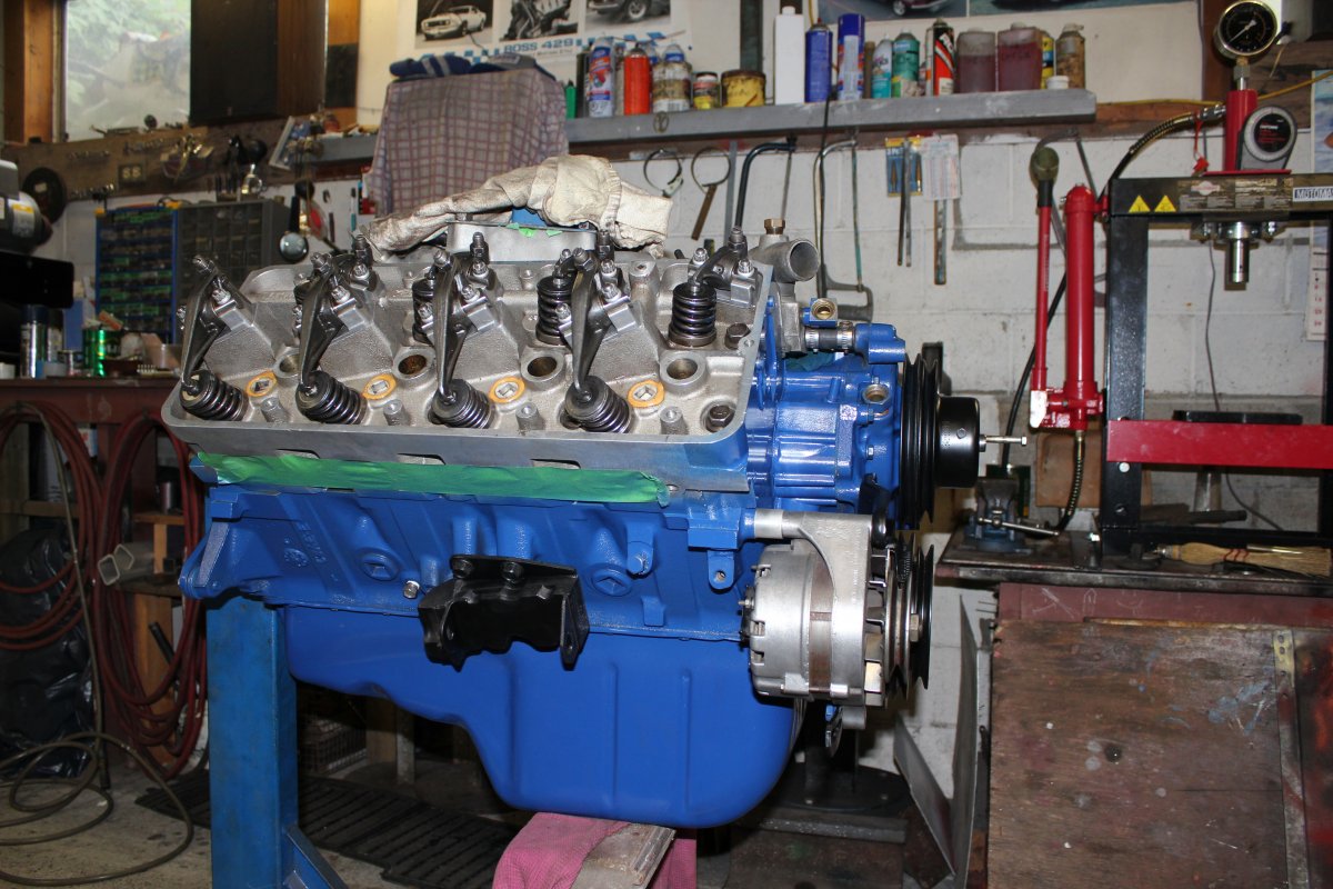

    Might be worth while in a supercharged application. I can see it as a safety feature more than anything. IMG_2525.JPG
