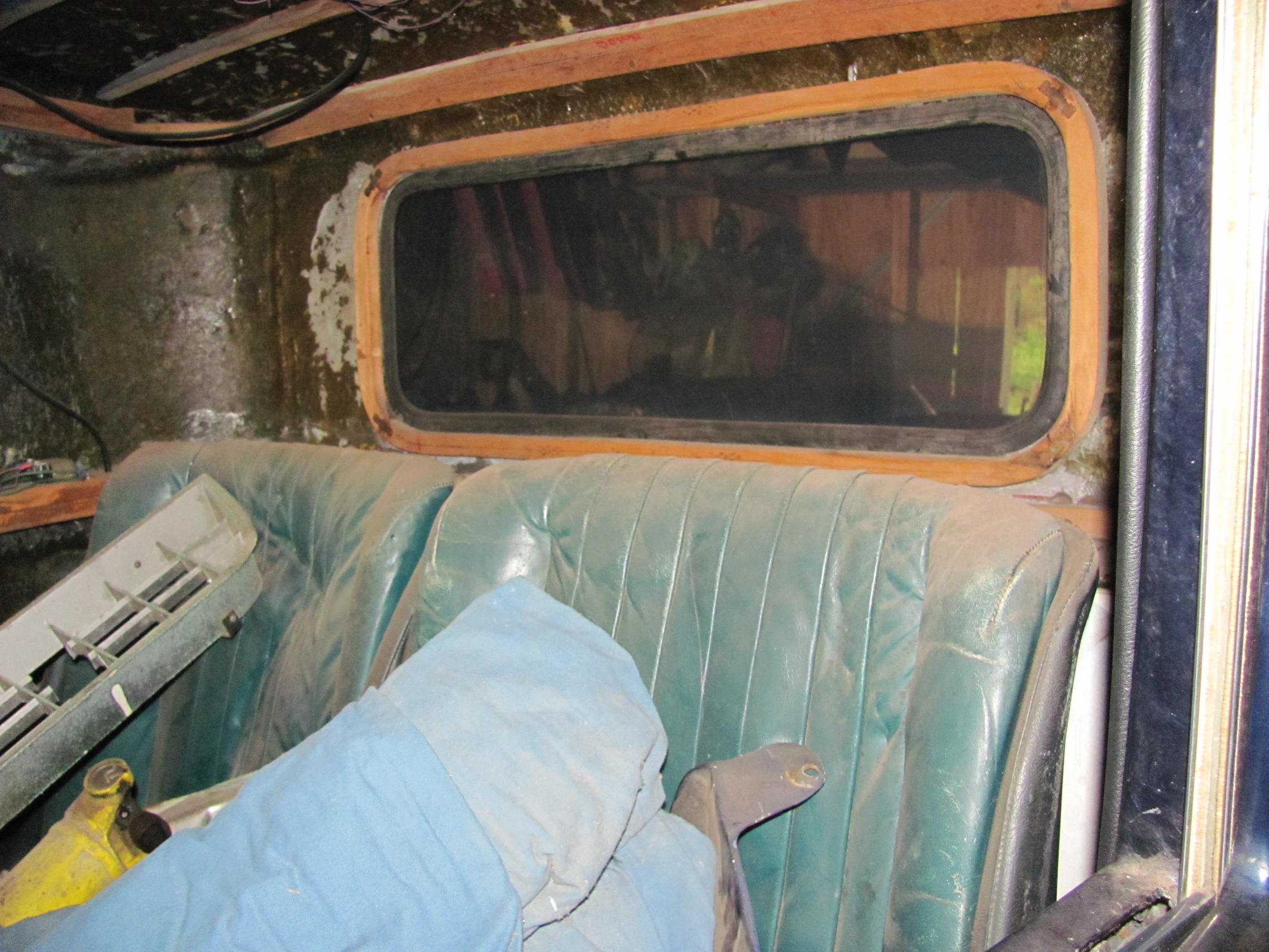

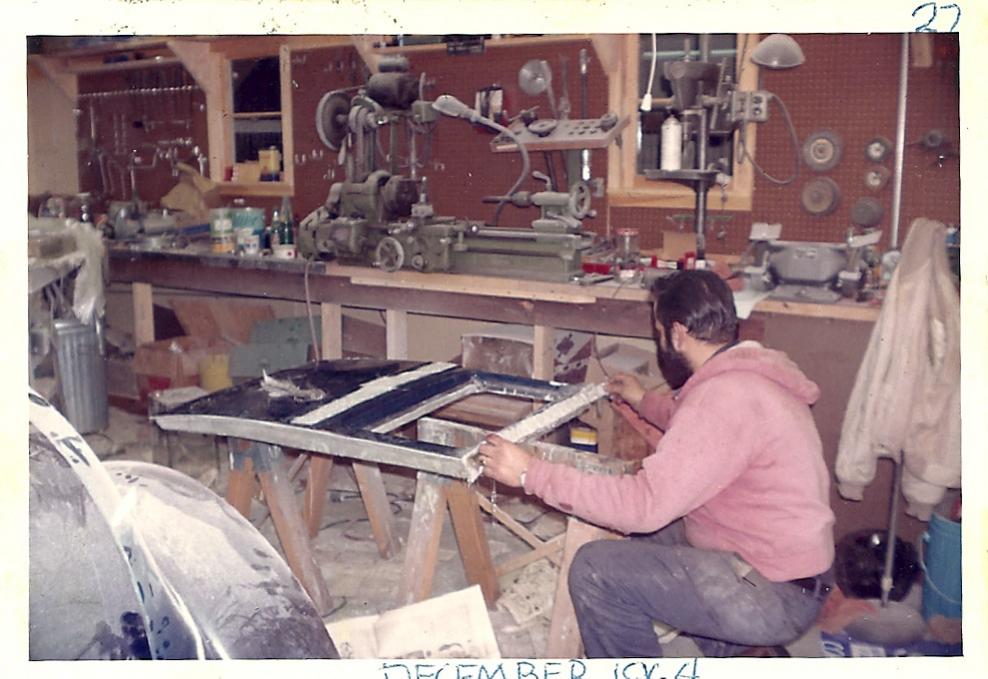

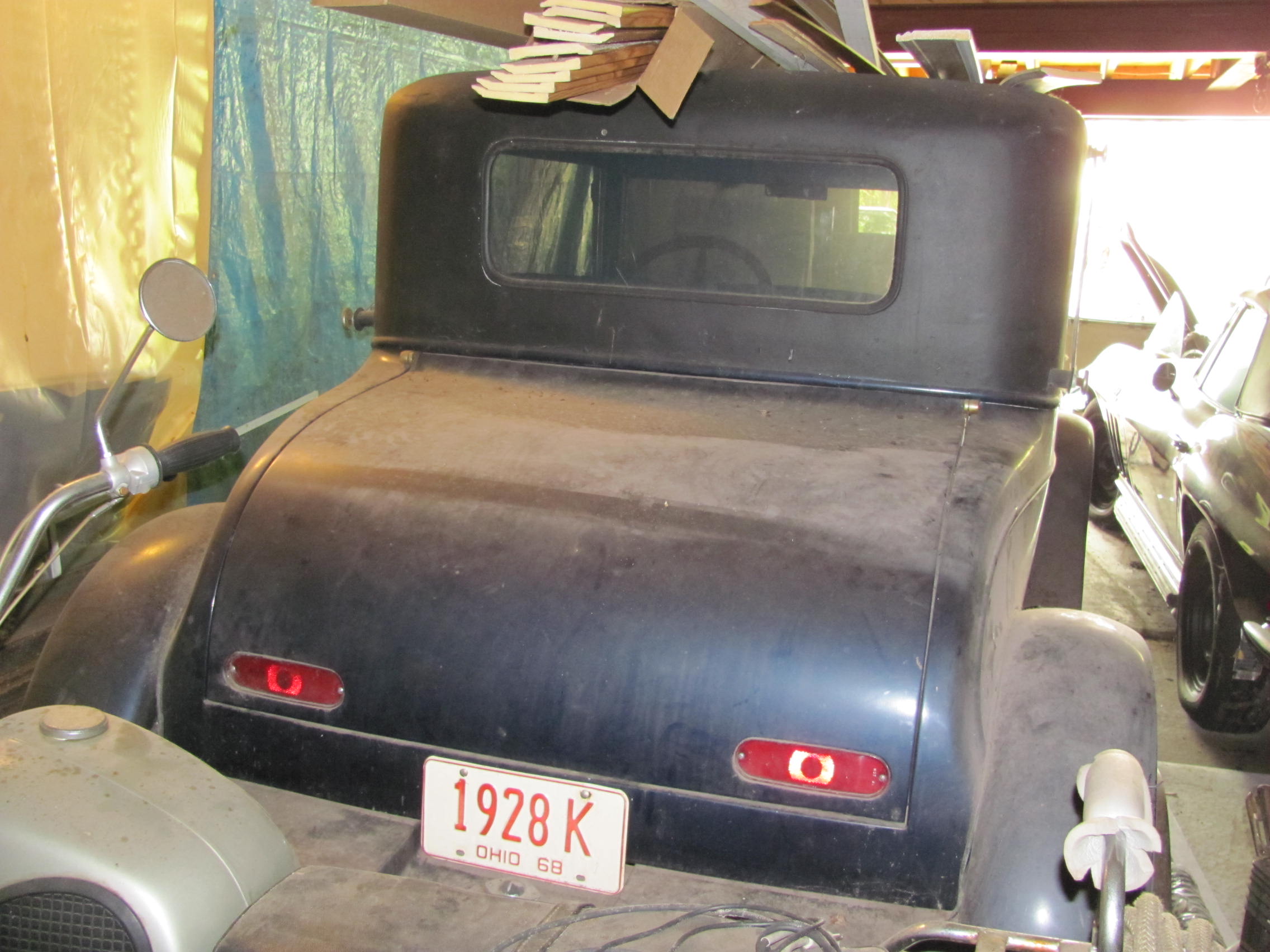

    I built a duplicate body for my 28 chev 3 window in 1962,I was 19 yrs old.I used the original steel car that I had been driveing and showing since I was 15 yrs old as the patterns for my molds. I did change the deck lid conture so it is flush instead of overlapping,and the door latching system is from a mercedes 300sl.The body mold was about 15 pieces,all flanged together so that the body shell itself could be one piece. Doors were made with inner and outer shells,the inners mocked up with wood patterns in position on the stock doors. Fenders,splash pans and running boards were all realitvly easy 2 or 3 piece flanged bolt up molds.I ended up pretty much building a whole new frame/suspension because at the time, I was paranoid about the glass body parts stress cracking from frame flex.You must keep in mind, I was a 3rd year mech engineering student and as such had a better grasp of these things than most,but I was totally wrong on that one! I used a center X frame 58 chevy section complete with the coil rear suspension. I used some of the original 28 side rails,boxed,and I think it is a 48 chevy master front independent suspension.Motor was (at that time) the same 301 sbc with 2x4 and a 4spd t-10 that I had in the steel car.Over the years I became interested in other things,built and owned a FRP molding shop (production parts) and the 28 went to pasture in one of my barns where it has remained to this day. The acrylic lacquer paint is still perfect however the interior was gutted out around 1969 and never replaced.This being the 50th aniversary of its creation, my plans are to resurect it,repower it,put an interior back in it and celebrate!
    If you have any questions I can answer,I'll be glad to help.I did a lot of mold and pattern work for the parts we built includeing 2 different drag boat hulls,one being a runner bottom flat and the other a pickelfork hydro.This was all in the early 70's so pics are pretty nonexsistant except for the 28, of which I have a few downloaded from 35mm snaps.
    john

    Not to be argumentive, but you would need more than 2 breakaway sections for that body. I see 1 for the firewall,1 for each side,1 for the cowl top and dash,2 for the cockpit returns,and 1 for the deck lid rear pan. I see 7 pieces minimum.Keep in mind I did this for a liveing for 40 yrs.That body is also a spray up,buit with a chopper gun.I had Glas Craft and Glass Mate boom units. What did you use? Gelcoat was sprayed too. I used a Venus airless gel coater,yours?
    edit) I buit probably 200 of those 32 front shells over the years.Thats a 4 piece breakaway,one for each side,a rad cap return and a front panel. The front panel has to be molded full then cut out at trim, or else it will be too flimsy to pull and ship. Just a fyi

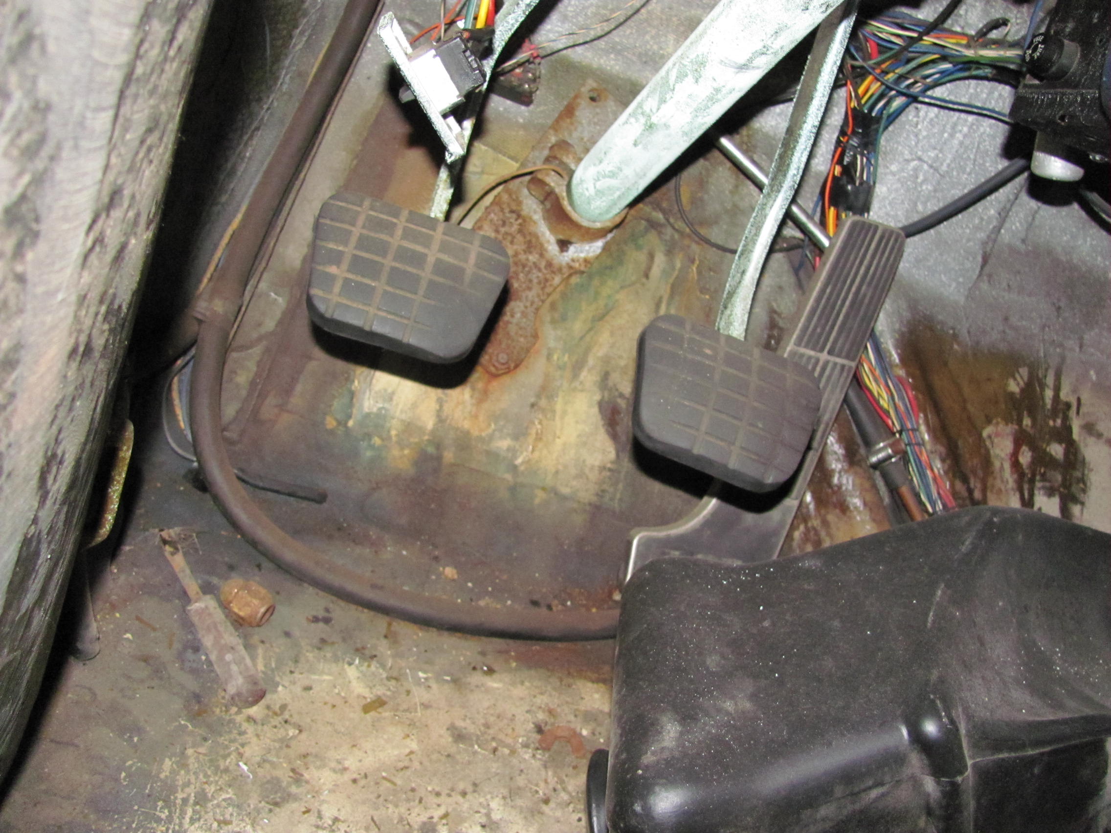

    This is how it is today.On the interior I did old school maple rails bonded into the body in the mold. The door and lower body sills were built in the mold too,over maple forms that are still encapsulated in the shell.The door pilars are full tubular sections ,again finished while the shell was still in the mold. The hinge and latch pockets were backed up with 5/16" brass plates,dirlled and tapped thru drill jigs after the body was pulled. Floor sections were not molded in the shell mold,they were built later over wood paterns that were covered with mylar sheet to prevent sticking.They were then trimmed,fit and wet lay-up attached to the lower sills.The result was a body that was so rigid that it didnt even need a frame ,especially since this was all built before I had any spray or chop equipment.It was actually my firstfrp project and done in my dads 3 car garage. I did recieve a LOT of tutering and help from a guy I met in college , Dick Hadlock,who was doing his masters work. He was employed by Molded FiberglassBody Corp in ashtabuhla ohio,(aka MFG). they built boats,all the corvette bodys,the Avanti bodies, and a lot of parts for Westinghouse Medical.Years later,dick would have his own shop in Geneva Ohio,Hadlock Plastics Corp.Its still there,he sold it out 10 yrs or so ago and retired.I did almost all of his overflow and low volume parts,UPS front fenders,white truck floor panels and lots of different fan shrouds,medical equipment wire raceways for cat scan equipment,and much more. I'm off topic and rambling now,so back to car parts.The hardest part of that body was keeping the door openings square so as to fit the doors that I hadnt made yet! The old chev stuff was all wood and pretty loose by this time. I had to x brace the openings after the mold was assembled to maintain the measurements I needed because all 4 sides of the door opening had to have breakaway flanges and separate mold flares so I could get the finished body out. I was determined to make the shell in one piece and in retrospect made the whole project much harder than it had to be!
    john
