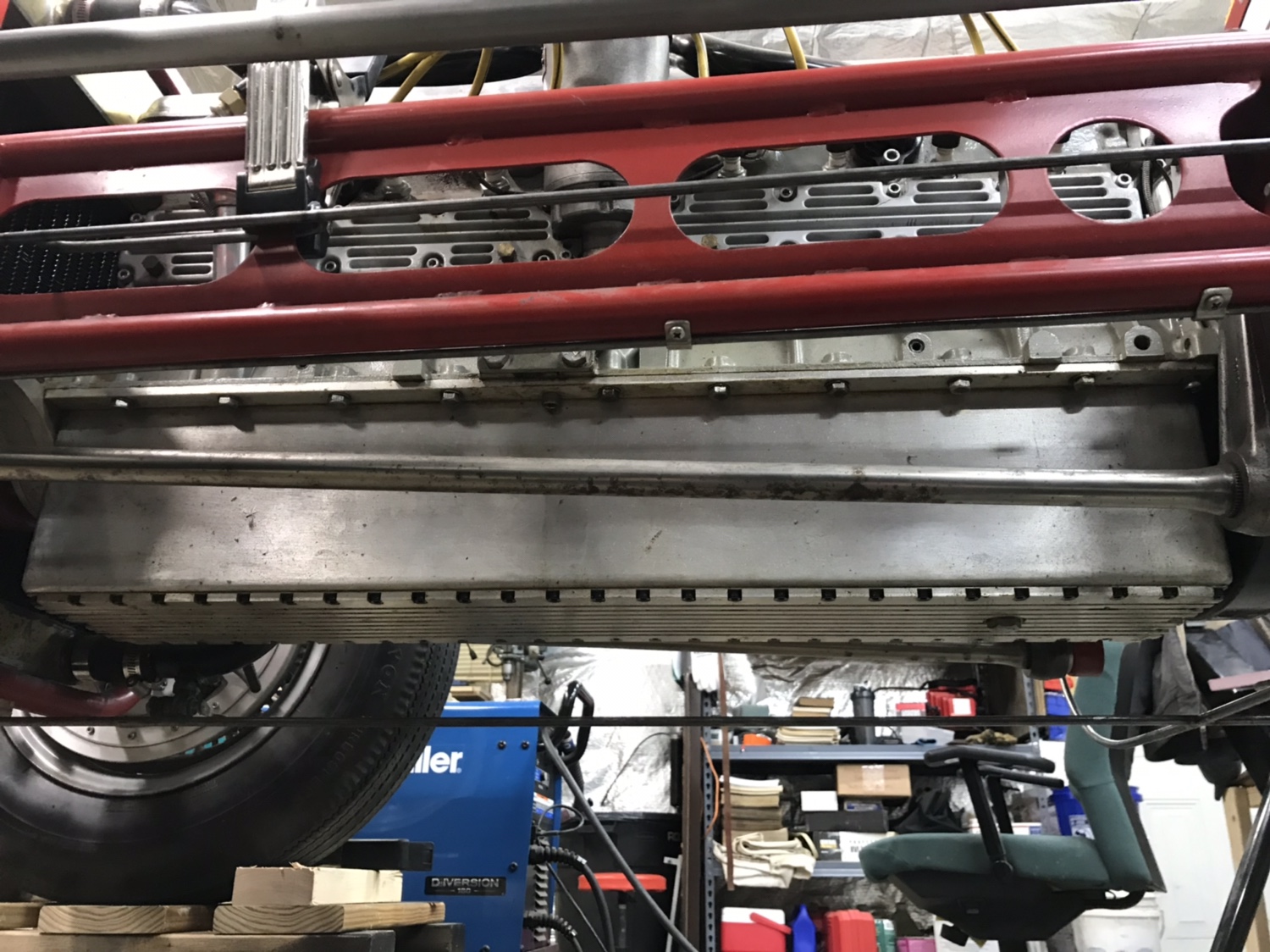

    So are we to believe that the block, sump, head, crankshaft, cam, valve cover plus misc. parts are all newly fabricated parts?

    To add some the engines I think are mounted nose to nose, cranks joined at the splines that the tower shaft and dist/oil pump drive gears are on, thus the mag drive..Possibly driving both cams with the one tower shaft..The spline areas are not the strong suit to handle power transfer from front crank to rear crank but builder probably beefed the area up..I have read that the tower shaft is pressed into the drive gear only and should be welded to handle increased two-cam loading...What a build; really cool thinking!!!!

  21. So how are the engines mated- I can see that the oilpan looks like one cast piece, but are the two cranks sleeved together, new crank, etc?

  22. I still haven’t gotten a chance to talk to Bob to see how they’re exactly connected together. I did snap a few more pictures of the bottom of the engine. Also one of where the mag enters the block. I think someone had asked about it earlier in the thread.
    [​IMG][​IMG][​IMG][​IMG]

    Thanks for the extra pics- looking forward to hearing what he did to mate the two cranks!... and the off-white paint, casting numbers, etc scream of Homlite blocks, so he's up to a whopping 118ci of high-revving fun :D
