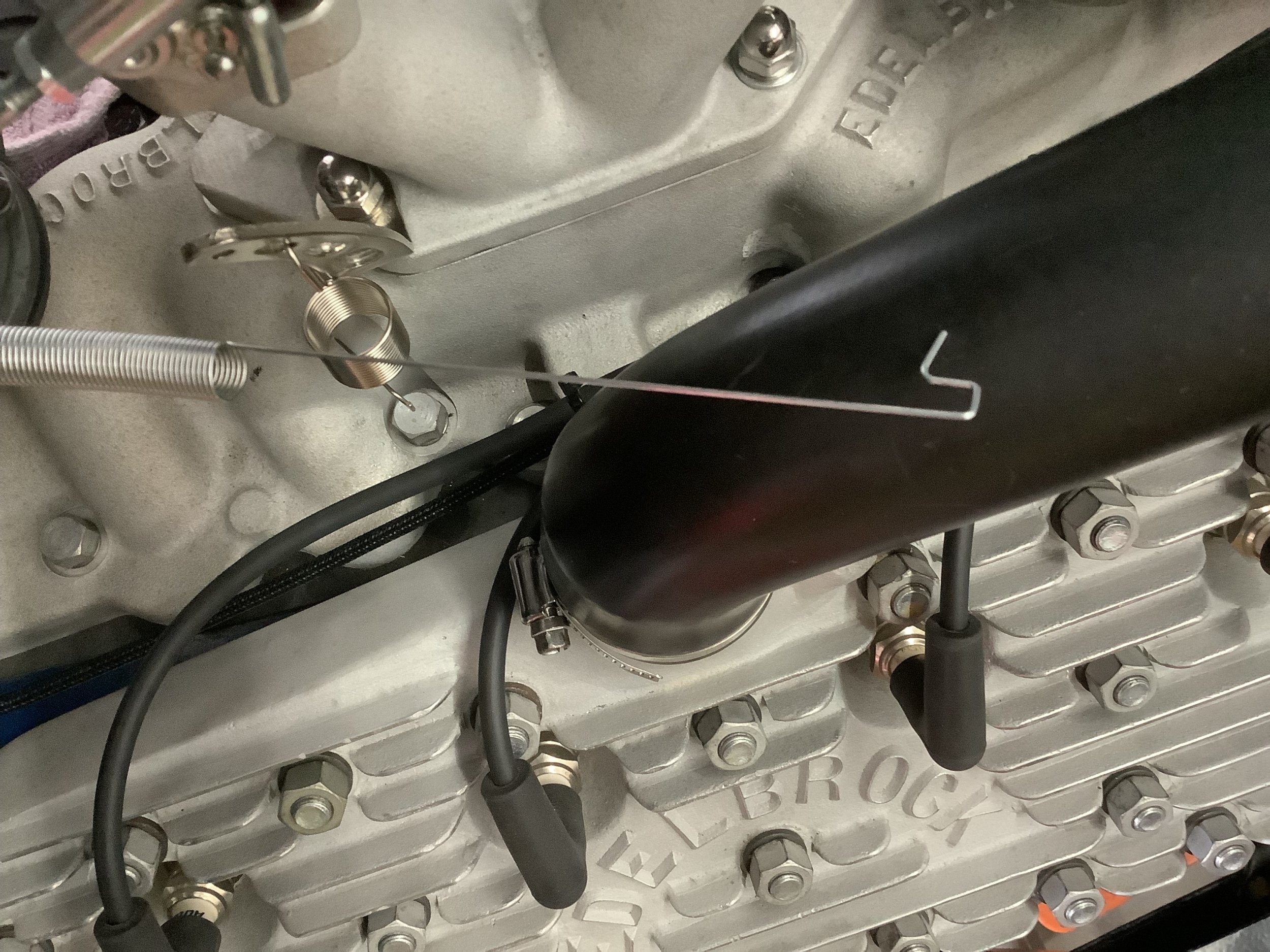

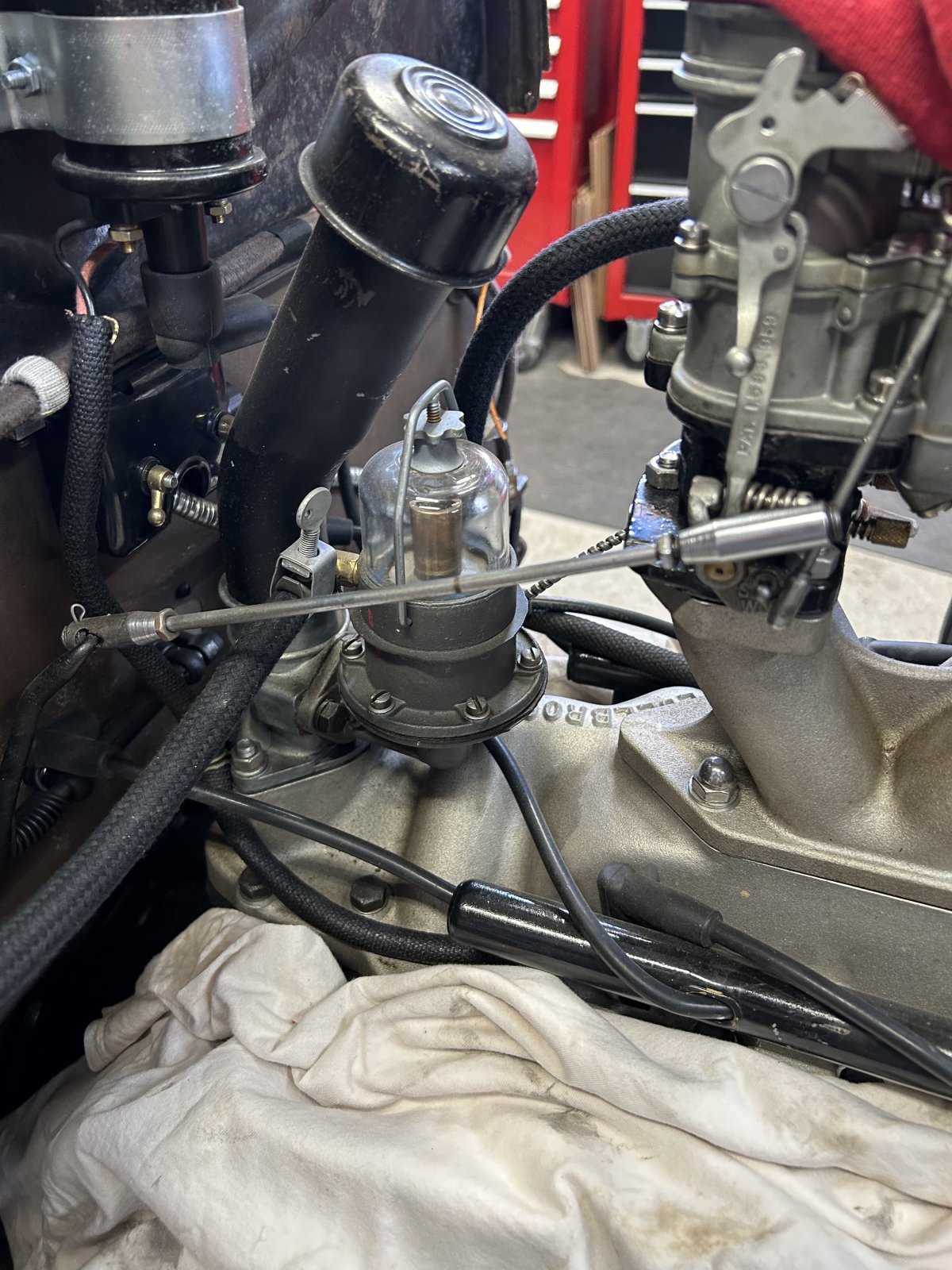

    First, the specs: 34 pickup with original spoon pedal assembly mounted on firewall with dual 97s (direct linkage on drivers side) atop slingshot intake.
    Searched for the steps on how link my spoon throttle pedal to dual 97s but can’t find what I need. I’ve got a pile of accelerator linkage rods to chose from but how do I:
    chose or fab a correct length rod? How does this set the pedal orientation for the drivers foot and range of motion for acceleration?
    Do I need a single rod from pedal assembly to the front or rear carb or use a rod between carbs and then link to center of this rod from pedal assembly (see last picture)?

    Your plan for tying the carbs together and linking it from the center seems correct from what I normally see.
    In my 46 I used the stock pedal which has a similar Z bar with a spring but to get it to connect to the throttle linkage on the drivers side I cut the upright off and welded it to the other side. So now it’s more of a T than a Z but acts exactly the same.
    Then I just connected the dots with solid rod cut to length and threaded for the quick release ball joints like your showing in your last photo.
    tarheelrodr and winduptoy like this.

    You need to narrow the firewall linkage or bend it so it lineup with the ball connection on the passenger side of the carbs. You can connect it to either the front or back carb, since they are connected together on the drivers side. Make the connecting linkage long enough that when the spoon is floored the carbs are wide open.

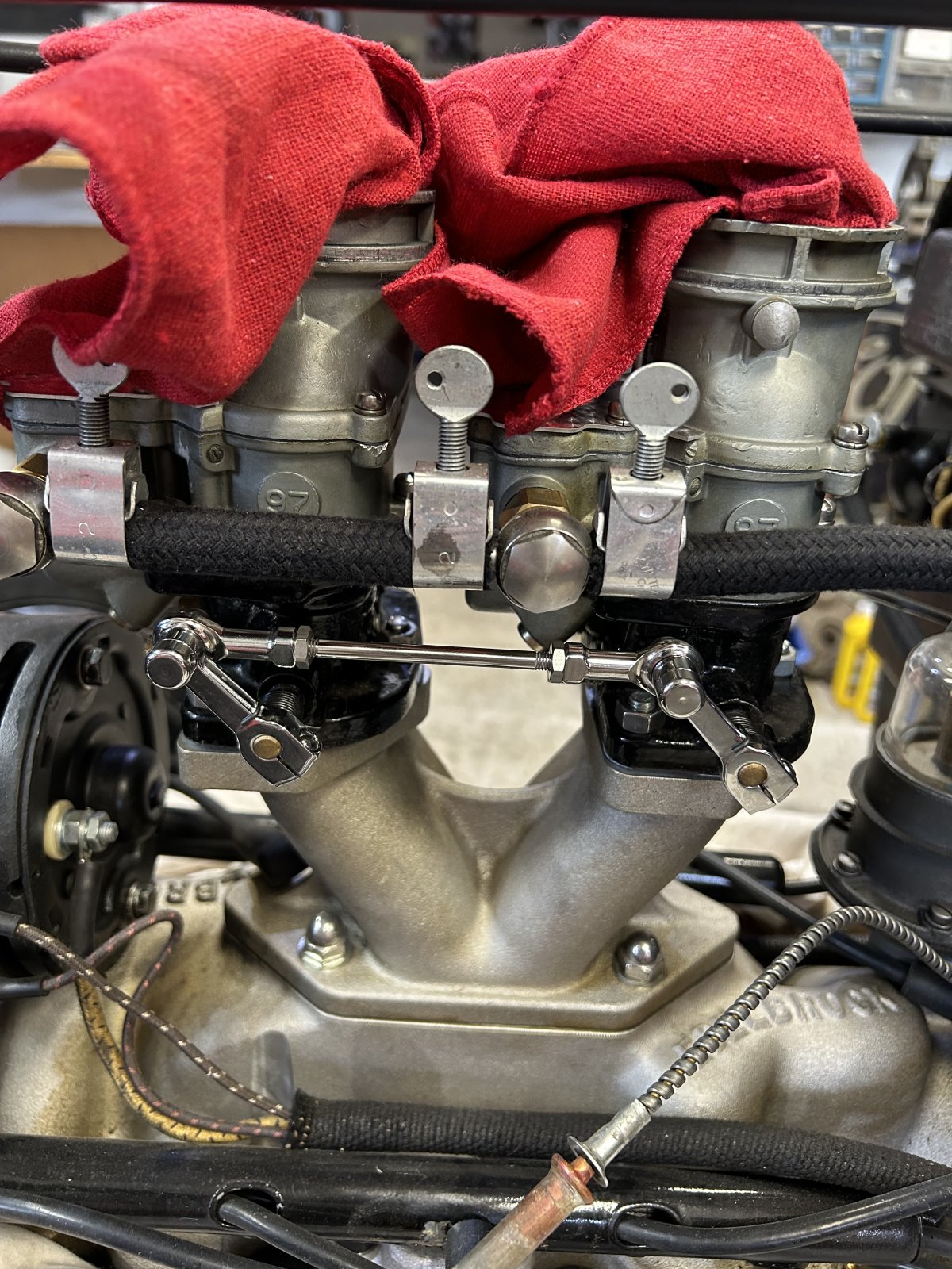

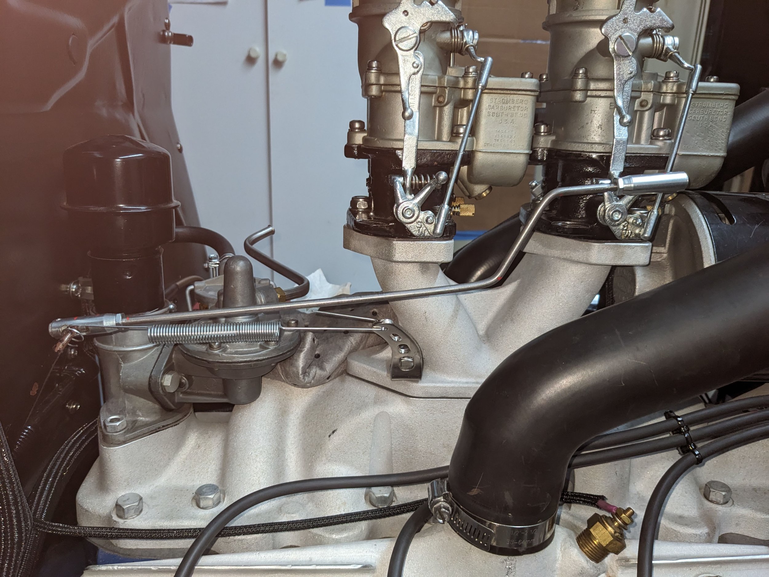

  4. banjorear
    Joined: Jul 30, 2004
    Posts: 4,651
    banjorear
    I'm in the process of replacing the heads so don't mind the mess, but this is what I did. Narrowed spoon pedal to fit the Model A firewall. Linkage rod to rear carb. Stromberg linkage on the other side tying them together. Linkage .jpg Linkage 2.jpg

  5. winduptoy
    Joined: Feb 19, 2013
    Posts: 3,651
    winduptoy
    Looks like you have the bell cranks on the carbs on the back side. This ties the two together....good!
    Now all you need is a linkage from your foot throttle to either one of the carburetors on the other side. No reason to tie them together on both sides.
    As mentioned, you can bend/cut/lengthen/massage the foot throttle arm to align better with the carburetor bell cranks.
    You can also bend an offset or dog leg into the rod you use to connect the foot throttle to the carb.
    I used the quick release ball sockets from a stock linkage, cut to length and gas welded it back up.
    Hope this helps...

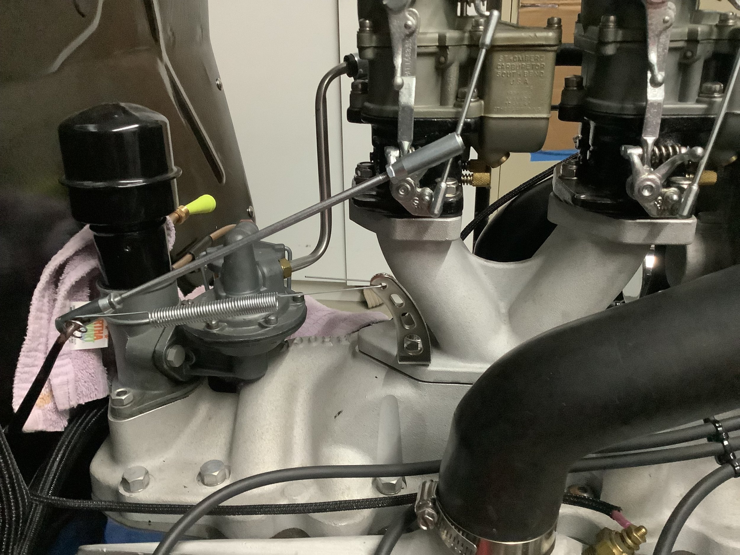

  6. continentaljohn
    Joined: Jul 24, 2002
    Posts: 5,696
    continentaljohn
    I found a rod that was pretty close to hook up to the spoon pedal. I also have a setup like yours on the other side of the carbs. You’ll see guys cut and weld to get the correct length image.jpg image.jpg

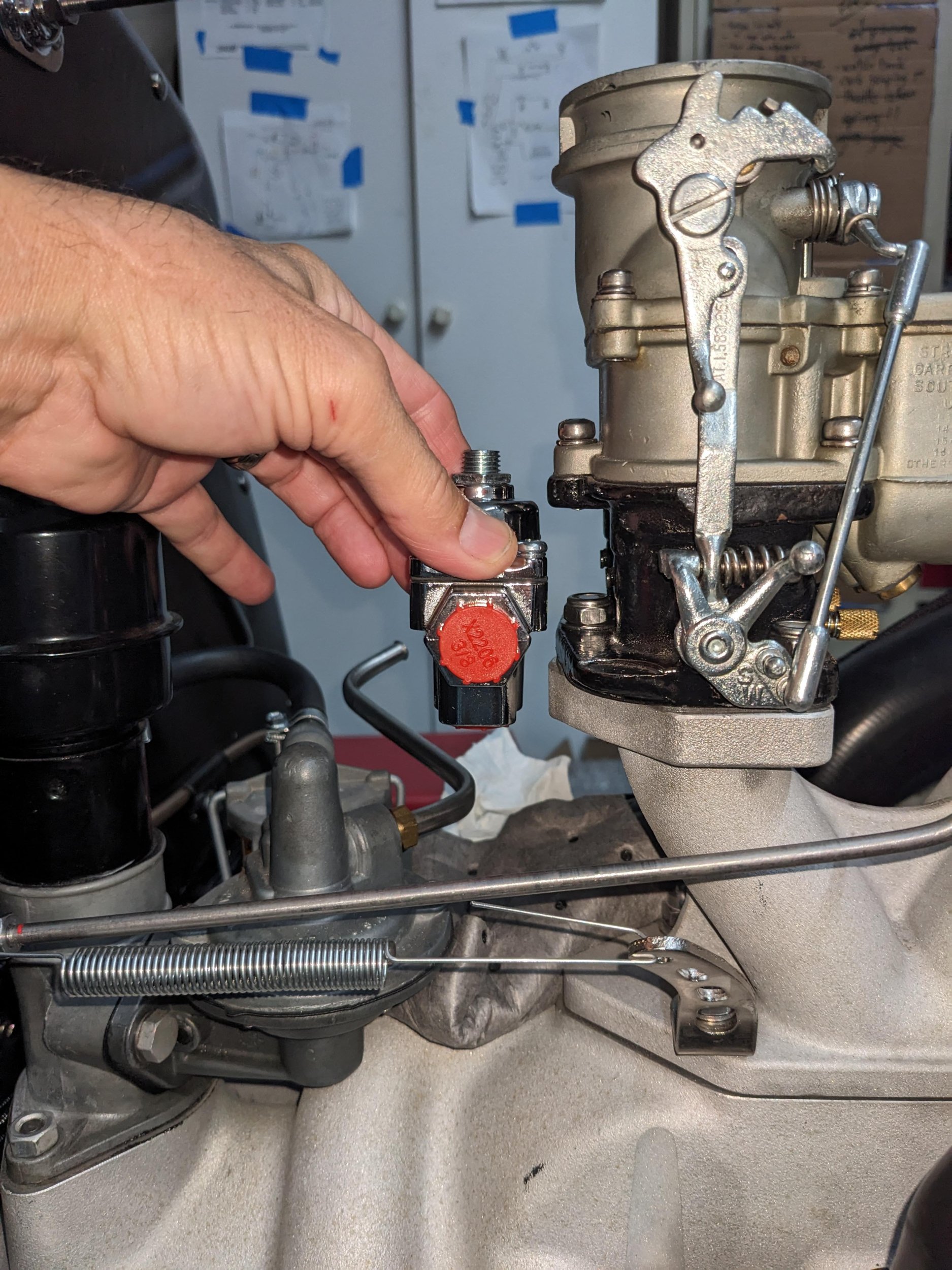

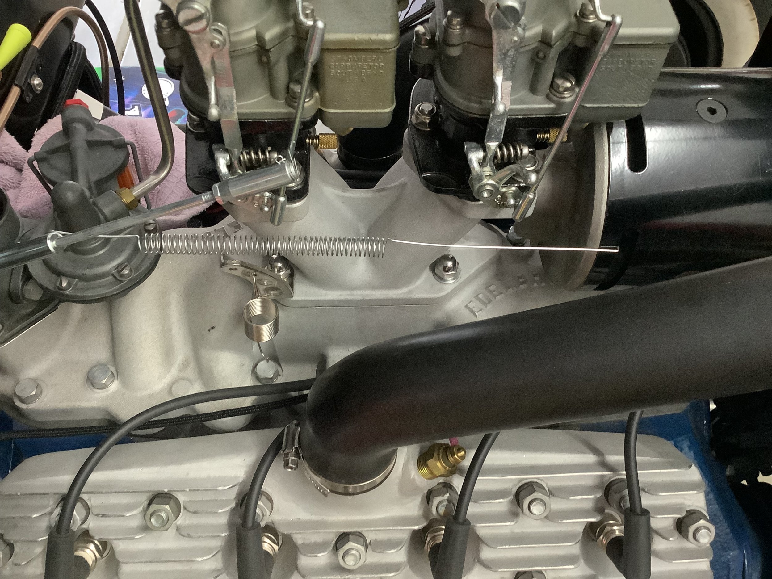

  7. tarheelrodr
    Joined: Feb 6, 2007
    Posts: 164
    tarheelrodr
    Looks like I have an extra hole in the firewall underneath the pedal assembly. Am I missing a part of the pedal assembly? Am I missing some sort of bushing under the red primered cup covering part of pedal assembly?
    just above the pedal spoon I see a little knob that appears to be for a spring to attach?
    last pic shows mock of linkage to measure for a single linkage rod. IMG_0789.jpeg IMG_0788.jpeg IMG_0787.jpeg

  9. I'd leave the linkage on the left side as you have it (make sure both carbs are sync'd) and make a new rod from the pedal arm to the front carb (less angle than rear carb).
    The connection on the inside was for the the original hand throttle.
    No bushing, the cover holds the housing down and the pedal shaft turns inside the housing.

    Any of these suggestions will work, but from a mechanical perspective attaching the linkage to the rod that connects the carbs is the better choice. You'll get less throttle shaft wear and easier synchronization.

    Looks like the setup in your last pic would work fine if you trimmed off the excess. You wouldn't need (and shouldn't have) the linkage on the other side.

    Just make a correct length link from the pedal ball to the ball on the passenger side of the front carb and be done with it. Been done hundreds of times, you are over thinking it.

    I set my throttle up to pull off the front carb and aligned the throttle pedal ball end to be perfectly in line with the carbs and not pull at off angles.
