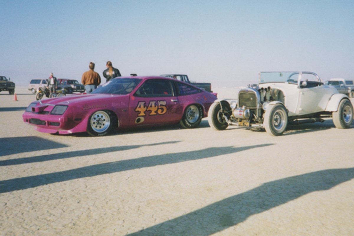

    I drove this roadster on the street with Enderles off and on for 25+ years. For 3 years it was my only car. It ran lean, it ran right, it ran rich – all in the same day with temperature and humidity changes. Oh, if I'd only had a Dial-A-Jet. And the 4-speed Hydro didn't help things.
    When first set up, I ran a 3/4-inch hose from the rear fuel tank. Upon sudden acceleration it would run out of gas as it surged back into the rear tank. I fixed that with mounting a simple electric fuel pump to a smaller line that ran to a newly-installed Moon tank in the front. I fabbed up a Holley float bowl assembly behind the tank to keep the Moon tank about 2/3s full. That helped a lot.
    Here's the roadster at El Mirage. I'd driven it up from San Bernardino to help my friend Steve Batchelor with his Monza. Steve still holds the C/Classic Fuel Altered records from 1992 at Bonneville at 243 and El Mirage at 213. The roadster, with the same engine, still holds the C/Street Roadster record from 2009 at El Mirage at 193.

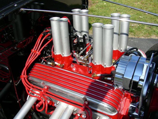

  27. I put this on my son's Model A in 2008. It's the first version Hilborn made for SBCs.....1.75 inch. 7A nozzles. Port matched intake runners/manifold. Motor is a Z-28 off-road Trans America 302 unit (not the factory Camaro one). Trans is an M-21. 3.,50 gears. Ignition is '62 'Vette dual point converted to Pertronix. Runs perfect on the street....hardly ever need to make adjustments on a daily run....set it once each day....unless the weather changes dramatically. Idles very well, spins up instantly.....to 7200 RPM. Modified barrel valve, by-pass valves, Dial-A-Jet (made up tables for temp, humidity, barometric press), wide band gas analyzer on board active all the time. Start-up/prime with an electric fuel pump on a by-pass line with a check valve....fires up from cold right away. Runs OK on 93 octane pump gas, but prefers 100/110 octane. (11,25 CR)
    Critical tip.......I set the butterflies hot using a UNISYN tool, and a feeler gauge. Everything moves a lot while warming up.
    Makes for a nice hot rod.....

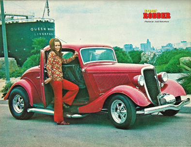

    Hello,
    Back in those old freelance photojournalist days, we met a lot of people. My wife was usually with me when we went to those rod runs and picnics. (Andy’s, Prowlers, Early Times, LA Roadsters, etc. ) It helped as the girlfriend or wife came up to us and started talking about the hot rod or picnic, etc. That made it a little easier to talk to the husband to see if we could not set up a photo shoot for inclusion in a magazine. With the idea of a magazine photo shoot, the wife/girlfriend and my wife started gabbing like old friends. Women do like to talk, and talk they do… (Advantage: Plus 1)
    I was busy taking photos and talking to the owner of this cool looking 34 Ford coupe. It relatively stock on the outside, with a few custom touches. But in the motor compartment was a nasty looking Hilborn Port Fuel Injection System that we normally saw on race cars back at Lions Dragstrip. As much as we liked the Hilborn Port Fuel Injection for power and looks, it was very difficult, at the time, to make the port injection system function well for daily street driving. So, our teenage group stuck with triple carbs, dual quads or one big 4 barrel for carburetion. My friend with the 57 Chevy wanted a fuel injection system from Hilborn over the stock fuel injection system from Chevrolet. It was those multiple injector ports and stacks that won most people over.
    But, hearing the 34 Ford coupe roll into the parking photo shoot location, it sounded very strong and powerful. The stop and go felt similar to any car setting up for “the” COVER shot. No stumble or throttle malfunction. The Queen Mary ship had been in Long Beach Harbor since 1967 and no one used the location for the photo shoot background. The 34 coupe was moved to several places to get the background and composition correct. It fired up as if it had one carburetor and was in perfect tune. When he opened the side hood, I was taken aback at the Hilborn stacks on the injection system. It was impressive. We definitely took a time out of the photo shoot to have the owner explain how he got the system to run right on the daily driving trips.
    Jnaki
    Larry Cerny’s 34 had the look and the colorful background for FULL center spread magazine layout. Despite the wonderful first time historic background, it was not a full center spread insert, but a single page. (editor’s choice) The red color accents of his girlfriend and hot rod blended in quite nicely with the location. The impressive Hilborn system was still puzzling all of these years later.
    It was one of the earliest Hilborn Injection Systems to run well on the street for daily driving.
    I was going to go to the local So Cal offices of Hilborn Injection Company, (12 miles away) and inquire about the mechanical fuel injection system, straight from the horse’s mouth. But now, we are “locked in place” with only emergency trips allowed. So, maybe an email will suffice.
