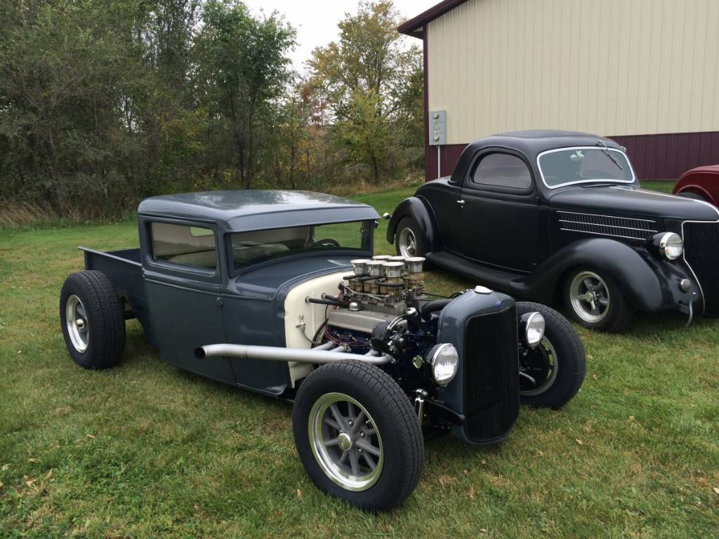

    Joined: Jan 14, 2003
    Posts: 2,084
    BigChief
    Yup....we like them. Did a couple 364s, 401s and this nice gem. 20181120_174750.jpeg

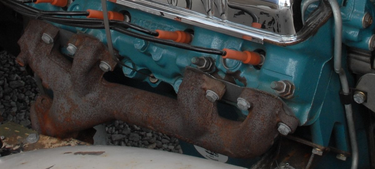

    This car had dual exhaust. It sure looks like it to me. As long as it dumps in the same location as my gasser, it should work no matter what the casting number turns out to be.
    ref 60 electra 225 driver side 1 (2).jpg <==This one was on a 1960 Electra 225 driver's side and it looks to be the same.
    Casting numbers for 1959-1960 Buicks list left side numbers of 1185603(non-dual) or 1186291 for dual tailpipes.
    1961 Buick 364 and 401 engines used 1196457 on left side.
    I was told that many of the LeSabres had single exhaust and they seem to dump in the same location.
