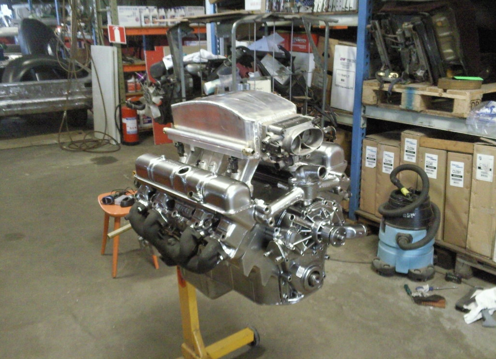

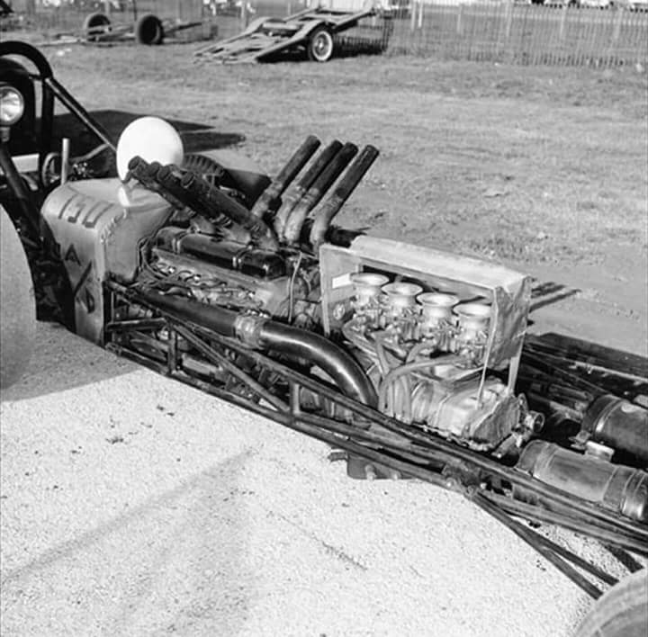

  15. Don if you don't mind, here are a few pictures I have saved on my phone... 5603a00ed26831e3cd6e65c8755f7982.jpg FB_IMG_1478605033676.jpg DSC374584.png FB_IMG_1490399060673.jpg
  16. ^^^^I don't mind at all, Matt, in fact I appreciate them. Thanks for posting them. They do indeed make for a beautiful engine.^^^^.........................Don.
