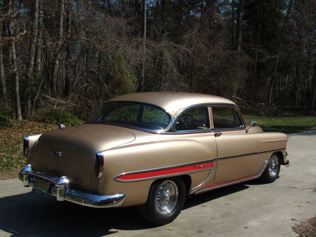

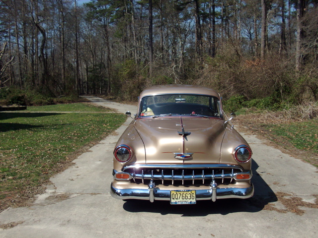

    nice lookin 54

    BTW, nice car there. Take of the front plate, NJ says you don't need it with the QQ's.

    thanks for the replies. i'll check the plugs. but i would think water in the cylinders would show white smoke at some point. your point about when the car gets gas it might be enough to overcome the water in the cylinder is the same thought i had. but instead of water i was thinking the timing or compression was the culprit. i am also liking the bad wire or weak starter theory. i was going to check the starter any way. when cranking the motor it makes a loud screech. Almost like it isn't shimmed correctly. i'll go over that when i get a chance. funny thing is the shop who installed the new motor specializes in auto electric. thanks for confirming my thoughts about fuel and starting systems not effecting each other. i thought i was loosing my mind. i didn't know if lopy cams were a different animal than stock motors. and thanks for the nice words about the car. i said i would never buy another finished car but this one was different. she won a top award at the national show, wheels of the world, back in 85 in washington dc.. its an old school rod all the way. the origional builder spent 20 + years building her. it shows. every day i spend playing with her i find a new detail that the origional builder did. i picked the car up in baltimore a few years ago for my brother in law and found the car was sitting on shag carpet in a storage unit. My only problem with the car is keeping up with the polishing. shes a trailer queen and i am a driver kind of guy. thanks tom
