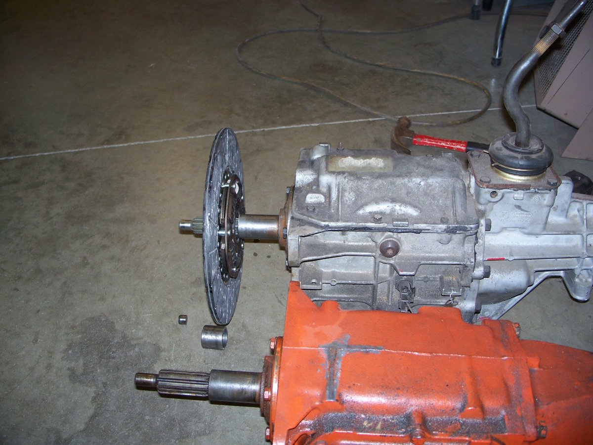

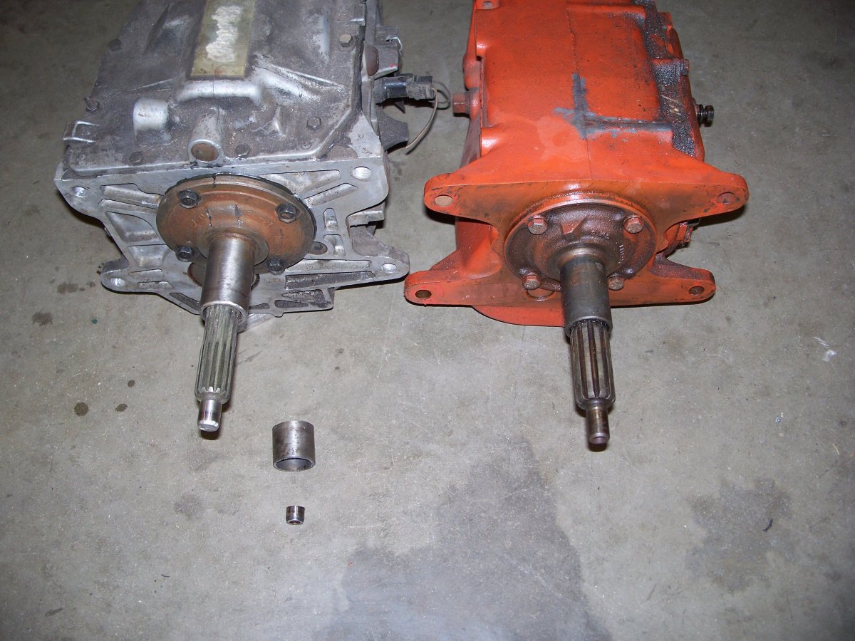

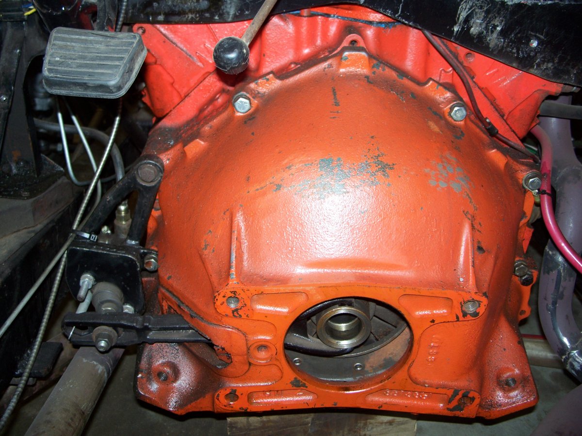

  16. scrap metal 48
    Joined: Sep 6, 2009
    Posts: 6,079
    scrap metal 48
    T5 install 007.JPG T5 install 006.JPG T5 install 008.JPG I've got some pics but I can't remember how much I cut off.. I did have a 3 spd trans to use as a guide.. Pics alone probably won't help but here they are...
    caseywheels likes this.
  17. Voh
    Joined: Oct 18, 2006
    Posts: 1,037
    Voh
    I have looked at those a few times. I believe you indicated about 2" off of the snout. I was given a measurement of a typical retainer being 3-1/8". I have pulled measurements, just don't know how best to translate them, or rather what type of space I need between that retain and the disk.
    thank you for posting the pics
