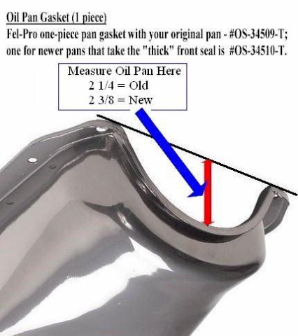

    Ericnova77 posted this picture on another thread. Be sure to measure your new pan before ordering the one piece gasket.

    WELL,,, after taking off the front exhaust pipes because I'm running a crossover pipe and removing the passenger tie rod running under the oil pan, I got the oil pan off... It has a one piece gasket that fits the block fine, however when I lay it on the cheap-ass oil pan it doesn't fit the front of the pan unless you push down on it and then it pulls the side of the gasket away from the holes.. I think Country Joe has the answer.. The oil pan is the wrong one.. The pan I have shows 2 3/8" at the front gasket cut out and I need an old one with 2 1/4" at the front of the pan.. Does anybody have a part# for a stock GM oil Pan, drivers side dipstick for a 1970 350 engine?? Again, thank to everybody thats tried to help... Maybe I'll get my latest project on the road this summer...

    Country Joe
    I posted that picture to show how to determine if you need a thin or thick front seal. But I would go with the gasket Ted Chandler suggested with the single dip stick provision.

    If I change the gasket to fit the pan I have then it won't fit the block.. The one piece gasket I have now is virtually new and fits the timing cover fine and only has one hole for the dipstick..The pan is shit, so I'd rather buy a new Pan with a 2 1/4" depth at front(like an original is).. Then the gasket will fit both the pan and the block... I just don't know how to buy the right pan.. When looking online, the don't list the front depth like you^^^ showed in your post....

    The 2 1/4" pan was used prior to 1975. In the aftermarket, it may be really tough to know what you are getting before you measure it yourself. That is why there are so many different gaskets. You'll get it! At least you figured out why there is a leak!

    Well I couldn't find the correct older pan so I did a little research and decided the old original style pan took a thin gasket and the new style pan(1975-1979) took a thick gasket.. My leak problem was a new style(1975-1979) pan with the old style one piece gasket.. I just received a thick style gasket in the mail and trial fit it to the pan and it fits well.. I'm pretty sure that was my massive leak problem, so I'll get the old chrome pan and new gasket on this weekend and hopefully NO more leak.. I'll also adjust the noisy valves and fix the exhaust leak and will get to go for it's first test drive... I'm excited....
