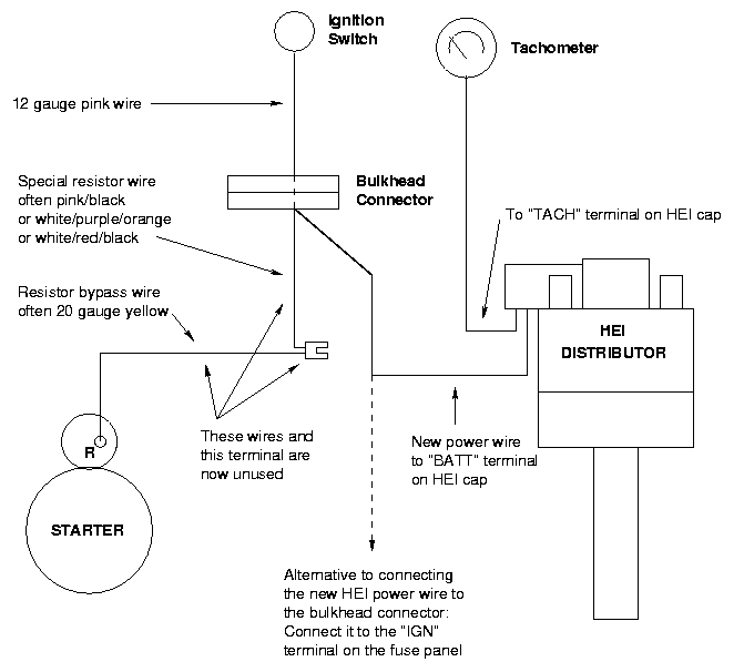

    Check to verify your wire is connected to the Battery terminal under the cap and not the Tach.
    Also check your ignition switch and make sure the wire is connected to the IGN terminal.

    I have a wire from IGN to cap/coil. And a wire from ST, going to the starter.

  12. Not sure if this is your problem but the 1963 ign switch does not have power to the ign. terminal in the start/crank position. That is where the Ign wire on the starter cyl. comes in. It puts power to the coil when in crank mode. This is stock dist wireing. The H.E.I. needs 12 volts at all times. The stock wireing don't work with H.E.I. Go to a late model switch with a jumper from start and run terminals and 12 volts direct to the coil B+ term. also make sure you have a large ground wire from motor to chassis and body.

    Rig a jumper wire from the inside terminal at the cap to the battery if you have spark its the wiring if not the distributor.

    The module must have so many volts to operate at all; if memory serves, it is about 10vdc.
    The battery voltage drops when the starter is engaged. The jumper off the starter is to provide a temporary boost to bring the voltage back up during cranking. The starter solenoid has it's own little stud just for this purpose. If it is a single small stud solenoid, replace it with a two stud.
    I ran into the same problem converting a 69 442 with a 455 from points to hei. Full battery volts with the key off but it would not fire the plugs during cranking. I found the problem by doing as Sunbeam suggested, with a jumper directly off the battery to the cap terminal.

    Now turn the key to on/run and unplug the hei and use a test light on the white or pink wire which ever you have and female spade, it should light up, (you can use a ohm meter and verify 12 volts ) now set the light were you can see it while it is inserted into the plug and turn the key from on to start, if the light goes out, you do not have voltage during cranking only in the run setting of the key. rewire the key or look for a broken/burnt wire from the start pole of the key out to the dissy.
    Another way to test is run a jumper wire from the positive battery straight to the white/pink wire of the dissy, now start the car, if it starts now it will not turn off until you remove the jumper. and you know that the dissy isn't getting voltage during cranking.

    I used a test light and DID have current with switch at ON and while cranking, on the wire from IGN terminal on switch.
    I ran a jumper from the battery to the coil and turned it over with a remote starter and DID have spark.

    I have a thick red wire to the BAT terminal. One from IGN to the cap/coil. And one from SOL, to S on starter
