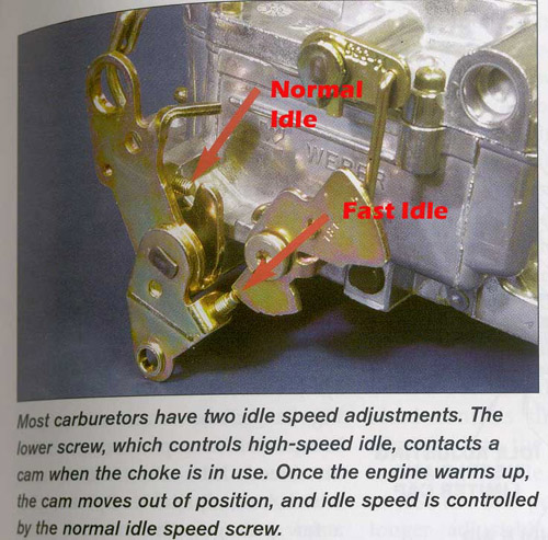

    At this point, you probably only need to adjust the fast idle speed screw down.
    That is shown here:
    Making the part of the screw that is shown stick out farther raises the fast idle. Backing it out lowers it.
    Shown in the picture, the choke is ON, and that screw is on the tallest portion of the cam.
    If you are at 2800 RPM on a "cold" start, I would back the screw out three full turns, and try tomorrow. Adjust from there, as necessary.
    olscrounger and Barn Hunter like this.
