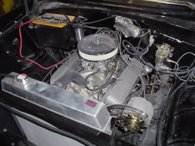

  21. Here's what I did on my "too new 350" with old style non-vented valvecovers.
    I used an older Edelbrock manifold that had an oil fill tube in the front with a
    60's vented/filtered cap. You can't see the filler neck because I shortened
    it and it's behind the air cleaner snout but it's just stock Chevy.
    I drilled through to the lifter galley on the intake manifold's inboard coil
    mounting boss, behind the carb. Then tapped it for pipe thread. Using this
    boss will raise the inlet up away from the floor of the manifold a little.
    Installed a 90* fitting in the new hole. (I had to trim 3/8" off the top of
    the manifold mounting boss as the 90* elbow hit the base of the
    distributor.
    On the underside of the intake where the new hole is, I made a sheet
    metal pan to cover the hole so oil wouldn't get sucked up. The metal pan
    was rivited to the bottom of the intake and fit fairly close. It was about 3"
    square and trimmed to fit the contours.
    Used a "Corvette style" screw-in PCV valve at the base of the carb. Make
    sure your PCV flows the correct direction and make sure it works in the
    horizontal position. I already had the PCV in my spare plumbing parts so I
    don't know exactly what it's from, probably a 1960's Chevelle.
    I had an old 50's remote oil filter so I plumbed it between the new hole in
    the intake and the PCV with some copper tubing. I figured if any oil got
    sucked up, the canister would catch it.
    Works great, doesn't blow oil out the vented filler neck and doesn't suck oil
    into the PCV. Would probably work without the canister. I've opened it and
    there's been no oil inside.
