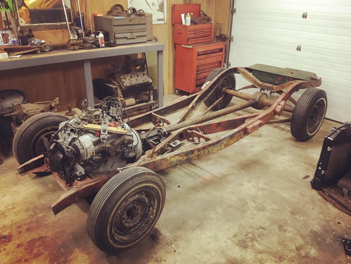

  7. Check out my build thread on my 39 in the red link below. I did exactly what you are asking about and I outline it all. Its an easy swap, if you use the right parts. PMme I’d you have questions. Happy to help out.
    Ralphies54 and LOU WELLS like this.
