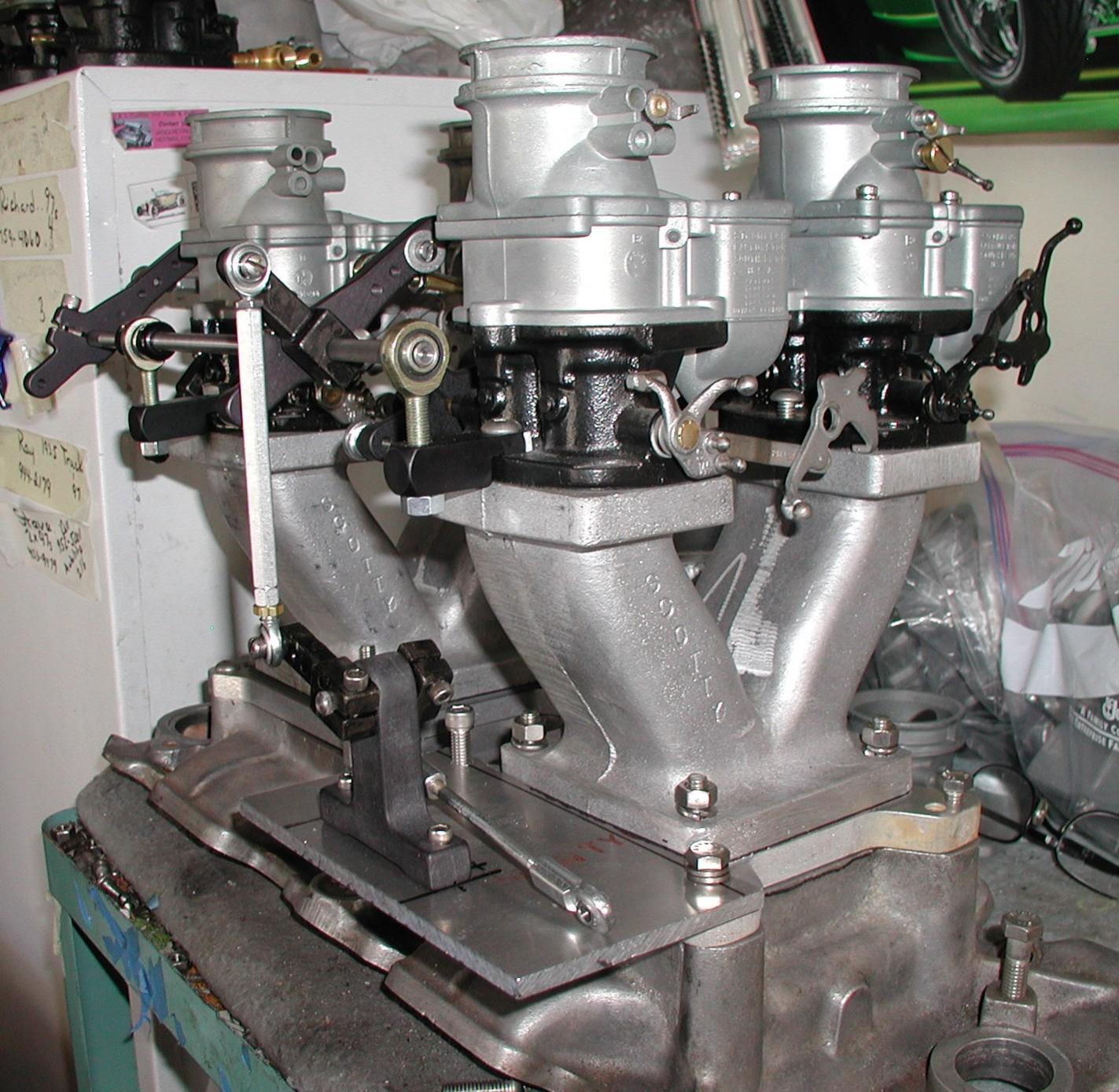

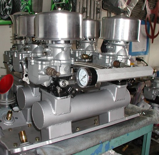

    Here are a few that are different..
    Duane.

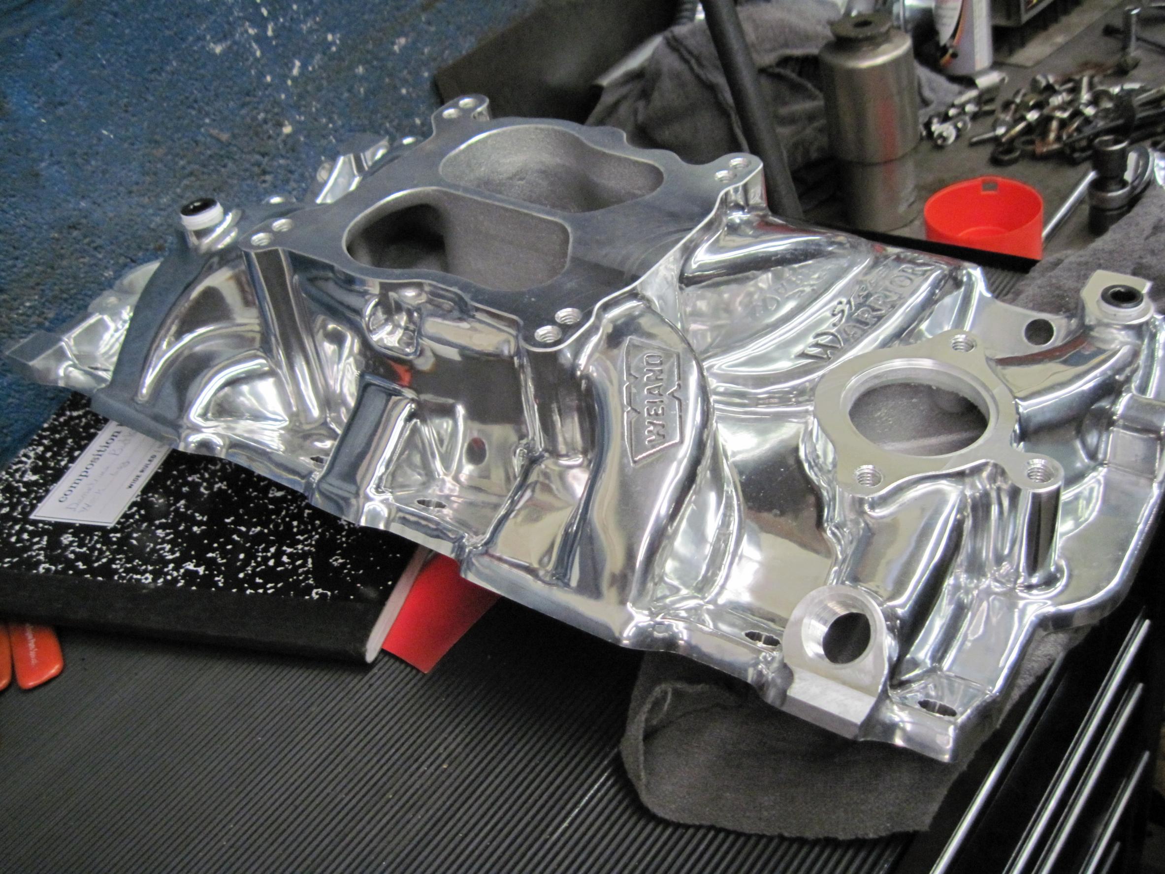

  27. pokey
    Joined: Apr 3, 2009
    Posts: 217
    pokey
    Finally got you some shots. The intake only cost about 211.00 I can't wait to hear this cam.
