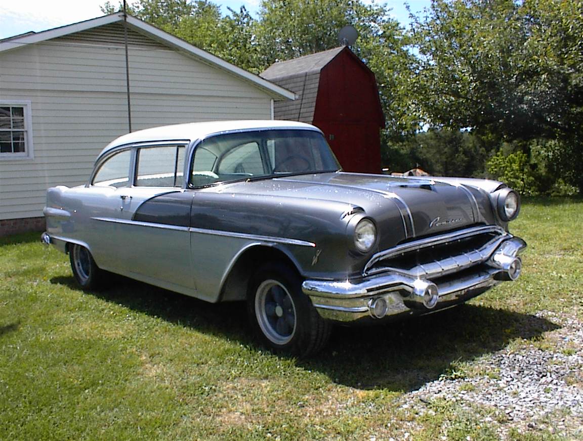

    I had a 56 Pontiac daily driver a few years back ,but mine had the 317 in it still with a 3 spd on the column.As far as using a SBC you may be in for sum troubles.If i remember right the master cylinder was in a bad spot and the weirdo motor and bell mounts were in strange places ,and might cause exhaust interference problems.Even though they are GM products they did alot of goofy stuff on Pontiac in 55-57 that they didnt do on Olds ,Buick ,etc.Things like the pedals still coming through the floor in 56 ,instead of hanging under the dash.BTW hope and pray that the front wheels bearings dont go out.If i remember the inners are "B60" and they are obsolete for over 40 years now ,and fit nothing but 55-57 Pontiacs according to a Hollander i looked at.I ended up getting used ones from a donor car in a pinch .I loved the car ,but was having Hell keeping it on the road as my daily ,because of the parts avalibilty and sold it .Not trying to discourage anyone ,but thought i would share sum facts about the Chassis parts problem with them.Im sure the SBC switch can be done since they are both rear sump motors ,but it may not be as easy as other models ...
