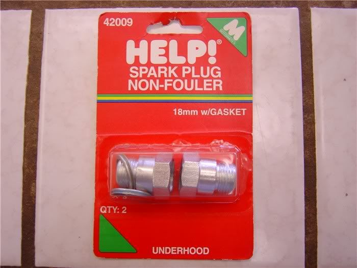

    Like mentioned carry some oil and maybe get you some of these if you start fouling plugs.
