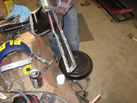

    The inner fenders were primed and painted with Rustoleum paints.

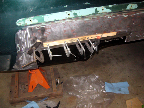

    Two inch metal strips were cut to size and ground with 36 grit to provide a good surface for the glue to stick to.
    The metal strips were clamped with a combination of #4 pan head screws and clamps. anywhere that the inner fender was too close to the outer fender panel the screws had to be used. Anywhere that a screw was used the fender panel was drilled out with an 1/8 bit. The resulting hole was a larger diameter than the screw. This was done on purpose so that the screw would be used as a clamp while not distorting the body sheet metal. This picture was taken during the prefit of the strips. The burs form the drilling process were also removed from the back side of the panels during this prefit process. Don also pre drilled the holes for the #4 screws in the base metal.
    The inside of the 1/4 panels edges were also ground with 36 grit and the panels primed and painted.
    This is the adhesive used in this project.
    The glue is pretty strong smelling so we used or masks and also turned on the exhaust fan.The adhesive was applied to the metal strips with a borrowed gun and then spread with an acid brush.
    Some paint stick and clamps hold the strips of metal in place.
    You can never have too many clamps..... I originally thought that we might be using too much adhesive . I thought that we would have glue oozing out everywhere but there was not much oozing and what there was, was easily cleaned up with a square blade exacto knife.
    We let the strips set over night. There was plenty of time to work with this adhesive.

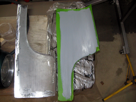

    The panels are now fully prepped. The screw holes were drilled on 3 inch centers along the top. Closer on the vertical run at the back.
    The metal strips were left clamped overnight and when the clamps were released we found that they were all glued nice and tight.
    Don then did the predrilling for #4 pan head screws. The screws then were easy to install with a screw driver.
    trial fit complete and ready for glue.
    Adhesive was applied to both the strips and the panel.
    We didn't use any screws on the flanged edges. The paint sticks were used to keep from dimpling the thin sheet metal with the clamps.
    After letting the panels dry for two days I went about removing the screw heads. I tried using my trusty dremel tool first. Even with a practiced light touch it was still hard to grind off he heads without leaving some small grooves in the panel.
    So I switched to the air grinder with a a small 50 grit sanding disc. This method yielded better results. I was careful to sand just a few seconds at a time on each screw moving back and forth among several screw heads so as to minimize heat build up in the screws.
    So there it is, ready for some bondo. I forgot to mention that we beveled the sheet metal edges a little on the body and the replacement panel so that there would be an area for the bondo to go for a better mechanical lock and to ensure we did not have a sharp edge sticking out. Overall we ended up with a nice flush fitting panel with no warping. This is why we chose to go with the glued on panels instead of welding them. We were concerned that the mig welding process would have caused some warpage and that we would not be able to get to the back side of the panels to work the weld area.

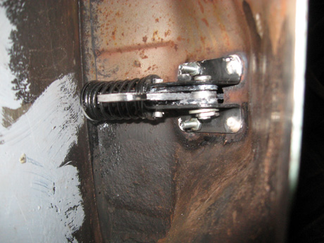

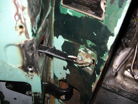

    Ok the quarter panels are done so we moved on to fitting the door gaps. The first thing we decided to address on this project was the door stop mechanism. The assembly had gotten quite rusty over time and one of the two wheels in the mechanism quit rolling on it's shaft and as a result developed a flat spot.
    This a pretty bad picture taken inside the door. In the center of the assembly you can just make out the rusted wheel.

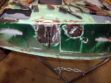

    We decided the only way to repair this assembly was to remove it from the door. The assembly was spot welded to an inner panel of the door.To get to the welds we had to cut the outer door skin away.
    I used my trusty dremel tool to cut the panel.
    Drilled out the spot welds.
    Here are some views of the rusty assembly.
    A little time in the bead blaster was needed.

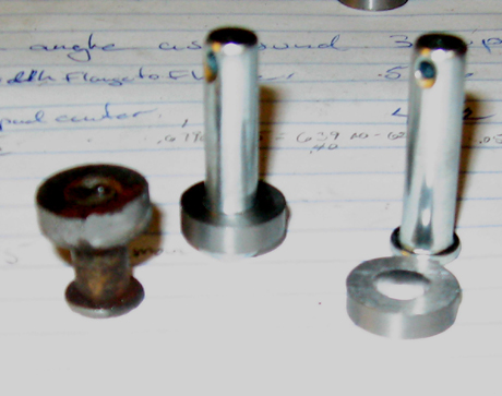

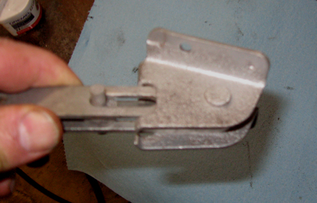

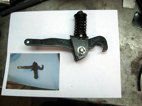

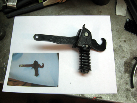

    After blasting we could see that the wheel on left was rotating ok . The rivet on the right on the right is actually the end of the shaft that the frozen wheel was on.
    The shaft end was larger on the oher side ( 5/16").
    After a couple of tries I was able to make some new wheels from some roundstock I had on hand .
    The pins were a hardware store item. They were a little long but I was able to shorten them and drill a new hole for the cotter pin. The hole in the bracket had to be enlarged on one side for the pin. I have a lot of drill bits including fraction,number and letter but none of them were close enough to fit this pin so I had to finish ream it with a file. Had to finish ream the new wheel holes too.It took two of us to get the spring on.
    You can see the new cotter pin and washer here replacing the riveted shaft assembly.
    Litheum grease was applied to the wheels and shaft during assembly.
    There were two holes in the inner panel that I used to insert some 10-24 screws to hold the assembly in place while I plug welded the assembly through the original spot weld holes.
    These are not pretty mig welds but they should hold the assembly in place.
    I used some magnets to hold the outer skin while I ack welded it in place.
    Well here we are several hours later back to where we started.
    We have been working on the door gaps since installing this repaired stop mechanism and it is working well.
    A final inside view. This is one of those projects you don't typically think of when you start rebuilding a car that can eat up a lot of time. I figure it will be well worth it though as each time Don gets in the car the door should open and close without a lot of creaking and screatching. I don't think these parts are available in the aftermarket but thankfully they are not to hard to reproduce.

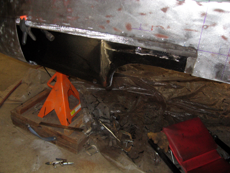

    So it's been a couple of weeks since our last post. We spent most of the time fitting the doors. The drivers door gave us the most trouble. This car has taken a pretty heavy hit in the front end which was not fixed very well.The doors were tight to the B pillar as in no gap at all. We worked over the doors first correcting contours as best we could and then proceeded to fit them to the car.
    After trying everything we could think of including elongating hinge holes and trying every combination of hinge position we still were 1/4" short of aligning with the rocker panel. These are new rockers and we had installed them to fit the inner structure supports in the body so we thought we had installed them correctly. We should have had the doors on the car when we installed them.... Lesson learned the hard way...
    So the decision was made to slice the rocker with the trusty dremel tool and spread the rocker the needed 1/4". 1/4 x 1 1/2" bolts were used as spacers during the welding process.
    I cut a 1/4" wide strip of 18 gauge sheet metal with the HF sheer and proceeded to slowly weld 8" or so long strips into the hole.
    Yes I used a mig welder.It seemed to take forever to weld this strip in. I would a weld little and then get out my air deburring tool and grind for a while then weld and repeat. The weld was left a little rough so that the filler will stick to it well.
    I missed getting a picture of the cut I had to make at the bottom of the A pillar. by the time we got the door fitting good in the hole we had some interference here so out came the dremel and the dead blow hammer to get the required clearance.
    I missed getting a picture of the hinge pocket cut I made on the drivers side but I took one of the passenger side for show and tell.
    You can see that the lower hinge was rubbing on the hinge pocket so we made the cut, pried it out then filled the gap.
    I missed getting a picture of the mod to the B pillar we sliced the quarter panel in the door jamb area and pulled it out to match the door contour.

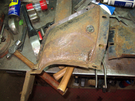

    So here is a fun project. The fresh air intakes were both flattened during the wreck and were not repaired. They just bolted the fenders on over them .
    This passenger side one was especially bad.
    First thing to was to get them off the car so I could hammer on them. I used my very dull spot weld cutter hammer and chisel to get them off .
    On the bench.
    I get a big kick out of beating something like this back into shape. I spent two or three hours beating on this thing. It was FUN!
    I did some bead blasting and it looks much better. I still have to repair the torn mounting tabs. Will do that next.

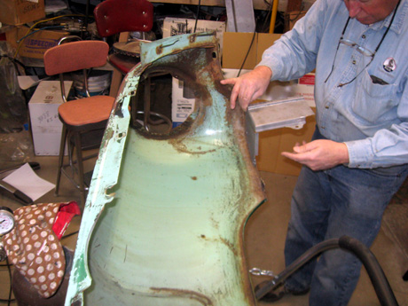

    I have been generally out of action this week but Don has been busy cleaning and painting stuff. He used bed liner in the rear wheel wells.

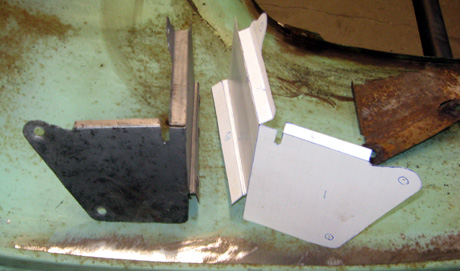

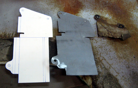

    I did make it out the shop to cheer and comment while Don made a replacement part for inner fender. As usual I took a few pictures to share with you.
    All that was left of this part was the rusty piece on the right. Fortunately the opposite side was salvageable and was used to make a pattern.

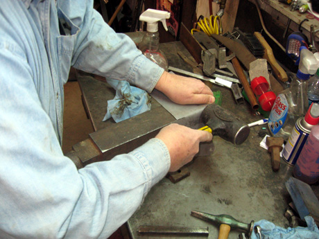

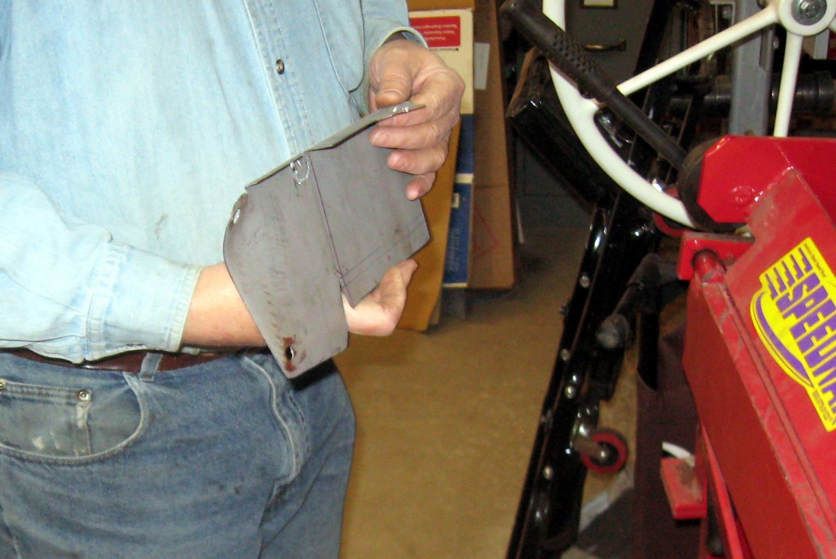

    Don found this really nice pattern card board with 1/2" grid printed on it. I bent the paper to determine the order of the bends.

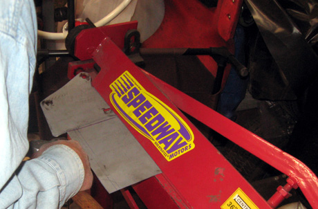

    We started with the HF Break. A project like this really shows the limitations of this tool. A break with removable fingers would have allowed us to make more than this one bend.
    IMG_9709R.jpg Don chose to use some of the sheet metal that we cut off of the new 1/4 panels.
    Since the fancy tools were of little use the dead blow rubber hammer was put to work for bending .
    This compound bend was challenging. It was about a 1/4" offset.Don is using an aluminum wedge with the end flattened to about 1/8" to start the bend.
    Then a little hammer work on the anvil.
    Patience and more hammer work finishes it off.
    The result is a mirror image of the sample piece.
    It goes somewhere around here.... Looking at the picture I am not sure he is holding it in the correct orientation.... Well we will figure that out later.;)
