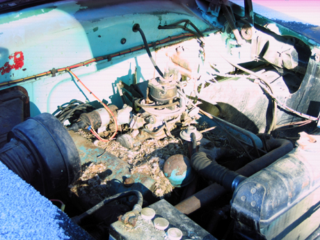

    Although the seats were there they had acquired some resident pack rats over the years.

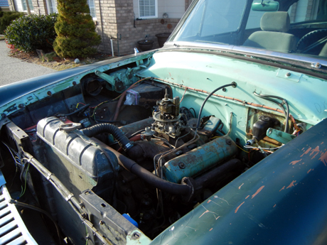

    The engine bay had it's share of nest materials.... Don brought the car home and did the disgusting clean up job. Apparently he brought home at least one of the former inhabitants. Don eventually discovered a nest in his crawl space and had dispatch the cute little pest.
    The car had been rewired at some point . The wiring was done very well. Don got the old motor running and reports that seems run better the more he drives it. The seat springs were saved but had to be stripped to frames. Some temporary bucket seats were installed.
    Don's plan was to keep driving the car while the sheet metal problems are being addressed. He will address the the drive train later.

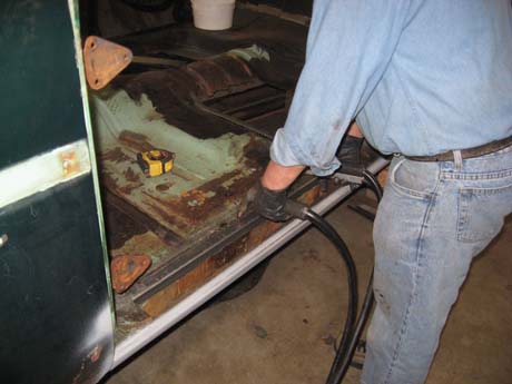

    The spot welder worked well as long as there was sound CLEAN metal with no space between the panels. Gaps or rust would result in blown out metal (holes) IMG_4907R.jpg

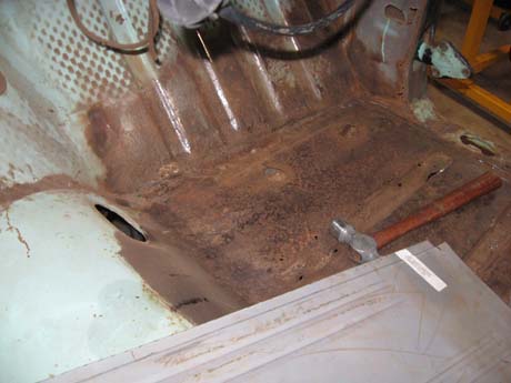

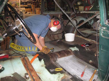

    That's a good buddy (Jeff) that crawled under the car and ate some rust and dirt for the cause.
    The floor supports or braces were pretty rusty . Replacement pieces are available for these but we decided to fabricate our own.
    The two sides were bent in the brake and screwed to 2x6.
    The center section was then welded in (top and bottom).

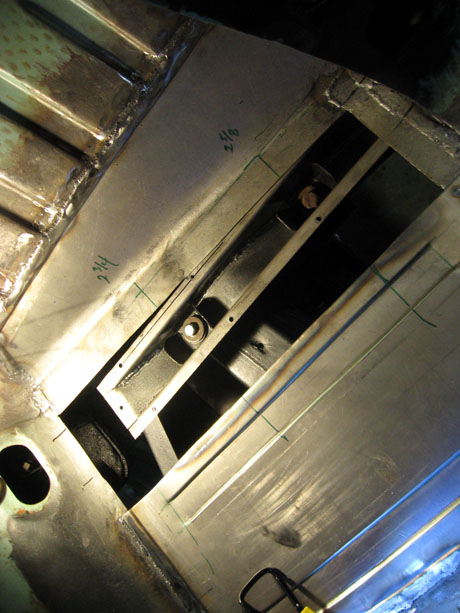

    Whenever possible the frame and various supports were painted with por 15.
    These winged gizmos are installed to keep the fasteners from getting lost in the support during installation.
    Here is a brace ready to have it's floor patch installed.
    Patch sizes varied, so did the techniques for making and attaching the panels.
    The rocker panels had to be re-contoured to fit the car.
    It took awhile to figure out the location for the support bolts. Now I would use a clear piece of plastic cut to the size of the steel panel to locate the hole and then transfer the location to the steel piece.

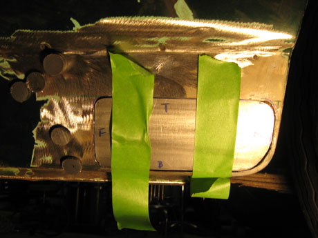

    We rolled these wide stiffening beads on the bead roller by making a couple of passes with 5/8" dies.

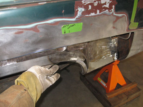

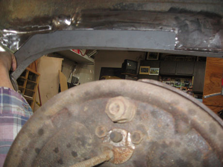

    DS rocker just in front of the rear wheel was in need of repair.
    The structure under the patch was pitted but sound enough to use. It was cleaned and painted with Por 15.
    We had to shape a small piece for the patch. We used the english wheel for the contour.
    We used the easy grind weld wire and the mig for this.My welds were nothing to brag about. I have done a lot of sheet metal welding since I did this weld,although I have gotten better at it I still it a challenge. I am glad I am good with grinding and sanding. We finished butt welding the whole perimeter of the patch. I took my time not allowing the metal to heat up and warp the panel.
    A bad picture of the results but it came out OK.

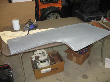

    So lets start covering the quarter panel repairs.
    DS quarter panel, straight but rusty.
    Don bought the quarter panels from Mac's. As with most sheet metal panels offered these are better than nothing and can usually be considered a place to start your project.

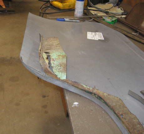

    Yep needed replacing...
    Next was the inner fender. Another of my favorite tools (sawsall) was employed for some of this cut.
    So when you put the cut off inner fender up against the new panel you can see how far off the radius was.

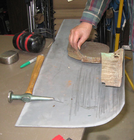

    Several tools were used to get the radius correct. The HF English wheel and a the piece of pipe you see here. The pie cuts were necessary to get the radius corrected without distorting the flange.
    You can see the radius is much better. The lines on the panel are from the English wheel .
    A piece of 3/4" copper pipe flattened and bent to the contour of the panel was clamped in place.
    Several tack welds later......
    Some grinding and sanding and we have a new corner.

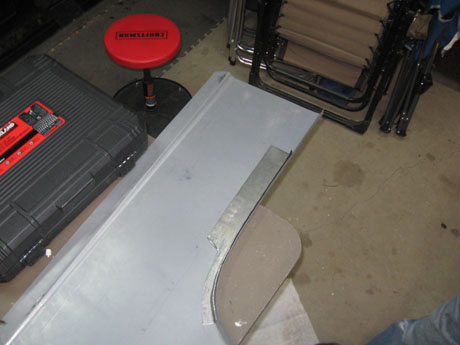

    As far as I know nobody offers a replacement inner fender panel for these cars so we had to fabricate them from scratch.
    We bent a 90 degree bend and started shrinking some bend in.
    Test fitting. Lot's of test fitting.
    After getting the the compound curve we needed we welded in another piece to fill the gap.
    New metal is so much easier to weld and finish than that rusty old stuff.
