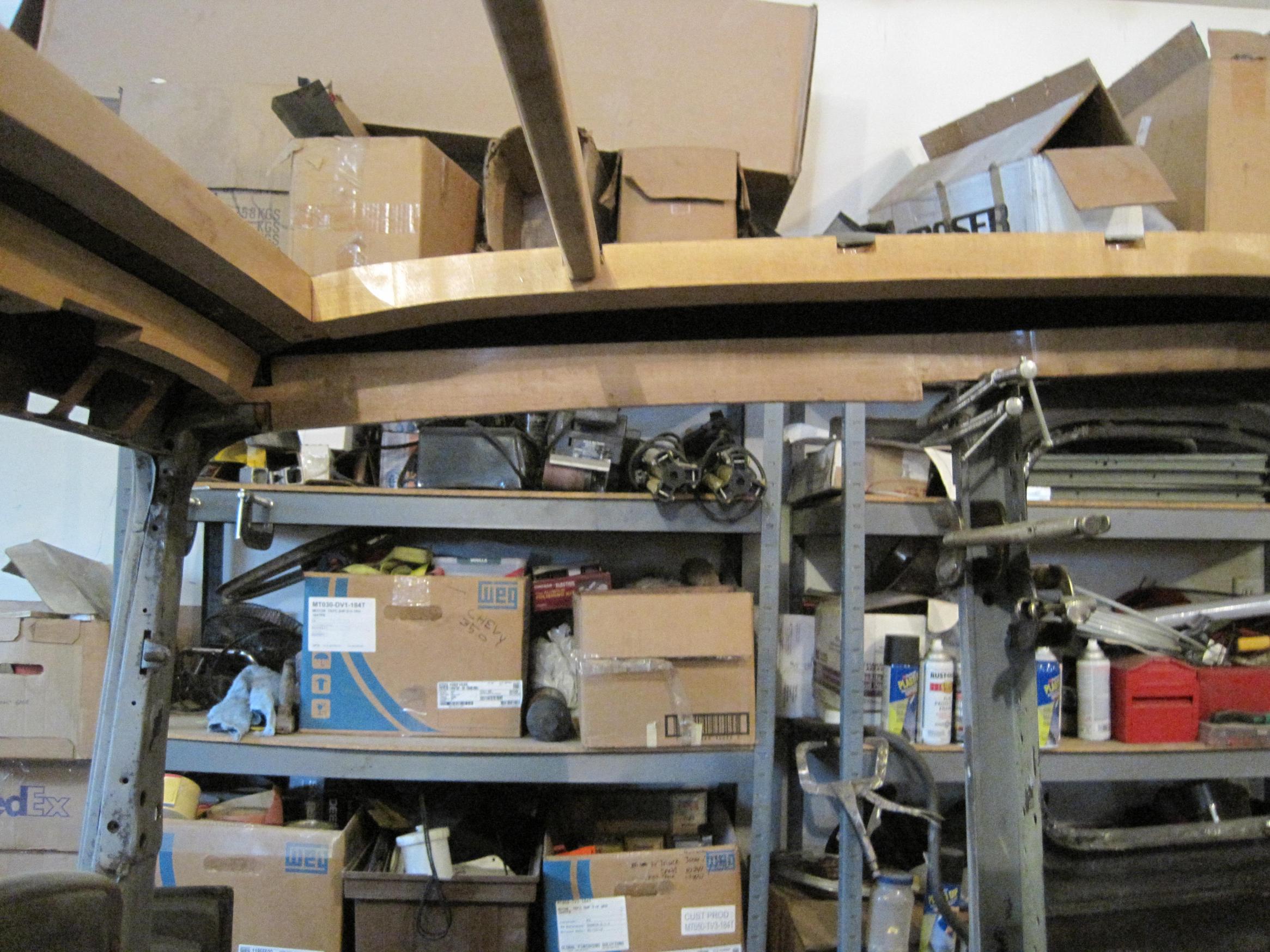

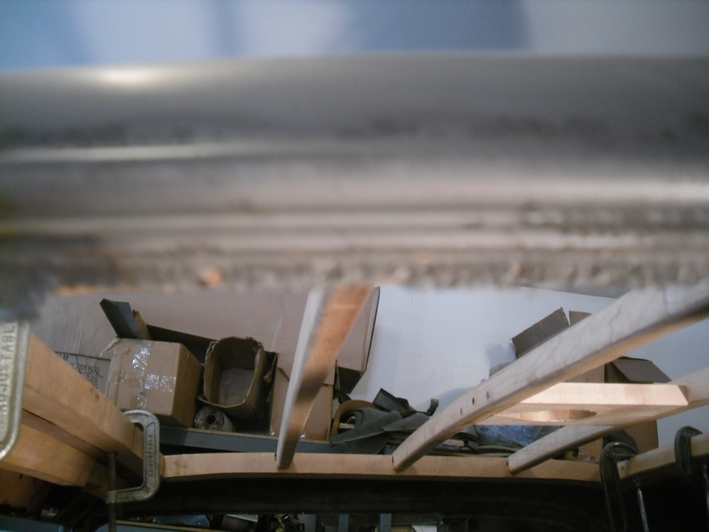

    Test fitted all the wood . Spent most of 2 days fitting the quarter window , roof, header and roof wood.
    Assembled, fit and 2 coats of clear urethane sealer.

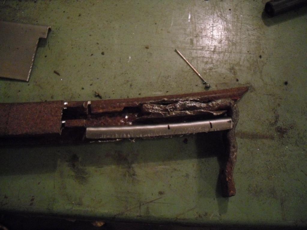

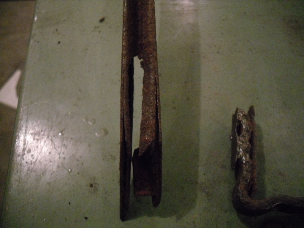

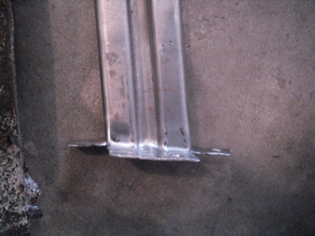

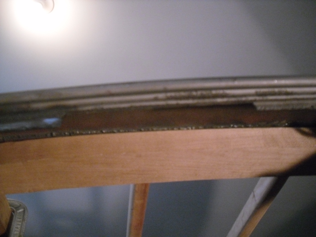

    The inner door opening on the left side had rusted very badly and a couple areas were in dire need of replacing.
    Very tight quarters.
    Thought I had more pictures , but the process involved replacing in segments so I could retain the proper curve. Also allowed me to have some to clamp to as I moved along

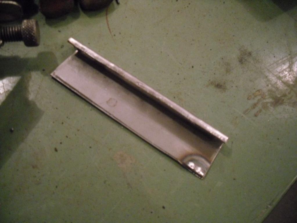

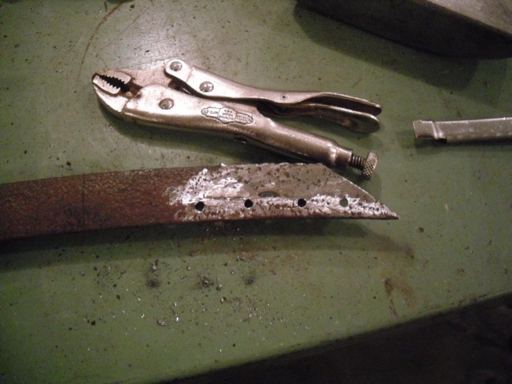

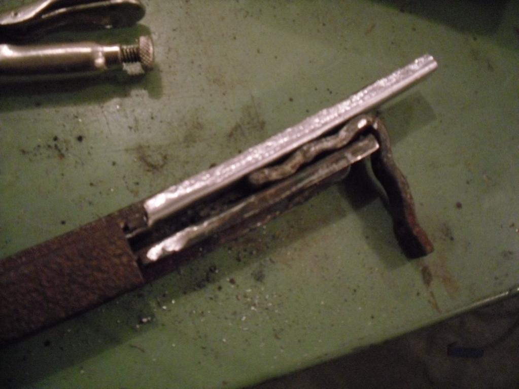

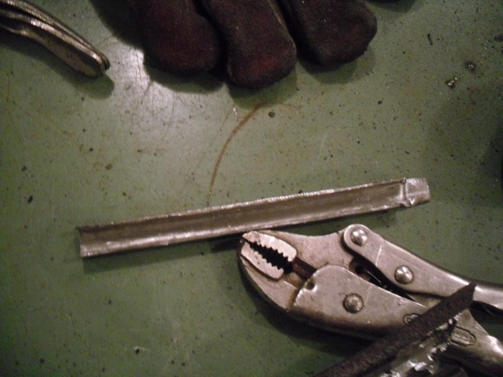

    Also made a new rear deck lid latch, the one I got with the Brookville latch was steel.
    Wanted a stainless latch.
    Started by modify the original, the latch section was a bit short.
    Then I made a pattern out of paper, copying the part dimensions in paper.
    cutting the part out of stainless and bending it in the vise
    and finally the finished part.

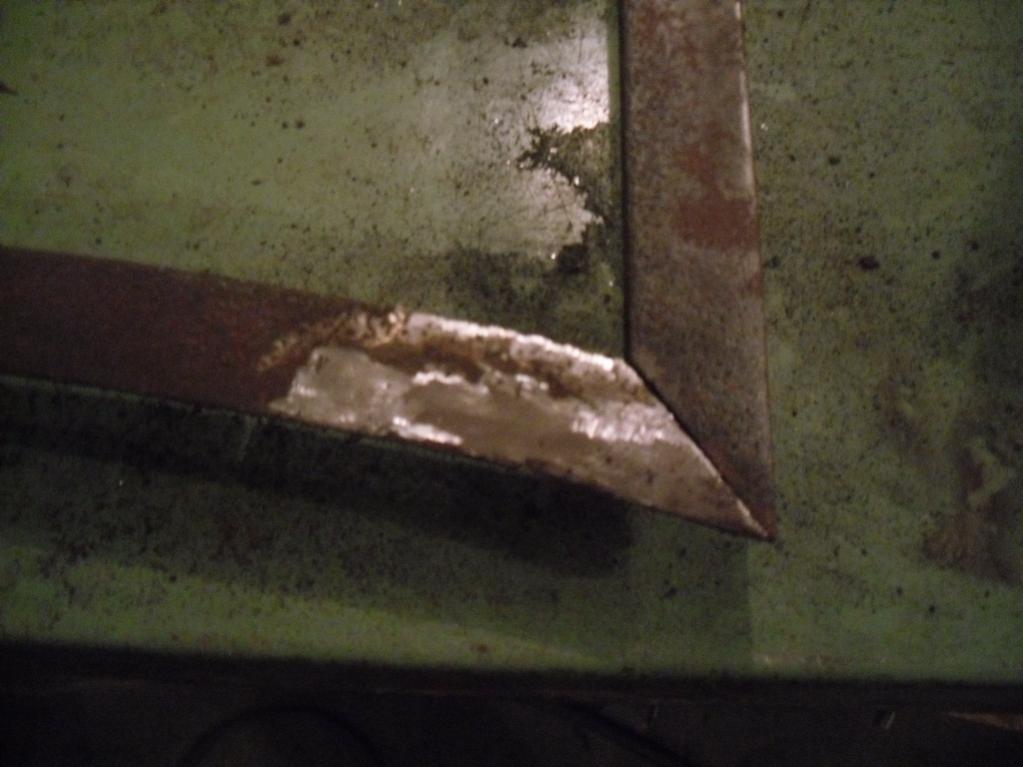

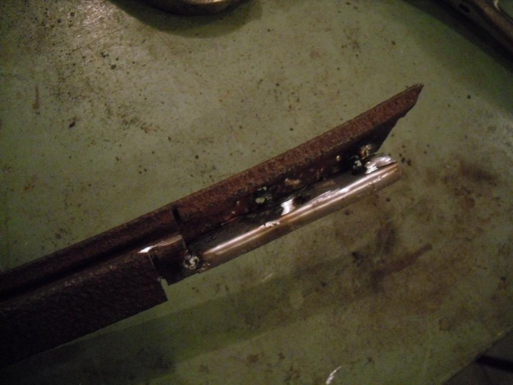

    Replaced a section of the door where I had shortened it . Was not happy with my original work.

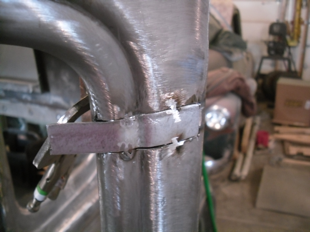

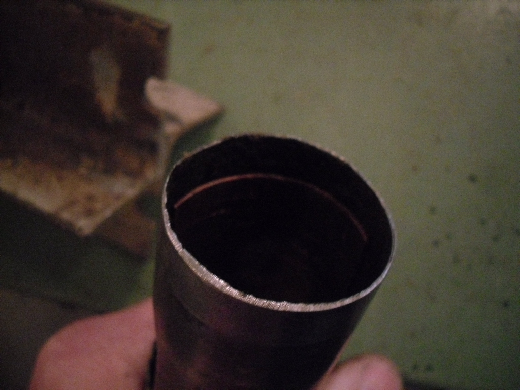

    Also have been working on the steering column and column drops.
    Here is the process of replacing the section of column mast that was rusted.

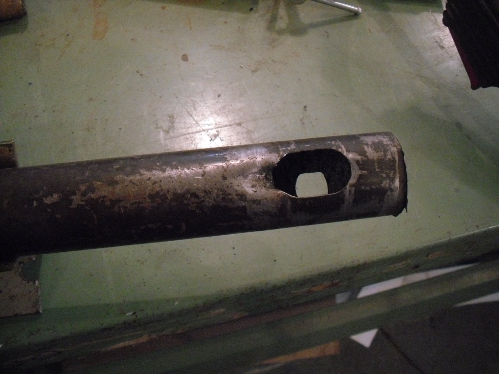

    started by cutting out a 1 1/2 section of the mast.
    Then I cut a section to match.

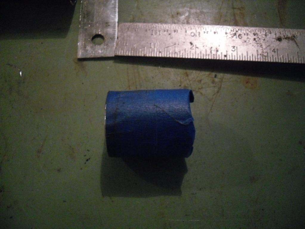

    I used a socket to hold it square, to make it a tight fit i used masking tape.
    I then clamped to in a fixture made from to pieces of angle iron. This holds everything while I weld the tubes, works great the mast can be checked with a straight edge.

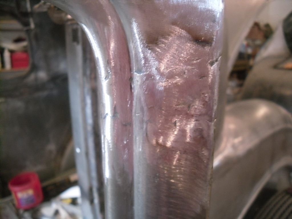

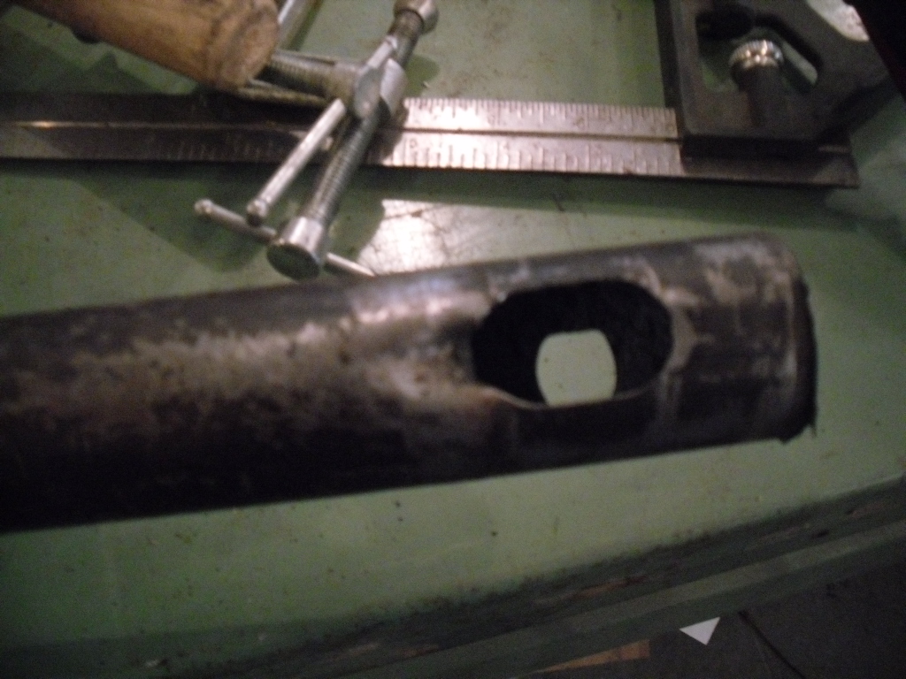

    The mast had a wicked dent where to column lock opening was. I used a pipe slightly smaller the the inside diameter of the mast, starting by driving the pipe into the mast.
    Then I clamped the pipe in vise . Using it as a dolly and hammering the remaining dents with a flat hammer. Turned out pretty nice.

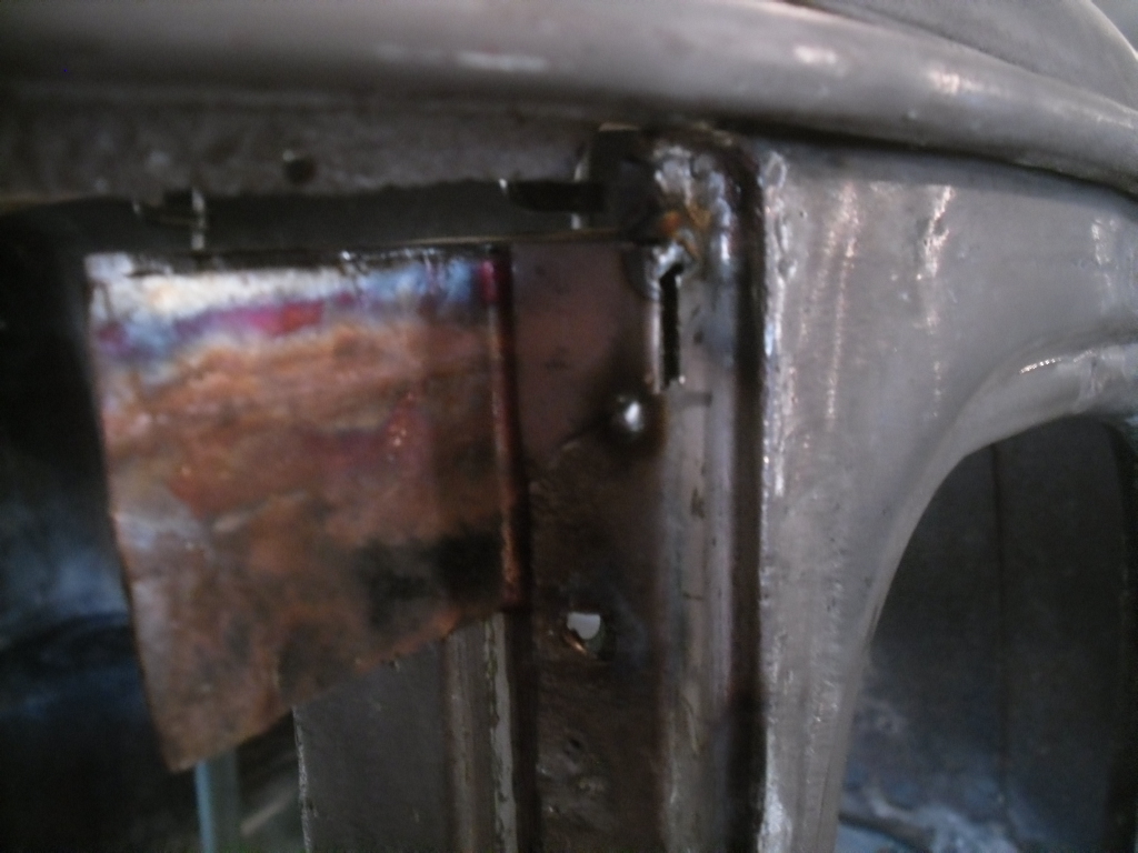

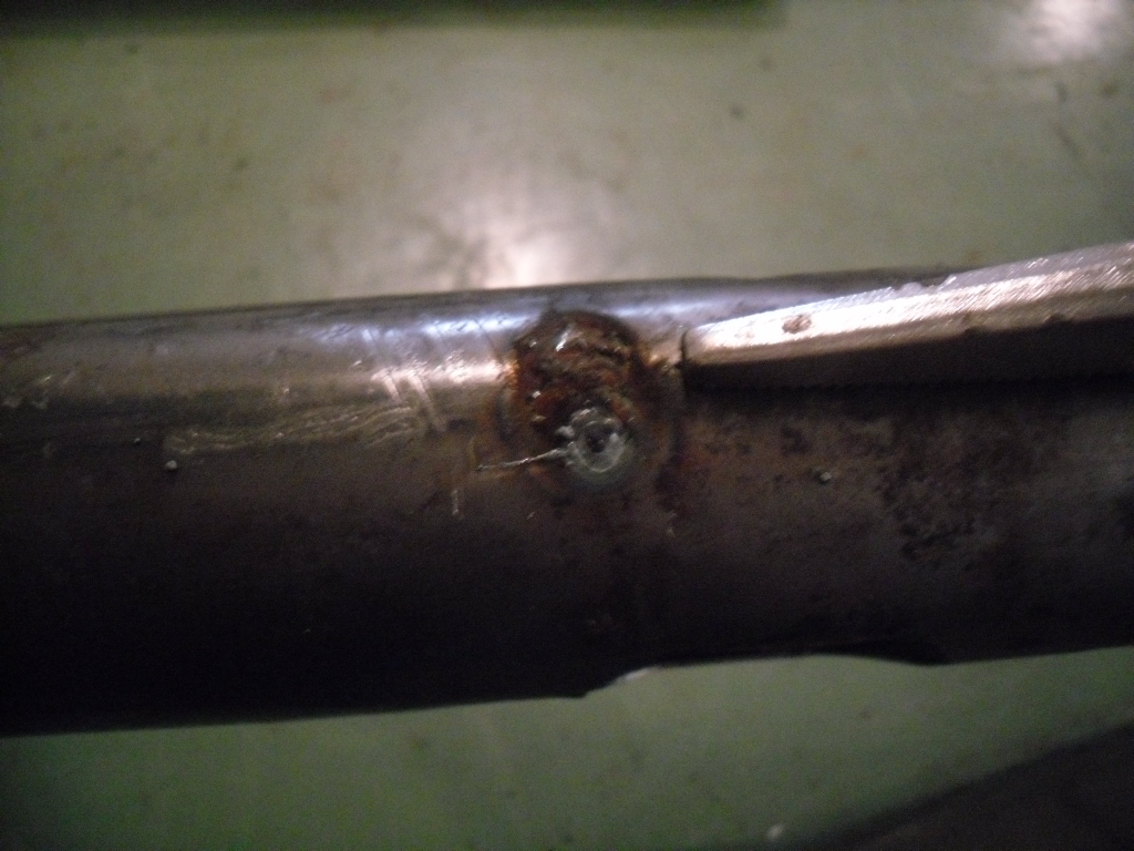

    next filled a small small hole in the mast. I used copper, bent to fit the inside of the mast , as a backer before I welded up the hole.
    This keeps the welder from burning holes from the heat. I use this almost everywhere I weld. Also leaves the back side of the weld flat.
    Then I metal finished the weld.

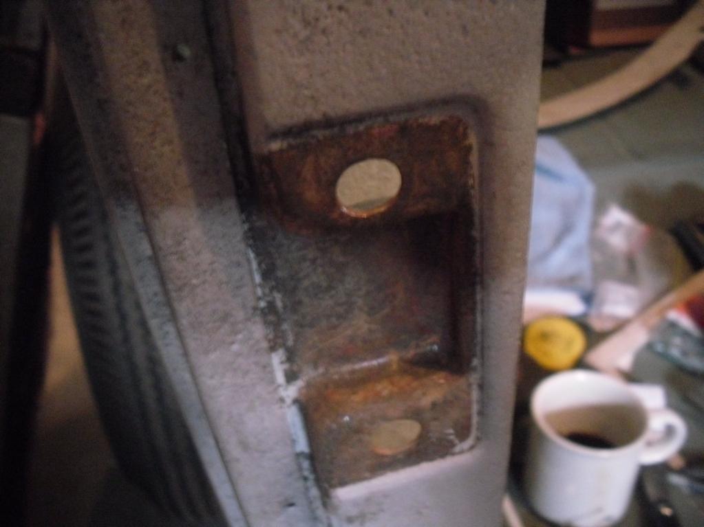

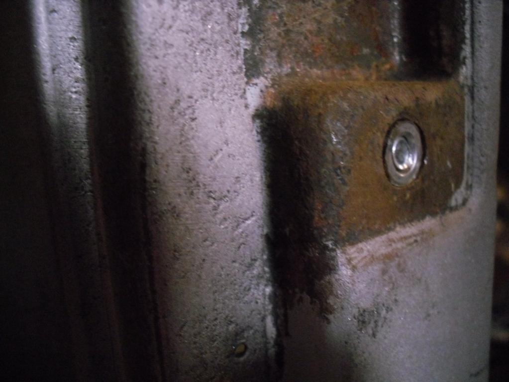

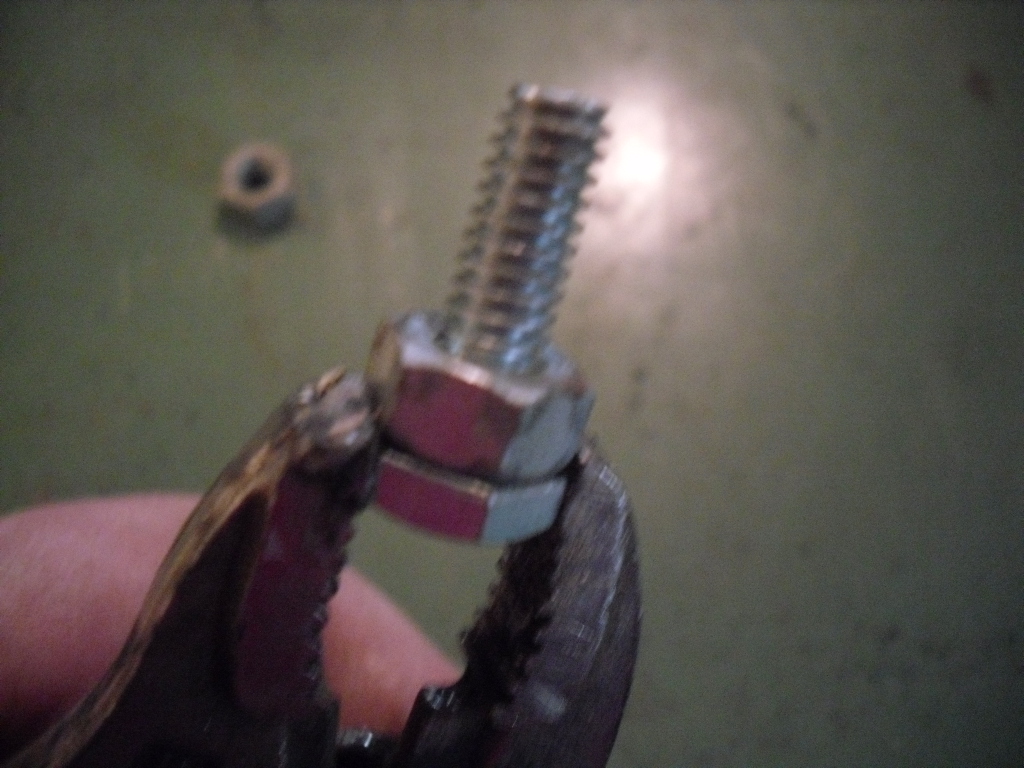

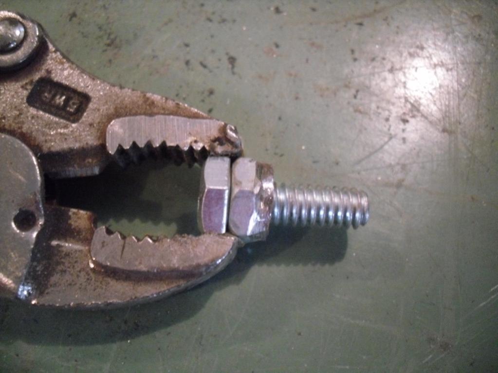

    Another small project was welding the kept nuts back into the door post on the right post. These nuts are thin, and welded in from the factory as they are not accessible once the wood is installed.
    I started by screwing the nut that fit onto a bolt. This allows me to hold the nut as I grind it.
    I then ground the nut so that it fit into the hole on the post. This duplicates the nut made by Ford.
    I then tigged it in place. Note I left the bolt in the nut while welding it, this keeps the nut from distorting from the heat.

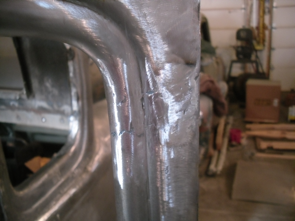

    Well I have not been able to buy a new windshield frame so I thought I would see if I could fix the old one I have.

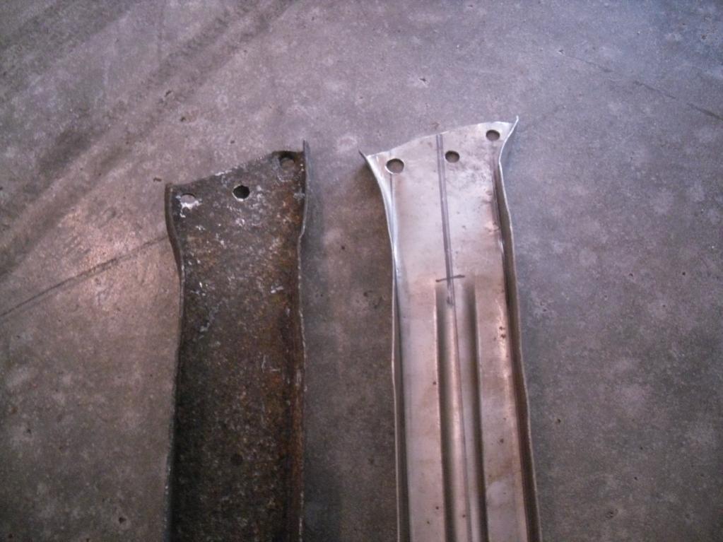

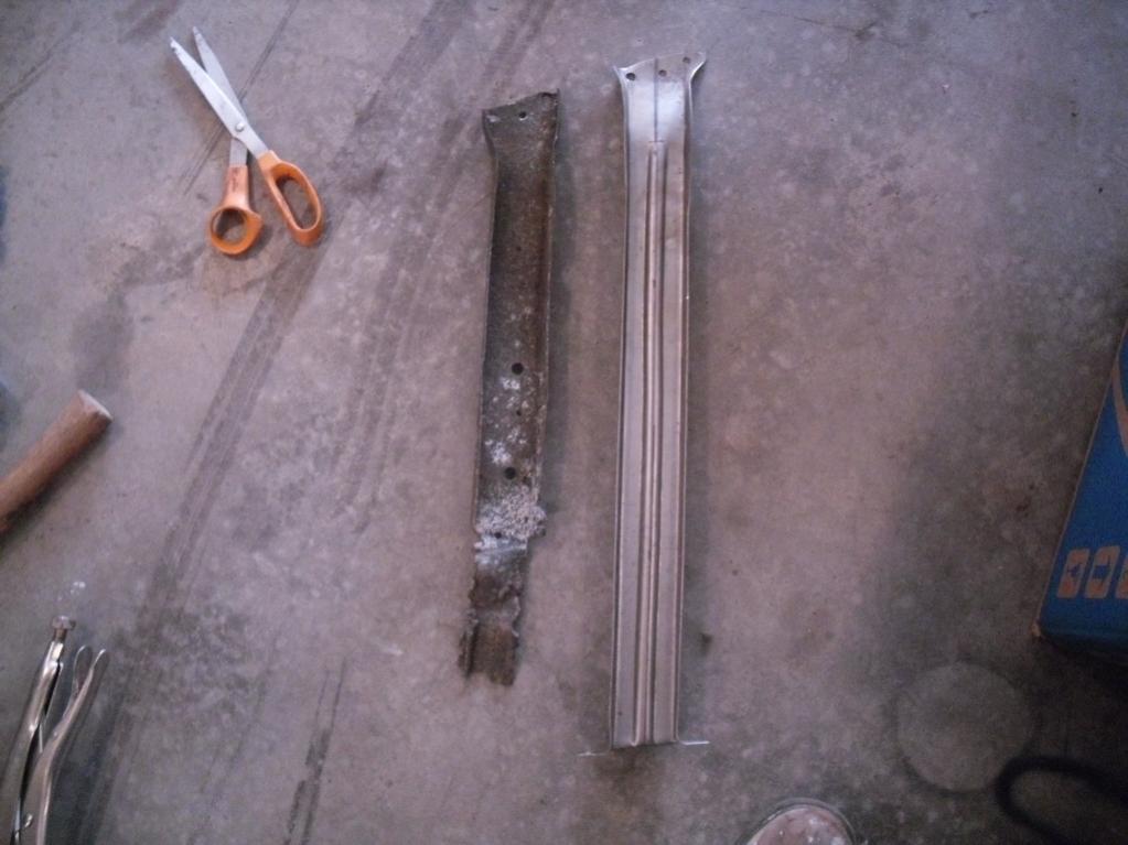

    Finished the inner qtr supports, never posted pics.
