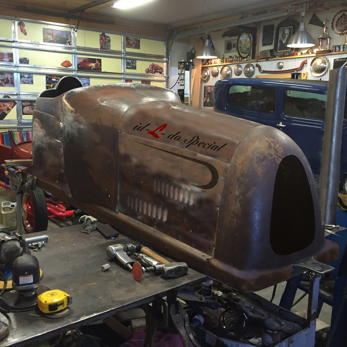

    I didnt have time to do squat today except get a ruff cut on the tank. IMG_2305.JPG IMG_2306.JPG IMG_2307.JPG IMG_2308.JPG IMG_2309.JPG

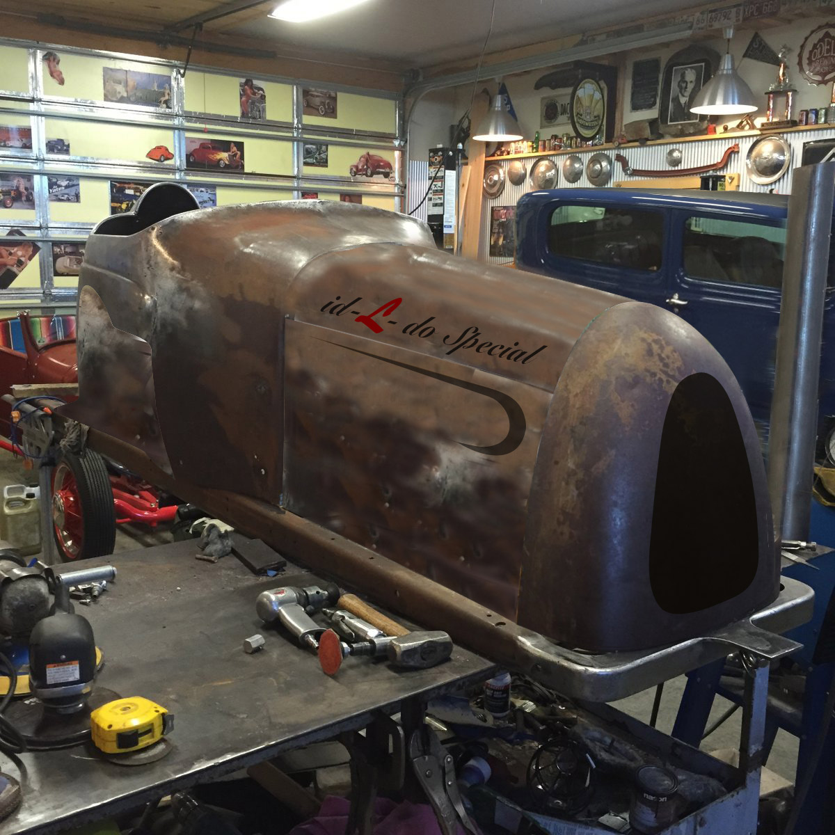

    @rusty rocket a couple more modded pics to motivate creative thoughts. The shell was dropped more as it seemed to high...Could be photographic tricks...You are really moving along...;)

    Right On Stogy, You are correct the shell is to high. Like I said all I had time for yesterday was to ruff cut it. I just wanted to see what it was going to look like. Im really liking the renderings. Shoot I feel like one of those big guy builder with my sketch so I can show everyone what direction we are going!:)

    At a glance, the lettering looks like "I'd-L-Doo", which I don't think you want!
    My two cents would be
    "The It-L-Doo Special".
    Stogy likes this.
  9. Stogy
    Joined: Feb 10, 2007
    Posts: 26,348
    Stogy
    Rusty can call the shots on the slang word combo...I get the saying and I added the apostrophe in error, which I did edit out. I also dropped the Capitol script "I" to a small "i" due to it looking like a "T". Bit O Hee Haw Kinda Goin on thar Aye...:D...We's goin on inventin words and sayins. Wonder if Rusty's got a Straw Hat.

    No Stogy I do not have a straw hat. If I do letter the idLdo it will be some nice flowing lettering on the cowl. I really dont think it matters how it is spelled.

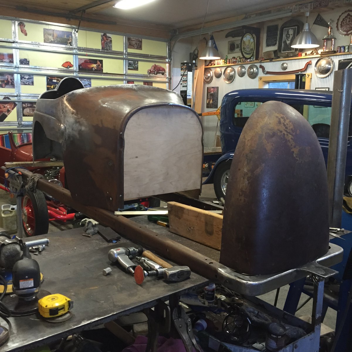

    :D Looking good sir.Was going to mention the nose height also but stogey beat me to it.Looks to me about 3" needs to come off,but what do I know.This do look like a lot of fun,so I`ll saddle up and go along for the ride.

    The picture was taken with just a ruff cut on the nose. I like to sneak up on my cuts. I can always take more off, I dont care for welding metal back on.

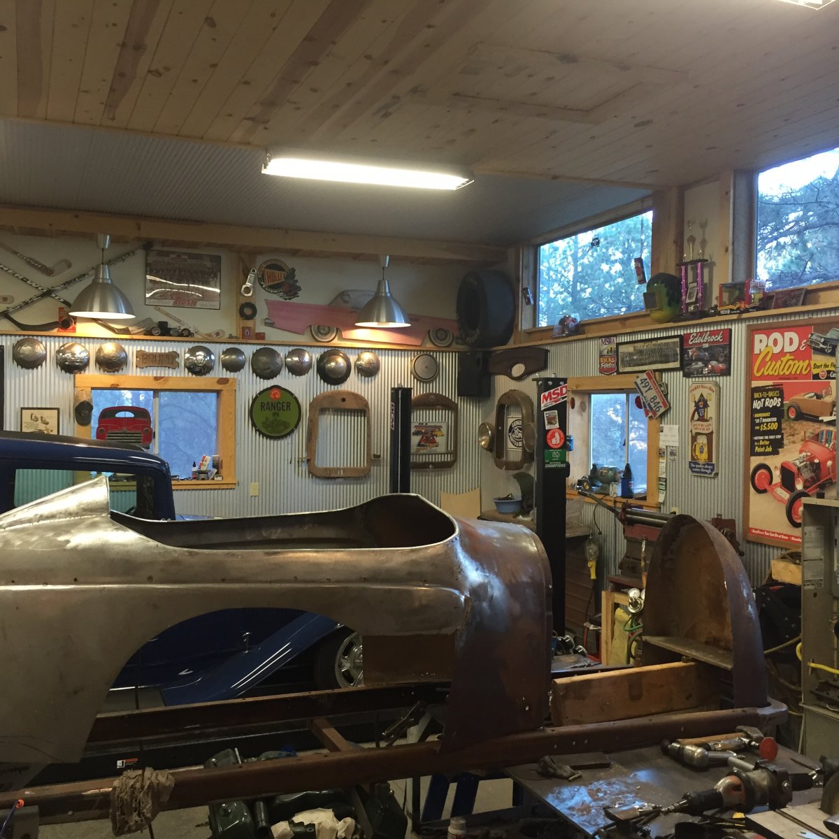

    IMG_2310.JPG IMG_2313.JPG IMG_2314.JPG IMG_2316.JPG IMG_2320.JPG Tonight after work I got my pan built for the tracknose to sit on, all welded and ruffed out.
