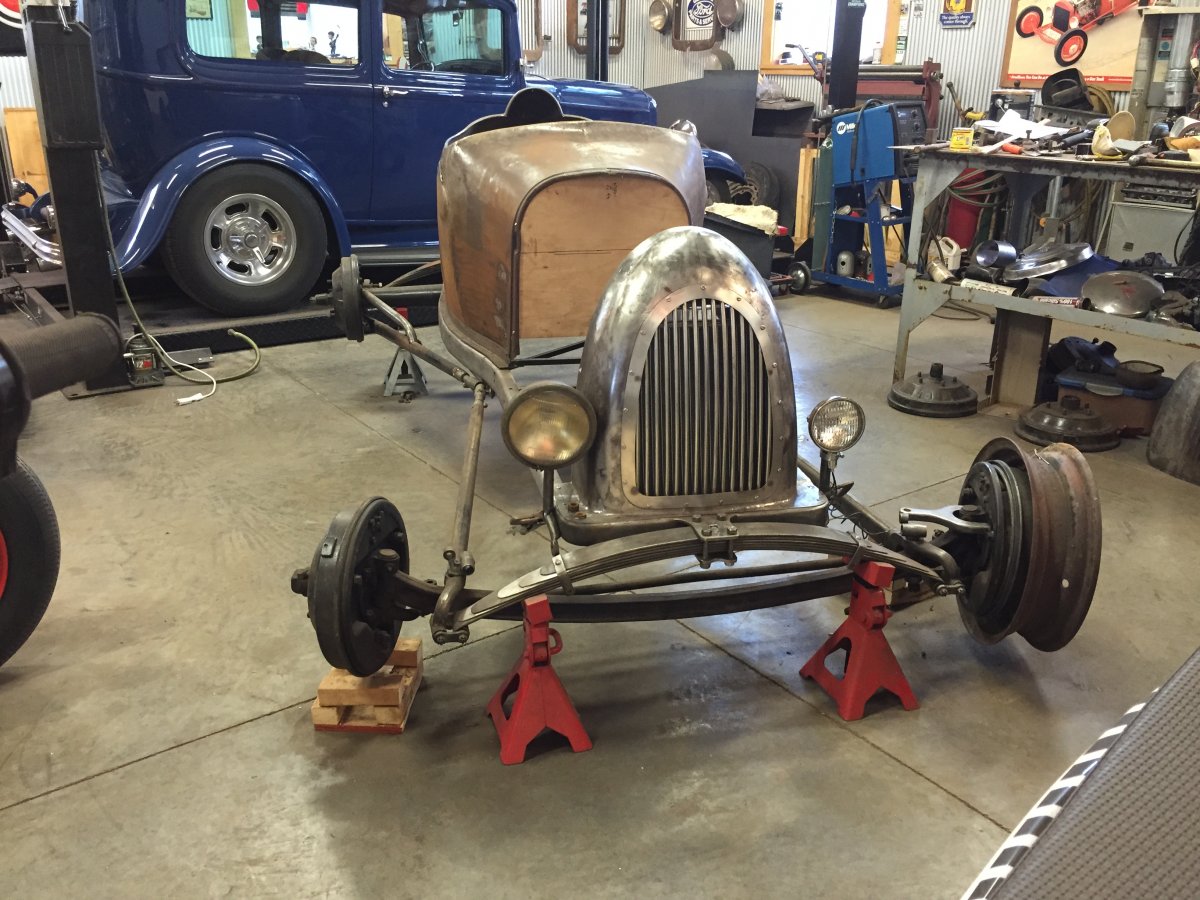

    My buddy and I started getting the six ready to pull from its cube van home. I hope my cherry picker will reach thru the door and not tip over. I did take the intake/exhaust manifold off to lose a bit of weight. IMG_2831.JPG IMG_2832.JPG

    My buddy had a 35/36 ford drive shaft that I traded for lunch today. Came home and wired it up to see what its going to look like. I've had it in my head that I wanted to run it up high but Im thinking I like the last picture, maybe up in the rear a bit more(half way between the frame and stainless trim) IMG_2843.JPG IMG_2844.JPG IMG_2845.JPG

  19. Been subscribed since day one, love to watch someone else's mind untie the "Gordian knot" I guess.
    Is there rear tire clearance to run it just above and parallel to the front 3/4's of the frame? "First blush" is post war bumper car profile. May even have to extend it to just beyond the vertical face of the rear tire by adding header tube length?
    Regardless, incredible vision of what can be!

    Definitely, the third pic.

    That would be x3 for pic 3...;)
  24. ^^^^^^^^and me 4 for 3!:)

    Well I think it will be some where close to number three. I have asked several buddys and thats here thoughts as well.

    For some reason I'm thinking the end of the exhaust would look best about half way between the top of the frame rail and the body line; which probably is about 4 inches higher than pic 3. But again that's just my $0.02 worth.

    You are correct the body line and the stainless are the same:)

    I am thinking that @atch has a good point...perhaps take pic 3 raise the fwd wire to bring the pipe up at the front till it flows with the trim and the frame. Raising just the front may make the rear level to the kickup so then adjust both wires up till desired look is met keeping pipe parallel to trim.
    Is there going to be a oval ended slot where the pipes come out of the side panel?

    I dont know how the pipe is going to run thru the hood yet but my thought is as close to the top of the frame rail as I can get it so the hood has a small notch at the bottom.

    I see you want access via easy removal...you could just curve up and back that might even look cool too...if you have to.
